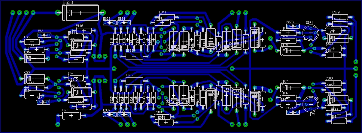

pcb line stage
hours I try to see if all the discrete components are readily available, otherwise it will be replaced or so it's very hard to accomplish
That's the original board layout 🙂
Biggest problem might be the axial electroylitics if you are keeping it original. There's a bit of scope for reworking the board slightly to accomodate radials in several locations. The layout as far as such things go isn't critical.

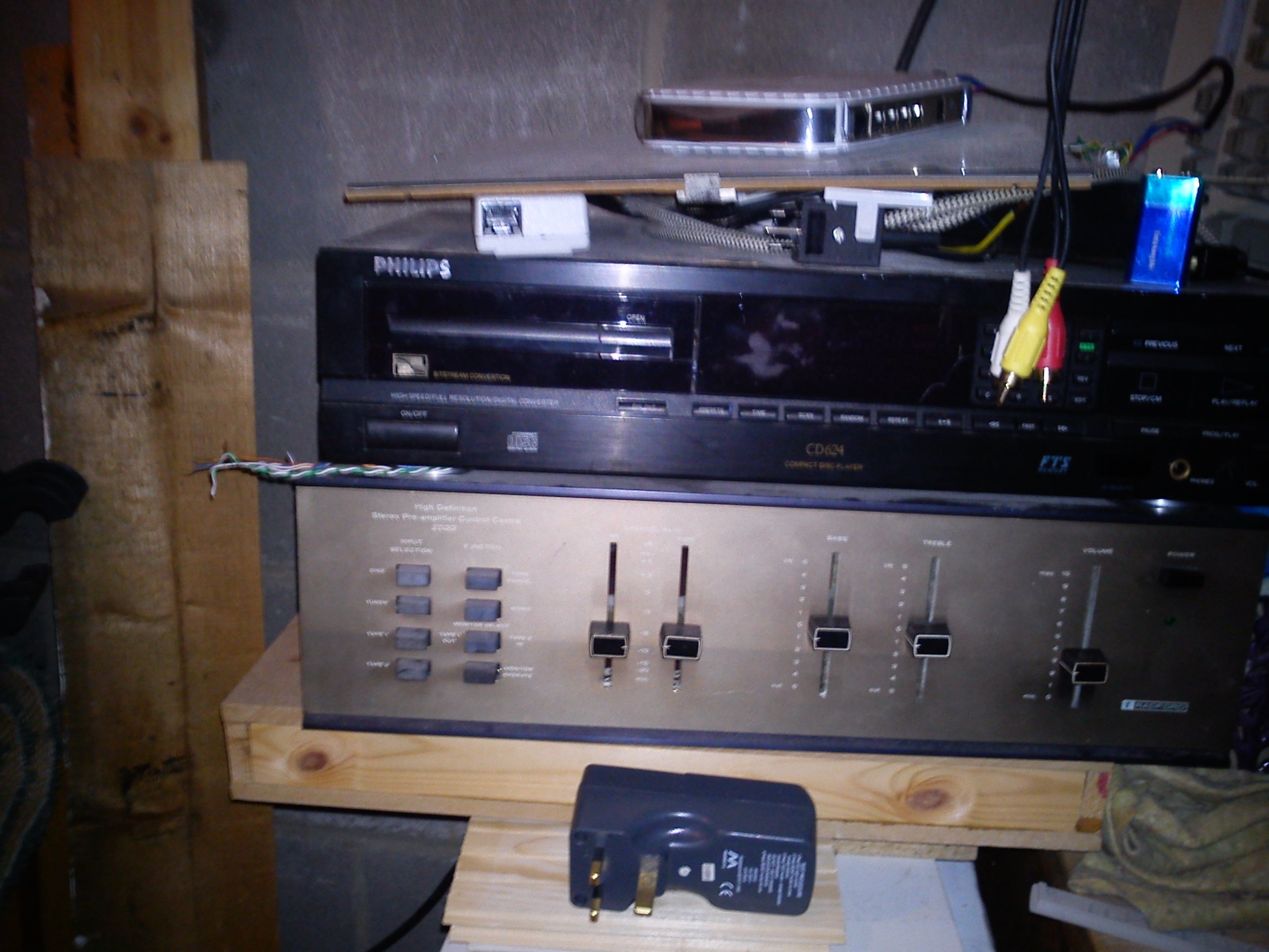

I have a modded ZD22/HD250 integrated amplifier in my garage. (It doesn't normally live in a garage, it's just we've moved relatively recently, and I haven't found a proper home for it yet).
It's modded, because the power stage (HD250 part?) was upgraded by my father years ago (actually, decades ago) with some Crimson Electrik boards, as far as I'm aware the preamp is unchanged though.
How does it sound? Well, very nice I think - although I have limited frame of reference. I've not really compared it to much. It's faired very well against a friend's audiolab 8000 kit - although we were enjoying the music more than comparing kit (and possibly unfair/uncontrolled tests because we weren't keeping speakers constant).
Anyway, I feed it with a CD player and DAC, and listen on either LS3/5As or Mission 751s, and I'm very happy with it (admittedly, thats with the power stage, I can't swap the pre amp for something else to compare).

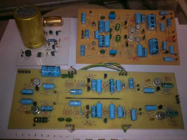

Hi, I try to build a clone of the preamplifier zd22 Radford, has anyone ever heard this?😕
I have already 'designed the master for printed circuits, but first I would like to hear some opinion.

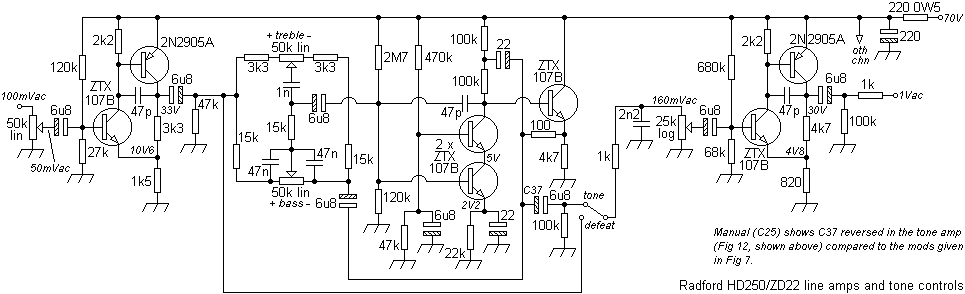

Maybe you already have it but I am attaching the schematics
http://www.acousticpsychos.com/Files/Radford-HD250-ZD22-int-sm.pdfhttp://www.acousticpsychos.com/Files/Radford-HD250-ZD22-int-sm.pdf
The line stage (fig. 12) by the way seems unecessarily overdesigned
There are 3 stages when just the first one (gain =3) should be more than enough
I like very much this stage
With a friend we tried to clone it ... just the stage called LINE INPUT AMPLIFIER
Of course we use a log pot instead of the linear one
I liked the sound much more than how my friend liked it

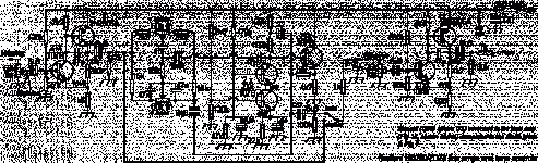

yes when it is in circuit it is inverting,thats the problem.i would like the output signal with tone control included to be in phase with the input. i could add an opamp based inverting stage but i would like to use only bjts thats why i asked for an inverting buffer
