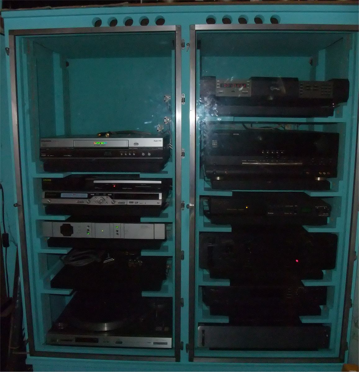

Here we go with a few pics... First up the whole rack, there are certain components missing (Pioneer CTF950 cassette deck for one). No DVD player either (Denon dvd 2930). Blu ray player will go in to shortly...I'm in love with the Krell DT10 top right

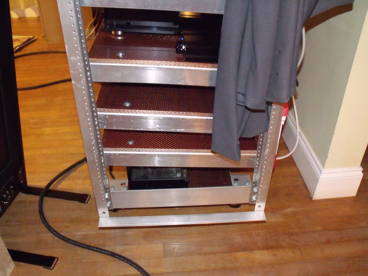

It was a bit of a PITA to build this rack, the shelves were easy though simply because i made a jig to make them all exactly the same. All the shelves can slide up & down the rack & be locked into position so any size of front end component can be fitted in, that is unless it's over 19" wide 😀 Excuse the dust, just shows how long it has been since the cassette deck was in there 😉

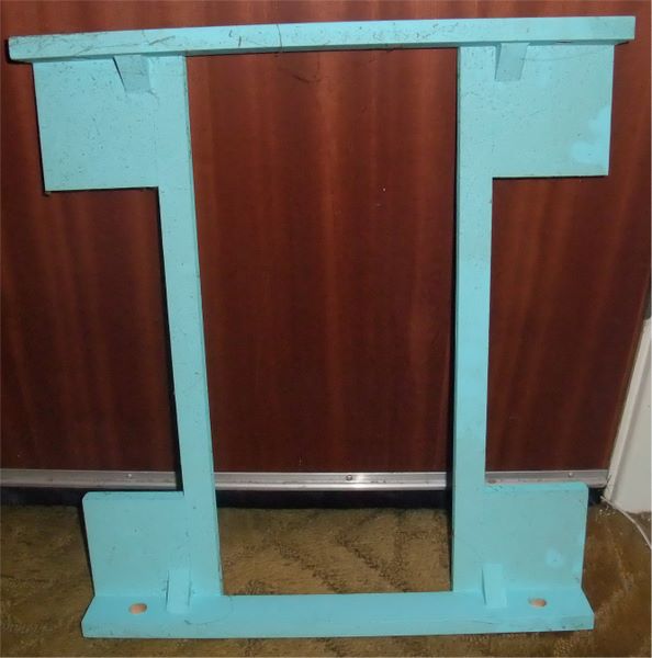

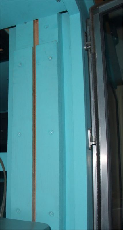

Here we have the central front shelf support. I happened to have a load of cross threaded bolts with square nuts so i simply made a channel that the nuts could slide in & another layer of MDF so they'd clamp tight. Works very well.
All the shelves get fitted from the top & then slide down to where i want them to be & then bolted in place.

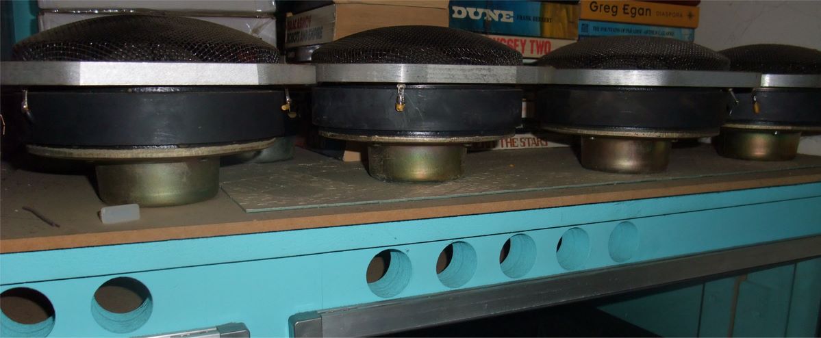

On each shelf there is a rather large & heavy what i assume to be concrete slab which has been painted to make it look a tad better. These are 18" by 18" & are standard fare from a garden centre. To decouple the slab fom the shelves there are 4 x 1/2" thick felt feet, one in each corner.
I don't tend to use a record deck very often, hense the thing is at the bottom. Just to aid my loading of records i added a 12" fluorescent tube just above it. This is switched on when the power switch on the record deck is turned on, makes sense to me lol. You can also see the air intakes of the rack. These will eventually be covered with some kind of speaker grill cloth to prevent dust ingress.
When things get warm we have some fan cooling, these are very quiet though as they are channeled from the middle of the rack to the outside & back again front & back.
Lastly the air outputs of the rack, the same is also on the rear of the rack itself. You might notice 4 of Yamahas finest beryllium midrange units that are going to be used in a speaker project hopefully coming soon 🙂
The whole thing ends up sealed and i'm using a load of secondary double glazing to seal up the front of it. Works very well indeed, it might have been a PITA to make but the result was better than i expected. Not only does my equipment stay cleaner for longer, it also sounds better due to less vibration 😉
That's it for now, just thought i'd share a bit...

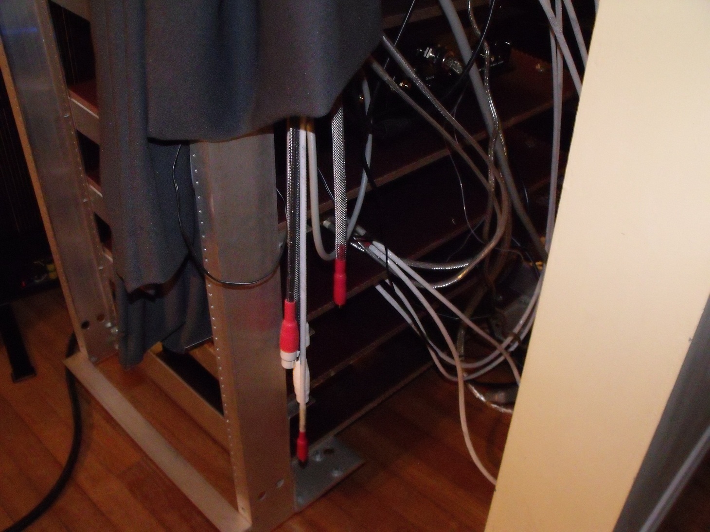

One thing i didn't mention is the real PITA of moving or removing anything 😱 Simply put each shelf & component above what i want to change needs to be disconnected & removed to get to the connections at the back of whatever it is that's being moved or changed.
I wish i had thought about that earlier, but as it is it doesn't happen very often thankfully 🙂 The thing is it does exactly what i wanted it to do, so i can put up with some quirkiness.

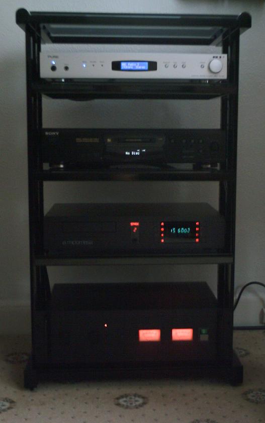

Hi there being an Acoustat fan since the early 80s my friend rebuilt a pair of 1+1s for me and a small but heavy audio rack that i named my Acoustat rack the only thing that's from Acoustat on that rack is a metal sticker that say's Acoustat here are a few pictures.
Work Almost Done
Finished Product

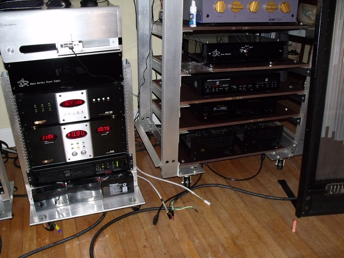

A Friends Bigger Rack

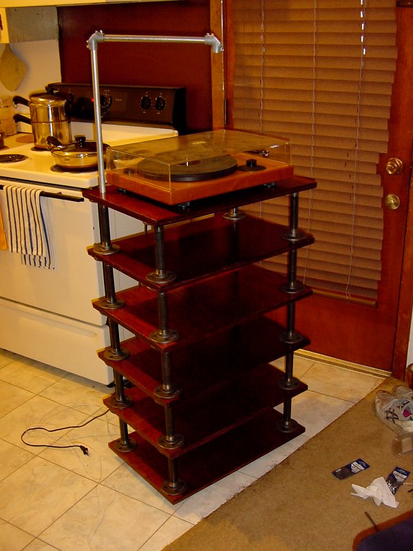

I was wondering if there was a thread like this! I figured that with all the DIYers around here that we weren't all just building electronic stuff.
Speaking of cast iron pipes, I've taken quite a liking to building various pieces of furniture using steel pipes. In combination with floor flanges, they are incredibly strong. I've built speaker stands, a coffee table, and a CD/DVD/BD rack using those pipes.

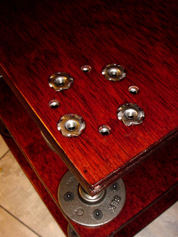

Now I just recently completed my equipment rack. I've been meaning to build it for several years. It's very sturdy and weighs 65 pounds!

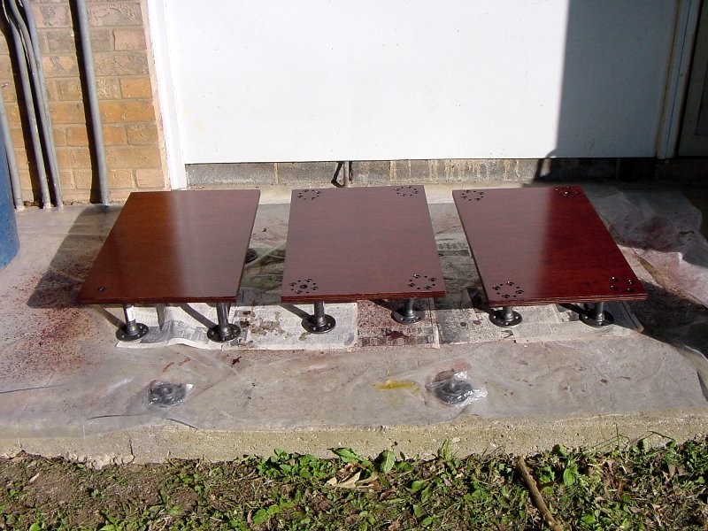

Materials:
This is the first time I had attempted to do a wood finish like this. It turned out pretty well. There are a bunch of tiny air bubbles in the poly finish, but overall it's pretty smooth.
The feet are 3/8"-16 carriage bolts. They are adjustable so that I can make the plinth of my turntable balanced. They screw into the bottom shelf via T-nuts and lock in place with hex nuts.
The 1/2" electrical conduit serves as an adjustable mounting for the white LED that illuminates the turntable. The conduit fits down inside the steel pipes. Both height and rotation are adjustable. Two 1/4" lag screws hold the conduit in place. The wire to the LED emerges inconspicuously out of the bottom shelf.
It was quite an adventure getting all 144 T-nuts in place. I could have had the screws go directly from one flange to the other, but I decided to screw directly into the wood instead. Wood screws probably wouldn't have been strong enough so I used machine screws and T-nuts. The holes for the T-nuts were sunk into the wood a little using a 3/4" Forstner bit. I used a hex bolt and a couple of flat washers to pull the T-nuts into the wood. Needless to say that by the time I got all of the T-nuts in, the head of the hex bolt was stripped and the washers were thoroughly flattened!

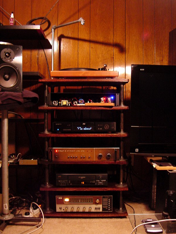

In case anyone is wondering, here's the equipment on the rack in the first picture (from top to bottom):
- Pro-ject 2.9 Wood with Shure V15vxmr
- a hybrid tube/solid-state phono preamp that I've been working on for years
- Oppo BDP-83SE
- Crown Straight Line One (being used as a source selector for front left/right channels
- a cheap JVC VHS VCR (being used as a clock)
- Fisher 250 receiver (one channel being used to drive a sub)
- off to the right:
- Panasonic Viera 37LZ800 1080p LCD TV
- (2) Otari MX5050BII-2 tape decks (being use as a stand for the TV)
- off to the left:
- NHT SuperOne (1 of 5)
- on shelf below NHT: a 5.1 surround preamp on a breadboard (an impressive mess of wires). This will eventually be a 7.1 analog (digitally-controlled) preamp. Lots and lots of relays will be involved.
- just out of frame:
- (3) LM3886 monoblock amps for the front channels
- a stereo LM1875 amp for the rear channels

I like these Network server equipment racks. You need 1 set to complete a rack. You can check on ebay I think or google. All aluminum. I use aluminum angle brackets to connect the shelves onto the racks. The nice thing is that it is extremely flexible when choosing hight between racks...and you can even angle your shelves anyway you want (see pic). The screws/bolts/nuts needed come with the racks.
