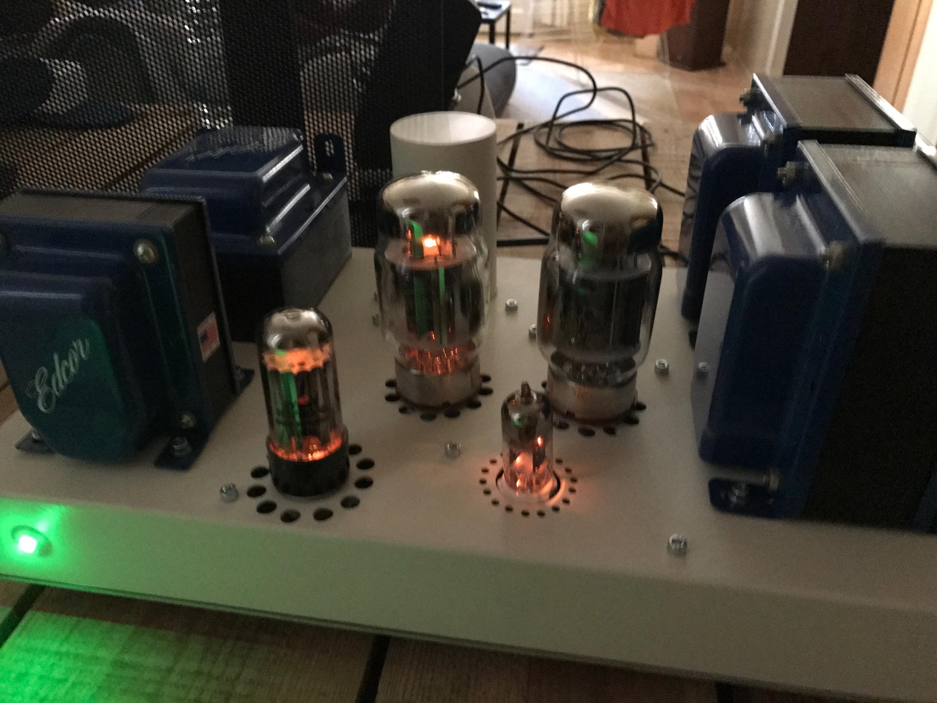

Something horrible happened... after two years of work, I managed to finish my sse. Everything checked, apparently everything ok.. when I turn on, check light turns on and valves start to glow. After, let's say 15 seconds, R2 burns with fire. I will post some pics later (but there is actually not more to see than what's described). R2 was 150ohm 3w 5% axial (23J150E-ND). My questions:
1- what can cause r2 to burn?
2- I have desoldered r2, will just replacing r2 work?
3- what should I check?
4- should I start a brand new pic?
Thanks and best regards!!

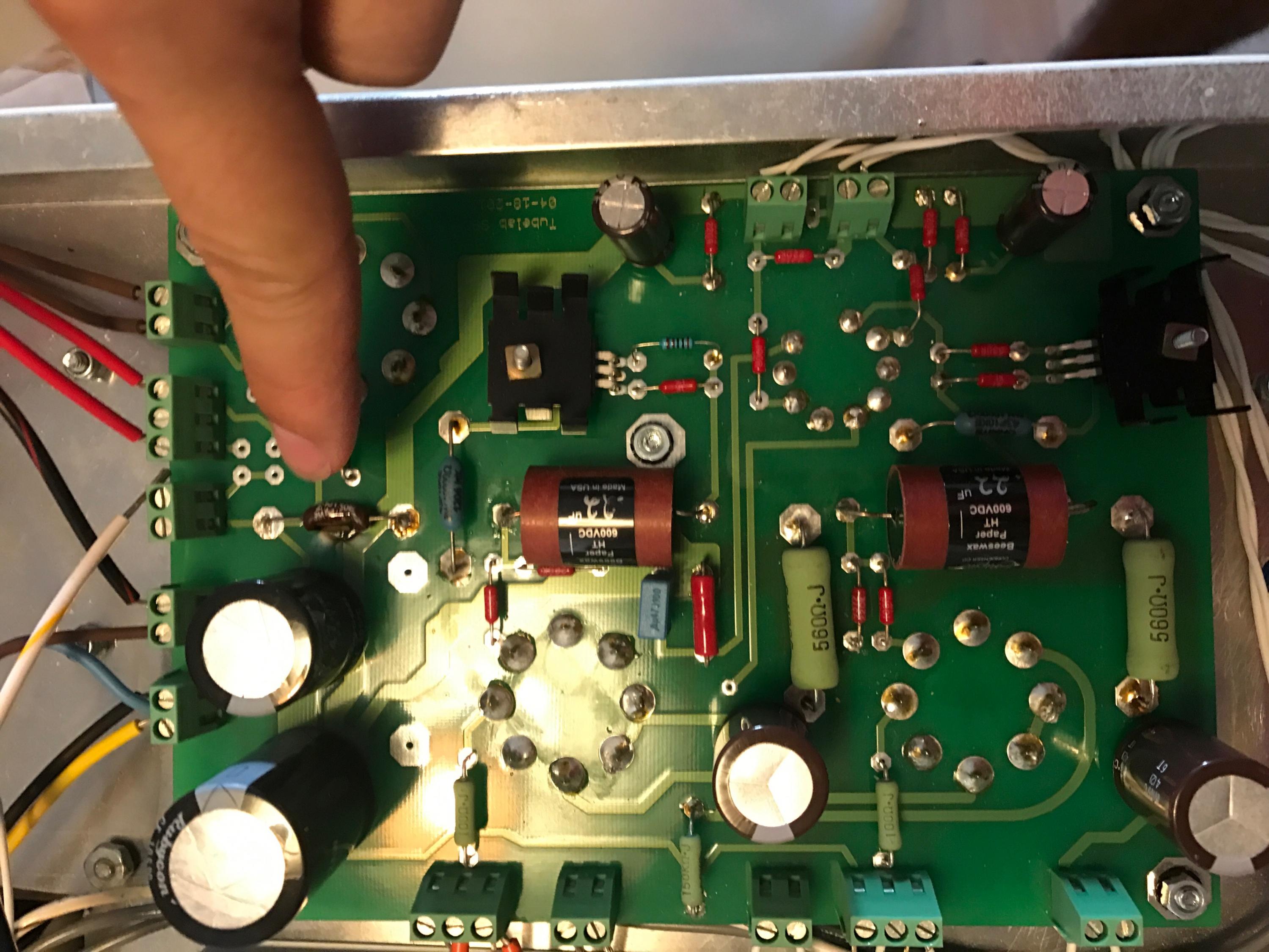

Hi, thanks for quick reply. Find attached photos. What do you mean exactly with schematics, what should I post? I have configured like that: [http://www.tubelab.com/images/AssemblyManualSimpleSE/Wiring/SSE_hookup_choke_triode_noCFB.jpg]

I'm not trying to be a wise guy but some of those solder joints are in serious need of attention. I would double check everything.
Sure! Thanks! How could you check them? And if they're not good? Desolder and solder again?

I see lots of too long cable all over the place, some of it with free ends.
As of soldering, it´s really hard to solder well with mandatory lead free type, can´t you get a little old style one somewhere?
A tiny bit of it added to each already soldered junction will make it way more reliable.

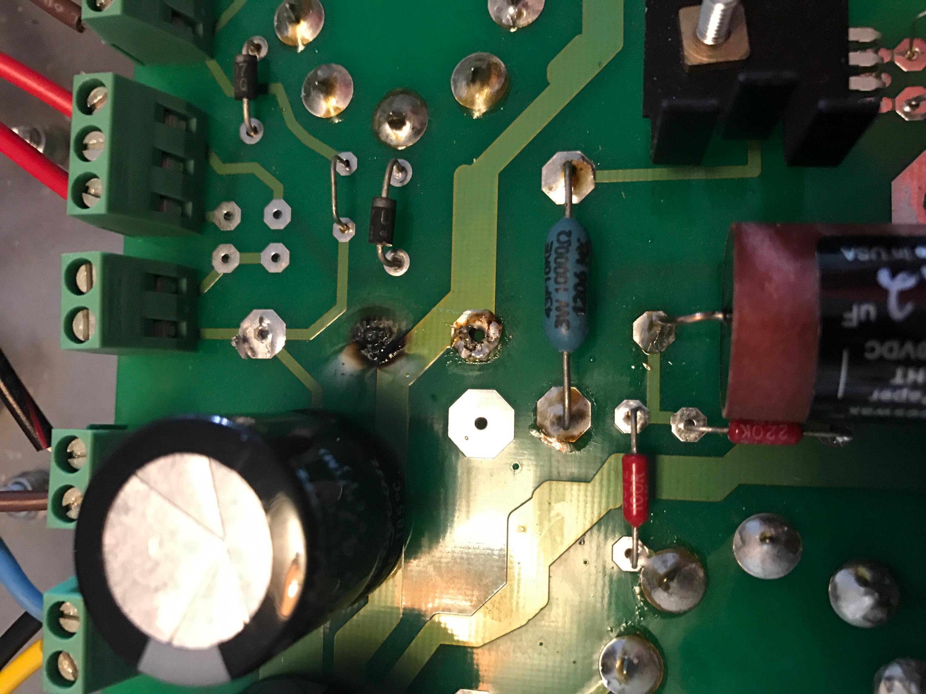

R2 should be 150K not 150 ohm. if it was 150 it tried to dissipate almost 1000w

R2 is a bleeder resistor for the 1st filter cap, it has the full raw B+ across. It needs to be 150k.

Yes, R2 is the wrong value and would fry in a flash. It needs to be a 150 K ohm 3 watt part. R4 must also be 150 K ohm or there will be more bad parts.
It is possible that the rectifier tube got damaged by attempting to pass 3 amps or so of current.

I doubt it. R2 would have instantly vaporized, or the fuse should have blown. If you are on US power the fuse should be 2 amps, 1 amp on 240 volt power.

Hi! thanks for the explanation. I don't know how could I make a 10^3 ohm mistake..... I checked values 10 times, looks like it was not enough. Anyway, happy to know where the problem is.
Regarding to the fuse, it has blown.. I was trying with 1A first and it blew, then put a 2A and there I got some second of work before R2 blew. I'm using 230V power (europe) so I should go for 1A? can I try higher values (maybe 1,5 or 2A) in case it blows?
