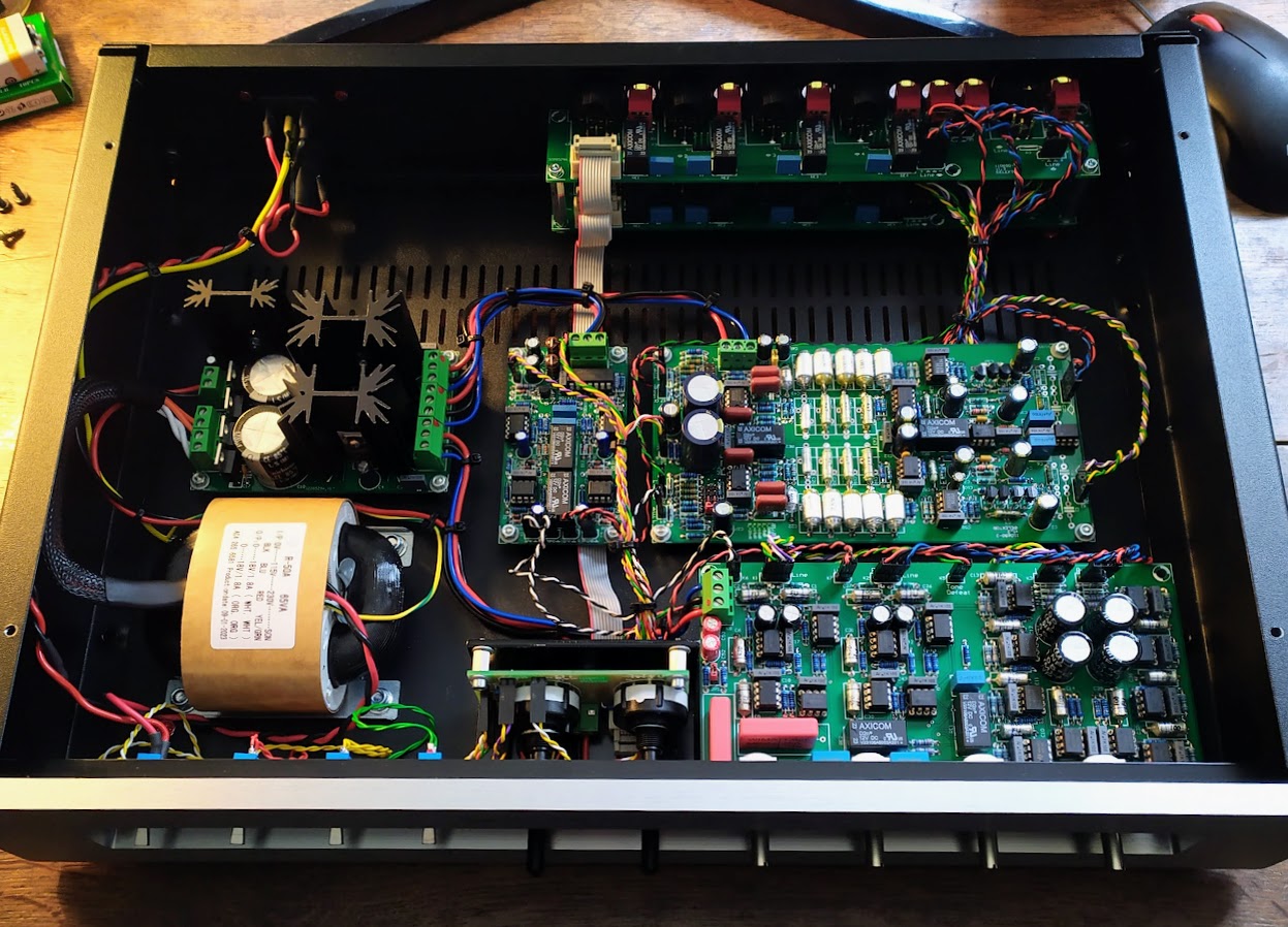

I’m looking at an R core I used for a dac I built and I believe that yellow/green is a ground wire. The N is neutral but also is tied to the ground buss. Don’t wish to mislead you so let’s see what others think
Yellow/Green is for AC line ground (presumably its for some sort of shielding in the transformer). Neutral is only connected to ground (in the US anyway) in two places: Where the power comes into the building, and at the power distribution transformer on the telephone/power pole. In both of those places there is also a ground rod connected to neutral and ground.
Thanks guys. Earth ground it is.

The yellow-green wire is going to the electrostatic screen. It shall be connected to chassis ground. Example in the preamp I built.

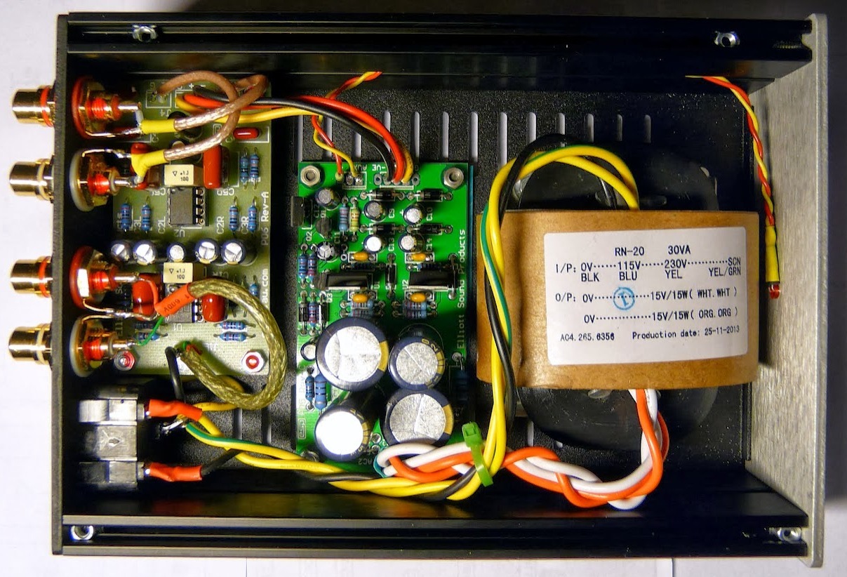

Sometimes the transformer has a label with wires destination (here in a phono preamp I built years ago) ...
Thank you. I'll connect it to the chassis and the earth ground on the IEC socket.
