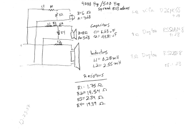

Thanks! Okay, suppose I bought a Dayton RS225S-8 (8 ohm) with a 88 dB sensitivity. I need to bring down the tweeter & midrange 3 dB with l-pad circuits?
Without baffle step correction (need more research on that), here's what I came up with (1st order, 500/4000 Hz).

I would recommend picking some drivers and first doing a design using the free FRC tools. This is a good way to do a design "on paper".
Here is a quick outline:
1. Trace the mfg. freq. curves and impedance curves.
2. Use Unibox to determine the low-freq. output.
3. Use BSC to determine the baffle loss response. (By the way, you loss -6 dB when the freq. wavelength is wider then your baffle - in simple terms).
4. Use Freq. Response Combiner to combine all of the freq's into one.
5. Extract the proper phase.
6. Then use the crossover designer to design a crossover. (You will need a more complicated X-Over the 1st order I think).
When you get to item #6, people can help and point you in the correct direction. And give some guideness on the necessary steps. I am no crossover pro by any means. When you get to #6, post you results (w/o crossover) and then we can stay adding X-Over parts to see what is needed.

Here's the frequency response I have in Speaker Workshop so far:
& here's the XOver:
I chose the RS225S-8 for the woofer. There's no ported box model combined with the woofer's fequencies.
Is the crossover too complicated?
Okay, the impedance trace was off & here are the further adjustments:
Modeled frequency in Speaker Workshop with the added ported box:
Impedance:
Revised crossover:
Any further help would be appreciated 😀

Your crossover does not address the cone breakup of the RS52. Try adding an inductor after, and in series with, the lowpass capacitor. Make it a really small value, then adjust it down, until you notch out the 12khz resonance peak.
How are your reverse nulls? If you flip the polarity on the RS52, do both the highpass and lowpass crossovers give you a nice null at the listening axis?
What does your vertical polar response look like?
Have you factored baffle diffraction effects into your design?

I didn't like any of the designs I saw on the web so I came up with this & I went ahead with this idea or I would regret not building my own speakers! I'm actually tired of looking at the same ol' speaker enclosure designs . . .
The inductors theoretically didn't work.
There's was a lot of dips at the xover points in the Speaker Workshop sim when the mid was not flipped.
I have no idea how to simulate that or test it.
Yep.

Besides, my limited experience with woodworking and painting didn't stop me from making a solid enclosure. I've been running the finished one through its paces with the Yamaha drivers and so far it's superior than the original Yamaha box (the bass port, semi-time aligned, and non-parallel sides make a gigantic difference). I think DIYers would cringe at the enclosure Yamaha put together (1/2" mdf with minimal bracing) That thing resonates and rattles big time around 200 Hz.
And there's plenty of resources online to get the 3-way passive crossover working well. I damned determined to get this right.
dublin78 said:
As others have pointed out, designing a passive XO for this will be nearly impossible for someone of your experience (mine too), so I would suggest that you go active, using something like a Behringer DCX2496 (cheapish).
I believe that with your PA experience, you will be able to better a passive XO as there will be no components to interfer with the drivers' optimum performance. You will need two extra amps though.
Nice cab design.
Good luck
Okay, you talked me into it! I found a Peavey PV 35XO for $150. It was a pain to go to an active xover because I am using my existing AV receiver & a Griffin Powerwave to power the speakers. And I'm using my bass port for the extra wires. I may add more terminal plates eventually.
Luckily my receiver accepts multiple inputs (6) except the outputs are configured for a 5.1 setup. So I used my Griffin Powerwave's speaker breakout to power my woofers. It works great except I lost my surround sound. I can regain it with some active monitor speakers since I have six free outputs on my FW interface.
You're right, it would have been impossible for me to design a passive xover since I don't have any local connections to try the designs out first. It is a little tricky to find the right balance with an active xover. Now I know it would have been impossible trying out a passive design! Another plus is finding the weaknesses of the drivers. You can turn off any of the drivers & just listen to one by itself. I do need to upgrade the drivers! I was wrong about the HiVi F8, BTW. The diameter is too big. I think I'll try out the HiVi M8N but I think I'll find a midrange that can have a lower crossover point. Maybe a full range driver around 4" or 4 1/2"? Tangband or Fostex seems to be popular.
Currently I have the xover points around 225 Hz and 1700 Hz for the Yamahas (seems like a happy medium so far). They'll probably distort at higher listening levels but I rarely listen to music above 83 dB which is the recommended listening levels for mixing & editing:

I'm not sure I want to go back to passive! These speakers are getting closer to the way I want them to sound.
Will this thread eventually have another page? This is too graphic intensive . . .
Congratulations.
You will doubtlessly save money in the long run, as you will not purchase incorrect XO components, also you will be able to use the active crossover on many projects in the future.
If you think about it, putting inductors, resistors and caps in a signal path cannot be ideal. An amplifier per driver makes sense too.
Keep an eye out for a secondhand DCX2946. It does all this and more within the digital domain and acts as a decent DAC too. It can be made into a fairly high-end DAC with a few mods.
