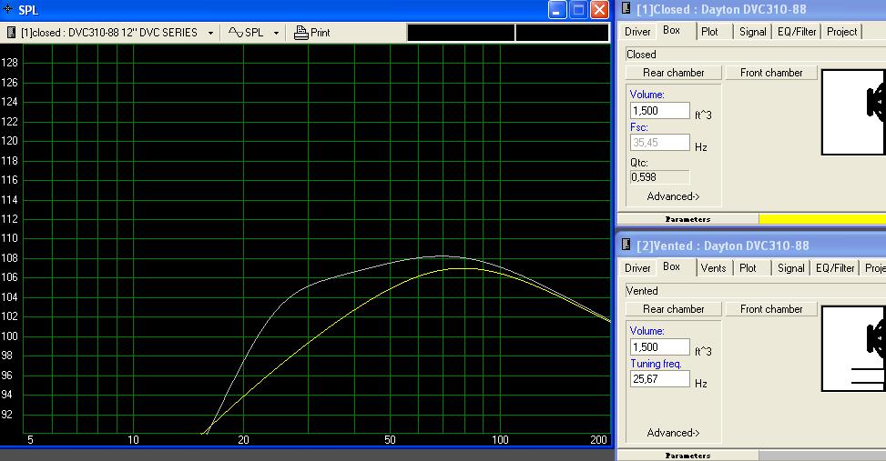

Here's the FR curve at 300W ported vs. sealed for your 1.5 cu.ft enclosure.
I optimized the tuning of the ported enclosure to give flat response down to a in-room F3 of about 22-23 Hz.

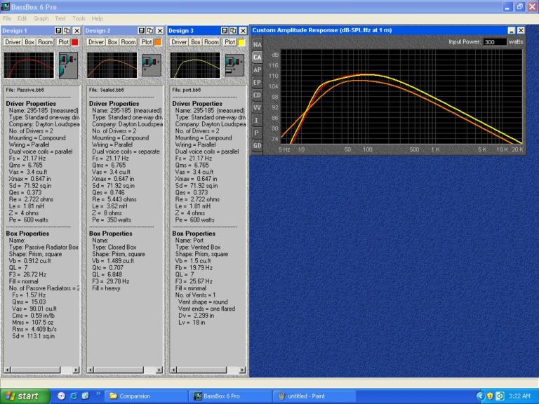

The test
I have completed some tests regarding sealed, ported and passive radiator and I am thinking know at this point I have come down to using one of 2 and I was able to make one box size to real world test both. I can make one internal size box @ 12.5 X 12.5 X 17.8 box to do my testing as this should be a good base size the loudspeakers I intend to build them into. It would seem that the seal individual VC box will be my first choice and the then PR. I just need a bit more help as to how to place my drivers, down firing front, side or whatever also the best placement for the PR’s ? I would like any input that you all may have on which the PR or the SB would be most effective to make good tight bass. These will be used mostly for Rock type music and secondly for the subs for my home theater. Home theater would be least important. Here are my last simulations.
