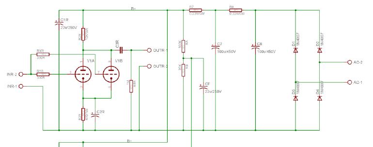

Well I have a fully populated Aikido, power supply board with rectifier tube, and both transformers. Also the pair of 6N1P and 5687 too.
I also have a very nice condition Adcom GTP-740 preamp that has issues (keeps re-booting, thought I fixed it but problem keeps returning).
I was looking at the Adcom the other day and realized I could rip out the preamp guts and keep the power supply and remote control volume pot. Drop in the Aikido with its power supply board and tranformers...maybe drop in a nice DAC too...I may be able to take a 6 volt DC from the Adcom power supply to feed the 6NP1 and 5687 heaters....
Hmmm, I have been putting off the Aikido for over a year now...maybe a good time to pick it back up...

john65b said:Well I have a fully populated Aikido, power supply board with rectifier tube, and both transformers. Also the pair of 6N1P and 5687 too.
Sounds like a good plan.. I would recommend though that you include a filament and high voltage supply in the Adcom pre-amp box, that way if someday you want to use it with another power amplifier (hopefully a tube one.. 🙂 ) it will simply be a matter of moving a few audio cables. Power supply capacity and potential ground loops are other issues you might encounter stealing power from the amp..
