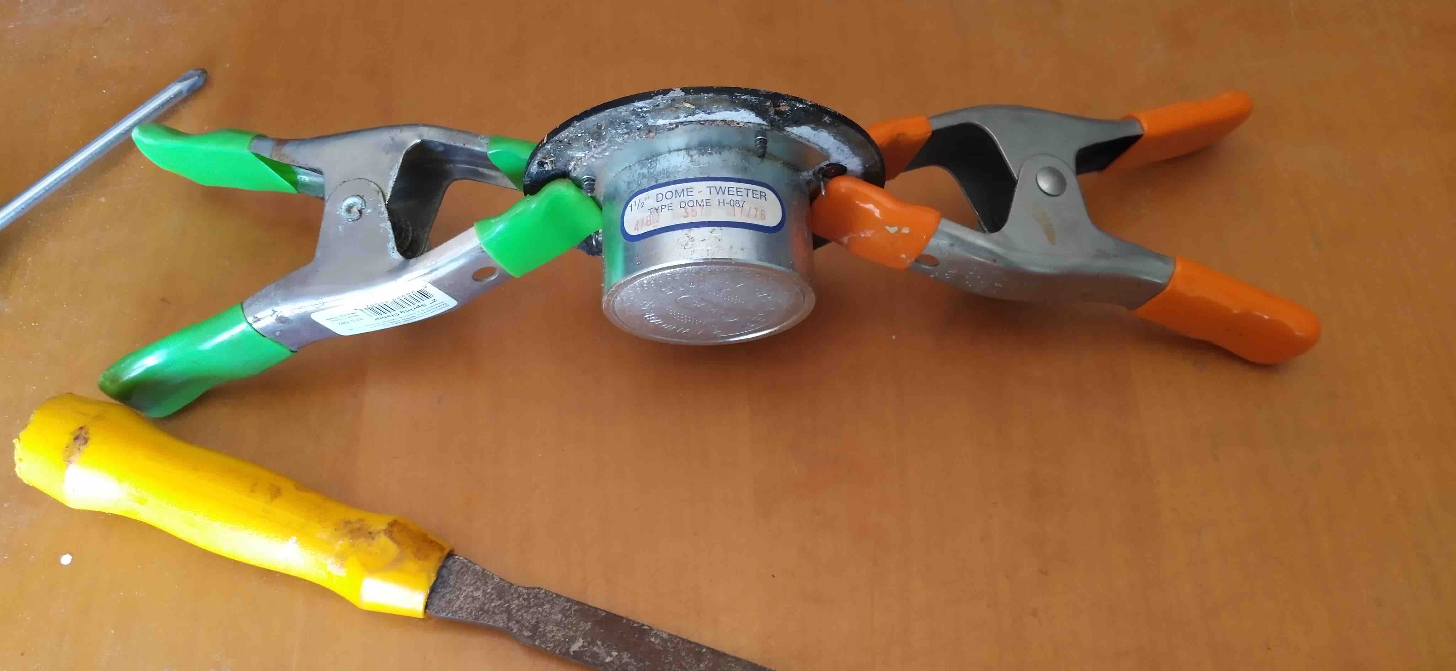

Well not that easy. For future tweakers: besides the Dynaco snot all over the tweeter and the years of galvanic corrosion right along the seam, the magnet case and dome parts are stuck together with a double stick tape gasket. It'll only come a part with a nice sharp 1/2" wood chisel and hammer, carefully tapping and moving around the seam. I used two strong spring clamps on either side to hold the tweeter steady and upright along the edge and left the grill in place but the screws loosed a turn to keep it from flying apart once the halves separated.
Pretty scary first time you try it and have no idea what will happen. Once it cracks apart remove the screws and grill then carefully to pull the dome/coil straight up to not nick the bobbin. Use a mat knife to cut back any the double sided tape that resists as you lift the dome away.

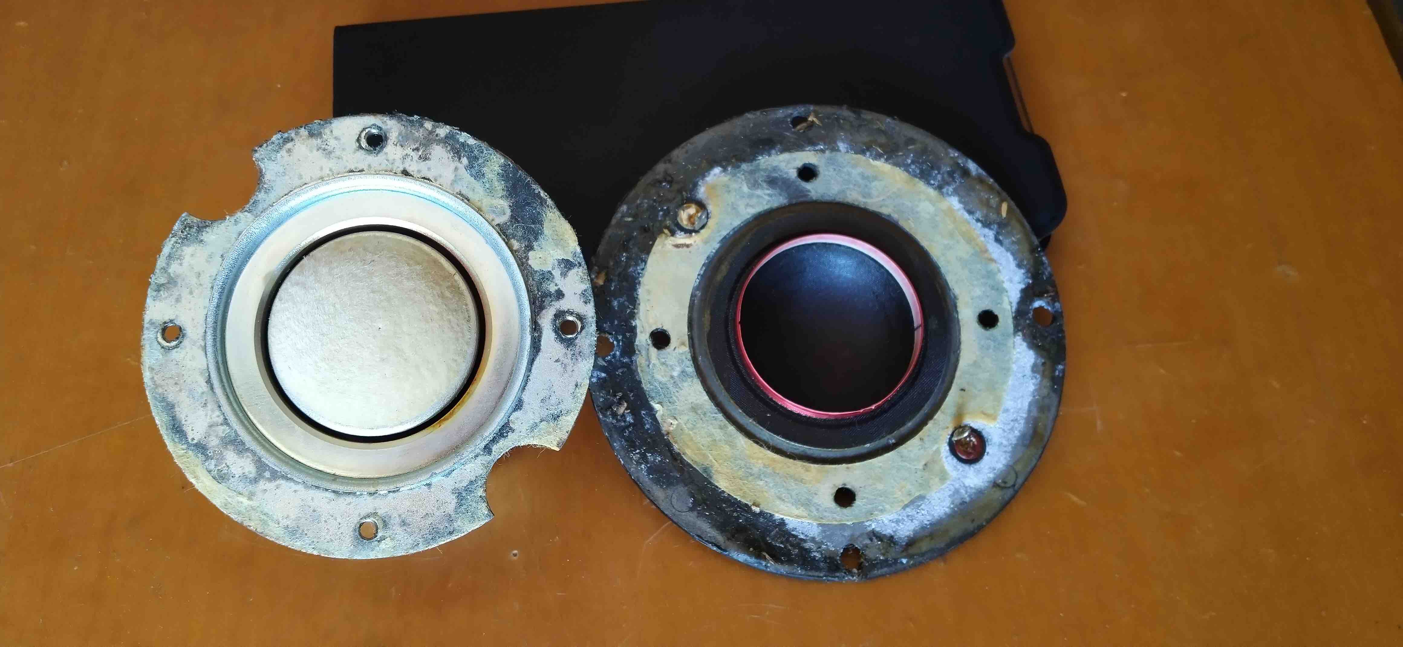

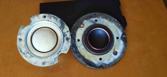

Here's the good part, I tested the dome/coil once it was apart and I got continuity and about .4 ohms resistance which I believe is correct. Put it back together and still got continuity 🙂 but WTF. Gotta love electronics, it's almost like these things are organic and alive. The other one still in the speaker decided to play again after I showed I cared. Maybe they were both under the weather and are now feeling better. Now I have a spare. Glad I asked and didn't just hunt and pay for another off Ebay. I'll try and post some picts on what it looks like apart for anyone else trying this.
Yup, shorted. I figured the voice coil might read like a transformer winding with a different reading for the impedance rating and resistance on a meter, but yes it should read around 5 ohms. I thought continuity was a good sign but it is obviously shorted across the windings. Pity the alnico section goes into the trash. Have to get my all vacuum tube time machine finished so I can order up a new voice coil.
Here's some picts for some future explorers. Oh and don't set the dome side downwards touching anything, like a table, whether it was always sticky or the coating got that way over the years, it'll stick hard enough to the table to freak you out if your voice coil is good, on a hot summer's day anyways.
