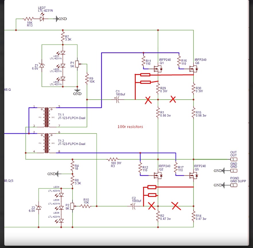

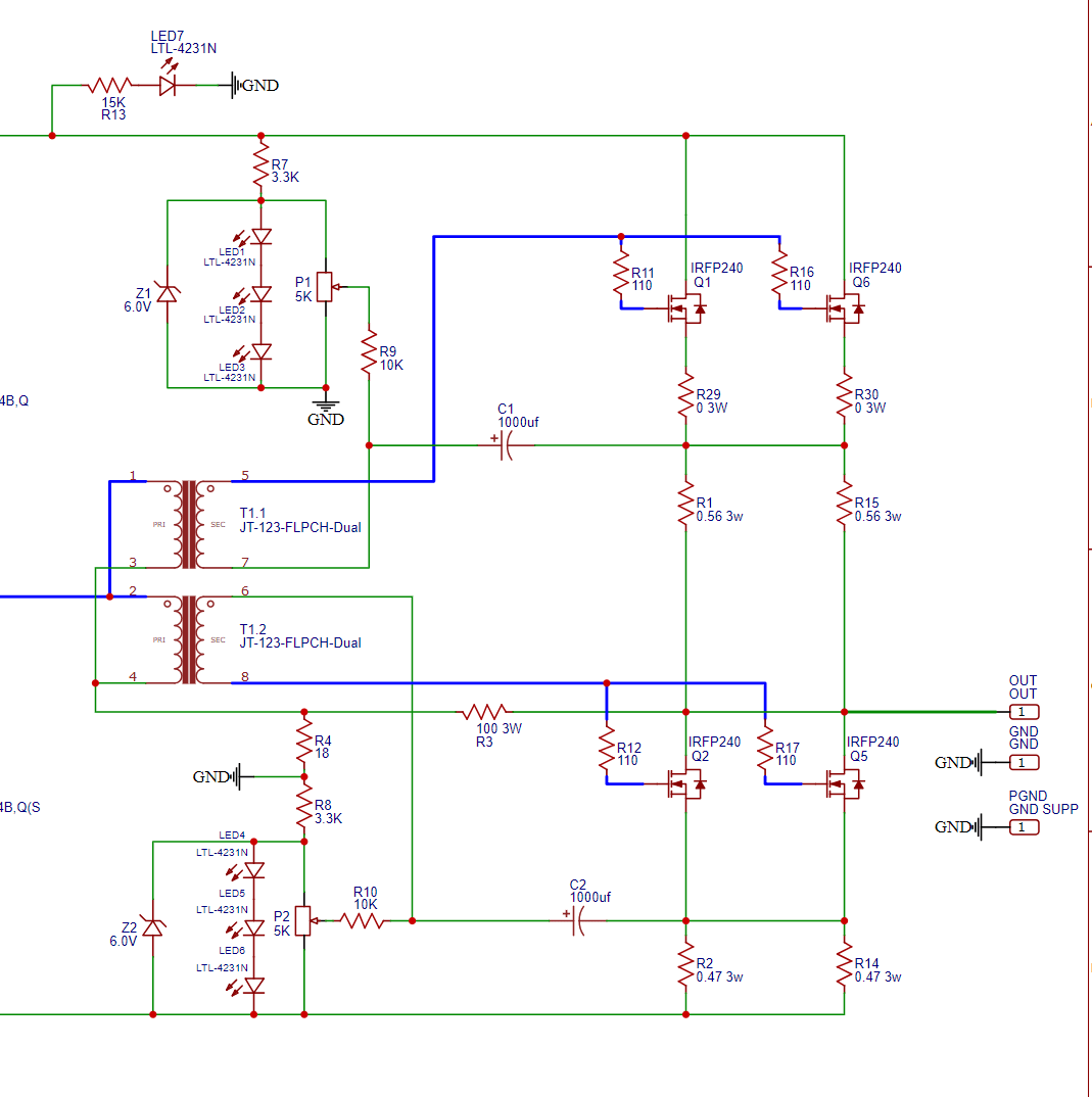

I do have a questions for anyone who may know the answer... ☝️... Does this look like it will work? Basically a F6 but with paralleled output devices as well as a couple of other tweaks. Maybe with some higher voltage rails... Say 30vdc.
the Magnepans being low impedance like lower ps voltage and high bias current.F5 with 32v power supplies is probably your best bet for Magnapans.
As for paralleling the devices I think you will want something like in the below attachement.

F6: Cool, that trace was the part that I was wondering about. Back to the drawing board
