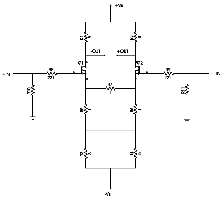

Yes I'm puzzled:
As far as I can see the CCS in Son of Zen is not used as loading element.
I think it's there as a CCS to provide constant Ids to minimize distortion.
I think it's there, and should be there regardless of whether the PSU is regulated because an active gain stage doesn't present a constant impedance to the PSU.

1. constant voltage applied to an active device will not necessarily result in constant current through that device ?
2. constant Ids reduces the distortion from in an active device ?
3. device gain is dependent upon Ids and Vds ?
Yes.
Probably.
Yes.
...As far as I can see the CCS in Son of Zen is not used as loading element....
I do not see a CCS in Son Of Zen.
PassDiy Son of Zen
https://www.passdiy.com/download.php?download_file=/images/uploads/project/sonofzen.pdf
