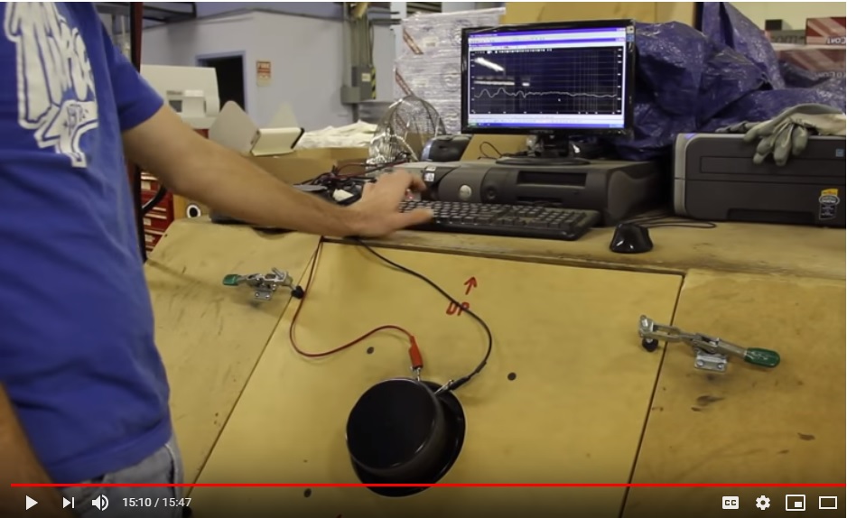

can anyone recommend quick locking and unlocking type of clamps that I can use to test mount speakers to a box, without having to actually use screws every time?
This is for doing a sweep on various drivers that will all be mounted to a 24x24 baffle panel. These panels would need to be easily mounted to a test box, to have a good seal, and to test their parameters.

They are very much used in Industry, to strongly fix a piece you are working on, do your thing, and quickly replace a new one.
I use them in my rolling table saw, in a fixture to hold speaker panels while I apply grill cloth with a pneumatic staple gun, etc.
Some industries, as in furniture, use multiple complex setups with pneumatically actuated clamps, same if you will TIG solder metal parts together.
In that case a single pneumatic valve connected to the air line opens/closes all of them at once.
VERY useful.
