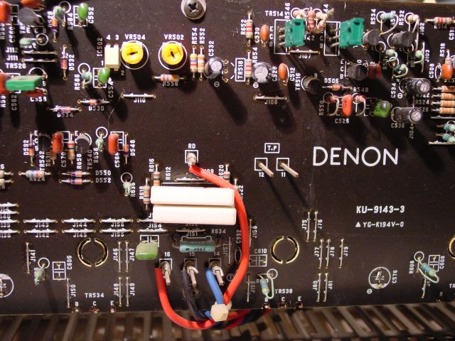

Missed my ol' Yammy full of Sankens, picked up a Denon for fun. Just noticed a slight temp difference between channels, thought it worth touching up.
Just wanted to know is someone has info on adjusting the bias (possibly ~K-amps?) Don't need the whole manual, just the bit about values, and what points to test. It's a bit of an odd layout on the boards (also multiple pots). There are a variety of test pins, so might be very easy if I knew they could be used.

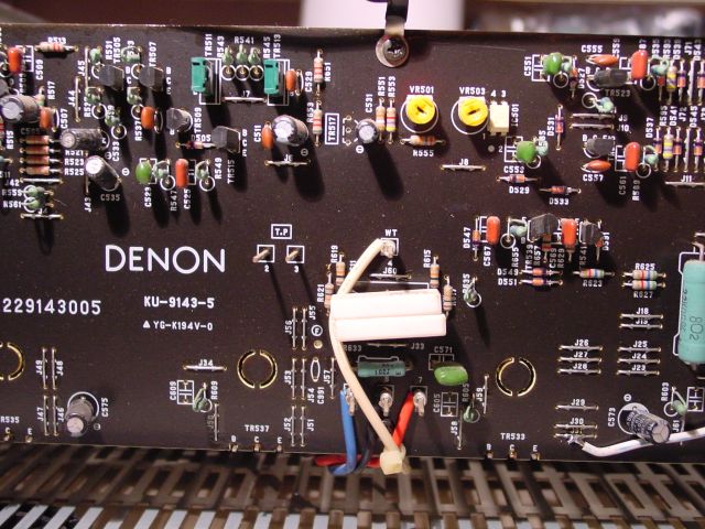

Unfortunately I don't have the service info for this model. What I can tell you is that the 2200 & 2400 units had adjustments for the bias and distortion factor. The DC offset you just measure at the speaker terminals with no signal. It should be within +/-100mv. There should be 2 pots along with a set of test points on each board (Left & Right); one pot is for the bias adj. and the other will be for the distortion factor. To check the bias, hook your DMM on the test points (I use aligator clips and slide the rubber boots over the pins to prevent any "accidents") and measure the DC. Your looking for 8mV +/-1mV. You need to have the amp warmed up for this test. If you let me know the pot numbers on each board (will be VRxxx) it might jog my memory on what pot adjust what and possibly take some pictures of the boards. Its either that or purchase the manual if noone else can help.
I'll pull it out right now and take notes and a picture. Back in a flash.

Left Bias: 15mv
Right Bias: 0mv (can't get a reading for some reason...., but doesn't float)
Have an idea which pot is Bias? ... I have no clue which is DF, nor what it even does...

This is a 2400 and not a 2400A(optical class A) version correct? Also, can u see any numbers on the actual pots? or just measure their resistance. IIRC from changing these out the bias pot is 10k. Memory is failing me at the moment sorry.

This is a 2400 (but has optical class-A printed on the front).
Will test pots w/o power and report shortly (and test)... I'm having a can't sleep Saturday night... Brain is ~~~*~ also....

Ok well I'm done for the night. All you have to do now is find out which is the "magic" pot and adjust for 8mV +/-1mV and you should be good.
Will do, and will post the results for all when I get them.
