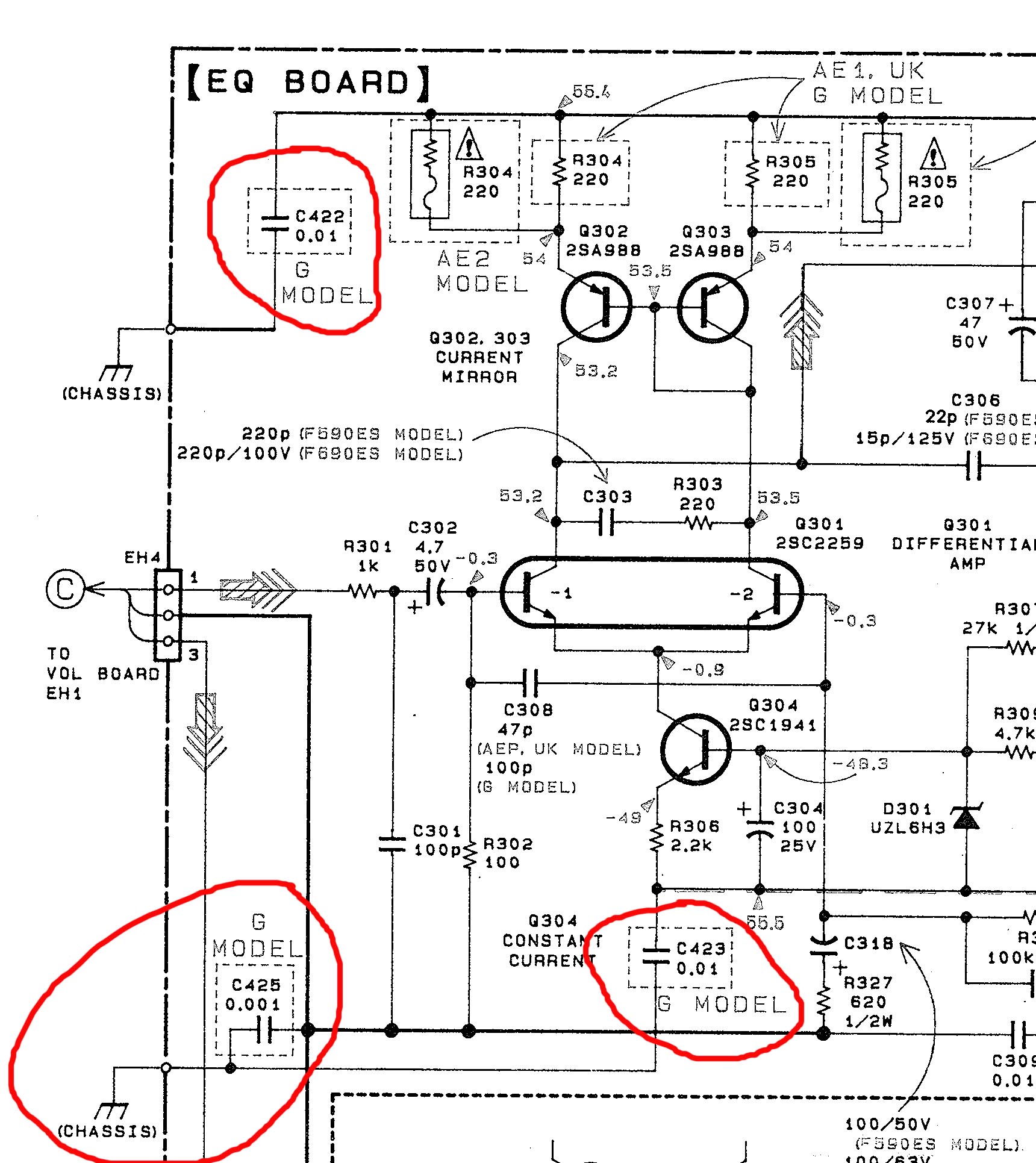

The RC are Zobel networks, for stability.
The C from supply or common nodes to chassis are
low inductance connections, maybe for stability also.
Well, then, why are they only available for the German market:смущенный:? And the rest of us don't need stability?🙂
