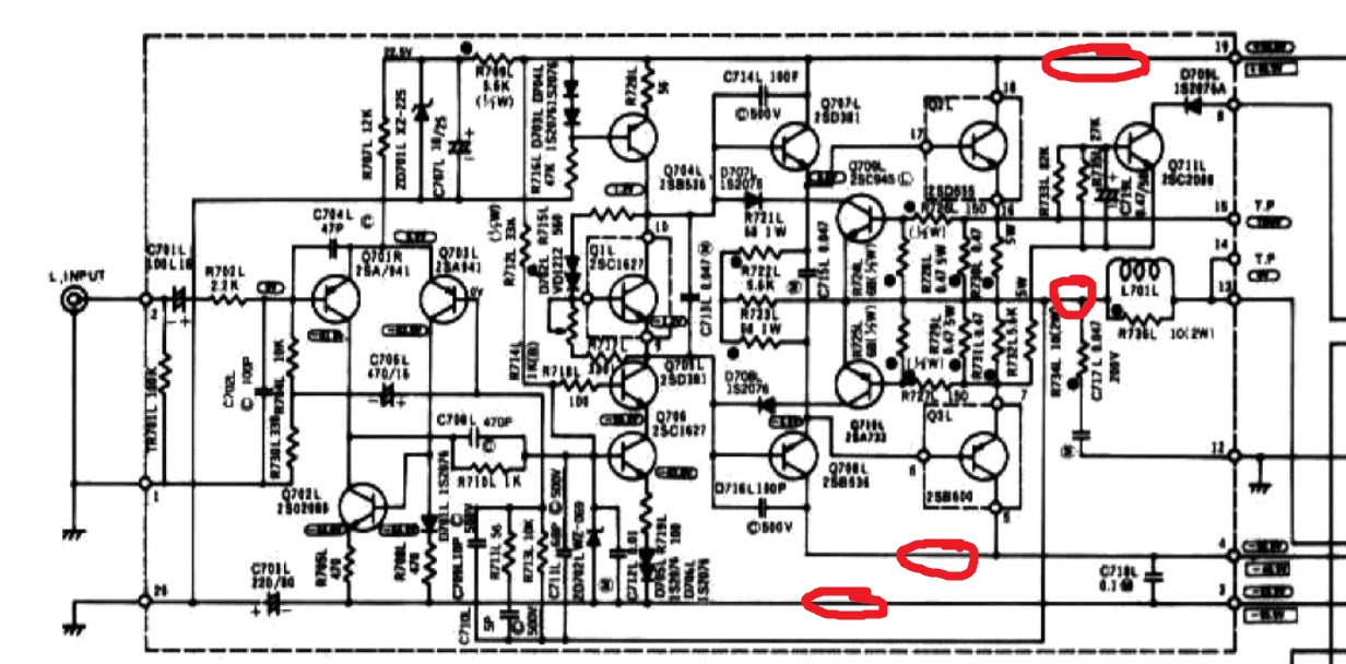

Long story short, a friend of mine gave me a Nikko Alpha II power amplifier that had a scratchy right channel. I figured it would be a great project to learn how to fix up an amplifier. Keep in mind that I have no formal education regarding electronics, and my knowledge of circuits is very, uh, rudimentary.
Here's what I've done to it so far:
Now, I've turned it on, and hooked it up to my speakers, and it produces music... that sounds like garbled ****. In particular, the midrange and lows mostly sound fine but the treble in both channels is severely clipped and warbled. I've tried this with two different sources, speakers, speaker wires... to the same result.
Interestingly, when I turn the amplifier off... it keeps playing music for maybe 10 seconds, WHICH SOUNDS MOSTLY FINE. The clipping (99%) is gone.
Any idea what I should be looking for? Are the new power caps too much, or did I mis-wire something... maybe something with the transistors again? (Also, if anyone has a website that could ELI5 transistor bias in an amplifier that would be deeply appreciated, most of what google produces goes way over my head). Would it be possible to replace the protection circuit board with something generic that isn't degrading?
Thanks in advance to any and all help!
- Replaced all capacitors on the power supply board and amplifier boards. Several of them on the amp boards were leaking, a couple had leaked quite a bit. I should note that the protection circuit board, the only other board in the amplifier, had already been serviced when I got it.
- Replaced all of the wiring on the main transistors (the ones attached to the heatsink) with jumpers, since the circuit boards they were mounted to were degrading and losing their connection (hence the scratchy left channel)
- Replaced the 4 power capacitors with caps of the same voltage rating and size, to make mounting the new ones into the chassis as easy as possible. The originals were 10,000 uF/63V, the new ones are 22,000 uF/63V.
- Replaced one capacitor on the protection circuit using jumpers, since it seems to be degrading in the same way as the transistor PCBs with the traces coming loose. (I should note that the amplifier and power supply boards are made of a different, higher quality material and are holding up just fine)

Sorry, I guess those things would help, huh? Unfortunately I haven't been able to find a schematic that's really readable, but here's the manual: Nikko Alpha II Manual - Stereo Power Amplifier - HiFi Engine
I think I remember reading this is a class A/B MOSFET amp.
OK, that's a fairly conventional A/B amp. Its not FET, just normal transistor output.
You need to begin by confirming the power supplies are correct and that the amplifier output has no DC offset present. There look to be three supplies to each channel, the expected -/+ rails and also an auxiliary negative rail to the input stages and voltage amplifier section. That appears to be floated off the main negative rail and so will add to the main voltage by around -10 volts or so.

Ok, so I'm bringing this post back from the dead because I've finally got the amplifier playing music once again. I found a couple issues: one being that I did a bad job at trying to solder three different wires to the capacitor leads and could measure some resistance across some of the connections, so I did a neater job of that which cleared some things up. I also realized that I had switched one of the transistor backs (I'm not entirely sure what this is called...it has two pins and plugs into the transistor with the heatsinks between them...) put in backwards on the right channel. After switching that, the amplifier is playing music without any distortion! Woohoo!
B+/- voltages are +/- 57.4V on each channel, so it's good that it's at least balanced, although I'm not sure what it SHOULD be. Also, the amp still keeps playing for a good 7-10 seconds after power off. Not sure if this is something to worry about or not. The protection PCB is not in great condition, but all the connections seem to be holding together. Mooly also mentioned an auxiliary negative rail, which I had forgotten about and so didn't measure the voltage on it, but given that everything seems working I'm not too terribly worried about it.
I would like to ensure that the transistors are properly biased, but again, not entirely sure how to set that or what an optimal setting would be. Again, no formal EE education, just reading stuff on the internet, so any help would be greatly appreciated.

I hooked up some alligator clips to the terminals listed in the service manual (TP 14 and TP 15) with my dmm on DCV. It says the voltage between those two should be 19+/-3 mV.
The amp went from about 4.3mV and started rising, so I assumed the amp was just warming up, but it went all the way up to 80+mV before one of the transistors (Q707, on the same channel as I was testing) caught fire. I assume I could try and replace the transistor, but who knows if those contacts/traces are still good or not, I could probably test them but I feel like this is more than likely the end of this amplifier.
So what did I do wrong? I should also mention that this is probably the first time I've had the amplifier on for that long...usually I would switch it on, test it, and switch it off after a minute or two.

Could be one of many things... you mentioned in post #1 redoing some flaky wiring to the heatsinks. Bias creeping up suggests the Vbe multiplier isn't doing its job and I see it appears to use one of those notorious double diode packages.
There will be more than just that burned (driver) transistor that is faulty. You are probably looking at replacing both drivers, both outputs and quite possible the VAS stage devices (those before the drivers) + a handful of damaged resistors.
Mooly Vbe multiplier in this machine might not operate correctly there is manufacturer error there .... mechanical issues
meaning the wise thing to do there is to replace the transistor from a TO92 thingy to TO126 or similar ...

Hi, I have a Nikko Alpha 2.... At first it wasn't working at all. I had it repaired by a Technician, and after receiving it I notice when I power it on The relay clicks right away, and when I turn it off it takes about 10 seconds for the relay to open back..... I had Connect 1 8Ohms Speaker to the left Channel.... and notice the amp getting really hot...after a while that channel burn the same happened with the right.... I had open it my self and replace the fuse and some resistors and transistor( a733 )... when I power the amp back on the Decibels Needles are peaking without any gain and there's a slight output volts on the speaker terminal ( 14volts )
I don't Know what may Cause the problem
But I think it's the Transistor I replaced Because I used the complementary transistor of "a733" which is C495..... A733 is a PNP and C495 is a NPN.
I don't Know if this is the problem can someone help me plzz.
14 volts DC offset is a lot lot more than a slight voltage 🙂
As I think I mentioned in an earlier post, this is a conventional design and as such will respond to normal fault finding processes.
You need to override the bias generator to force a zero bias condition and you must use a DBT (dim bulb tester).
One very real problem is that some of these designs can be 'device critical' meaning that generic replacement semiconductors may cause unforeseen issues such as instability. As such an oscilloscope is essential.
