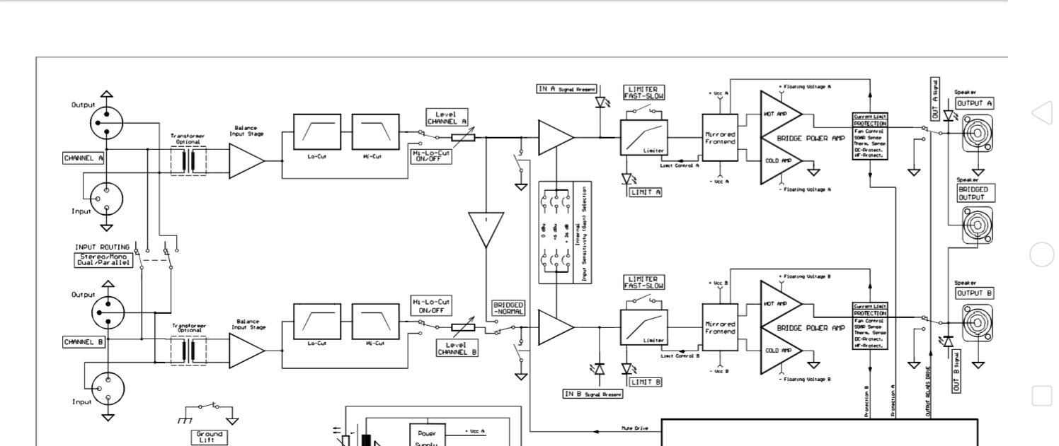

Currently there was a talk and an attempt in our local audio community to build an amp which will utilize two bridged amp to be connected again in bridge mode. Since the debate is not yet close, I would like to ask your expert opinion whether it is possible or not, or any of you has done this, or is true that Crown or any manufacturer made the bridged-bridged amp and already sold this in the market?
Crown’s old bridged-bridged amps do not have a ground reference for the first “bridge”. The two bridgeable channels are independent and floating. This is the only way it can be made to work. Do not even try it with conventional amplifiers.
It is possible to clone. You do need completely independent power supplies for each channel, and follow the grounding scheme to the letter. You are fortunate that these amps are old and obsolete so the schematics are still available. Can’t get any documentation on any model since the Harmon takeover.

Thank you so much. This information is very useful indeed. I haven't found any schematic yet on Crown's bridged-bridged amp. I hope it is not hard to find one. 👍🙂
You want the original Crown MacroTech line. They have been posted on this site before and may still be around on the Crown website. There was a white paper biaically how it works, which may still be there. The “VZ” versions have additional circuitry which is not needed to basic function.
Somewhere there is a thread on here about building a “grounded bridge” amp using only 2N3055 or other cheap low voltage output transistors. I’m not sure it was ever constructed, but the general principles were sound.

Thanks again, luckily I found Electrovoice EV P3000 Service manual. I think this will suffice my curiosity about the bridge-bridge configuration. The circuit is quite complex with different supplies for front-end stage and power amp stage. For front-end, it uses dual supply, while the power stage is a single supply grounded bridge stage. The upper amp output drives the load, while the lower amp output is connected to ground.
I have designed class AB amp with +/-230V rails. Because it is uses high voltage rails, the topic pops up in our radar, to seek the same higher power output using bridge-bridge topology with lower rails.

The channel bridge in the two channel mode is nothing more then a trick to raise the supply rails of the 'hot' amplifier by the 'cold' amplifier. The bridged mode is connecting these channels with one with inverted phase.
One could use these two (unbridged) amps as another hot and cold amp to lift another supply even further, and bridged two of those setups for massive output power.

MB, you're right it's a trick of the old when Vceo specs of those trannies were still low. Fast forward, nowadays, power trannies for audio amplification have already reach 350v like the MJL4281/4302. With cascoding, still Vceo can be raised twice. Now if cascoding is still not enough, we can employ bridging then. 🙂
Crown published an article at Audio Magazine in the 80's to 90's can't remember the month...they were the first ones to come up with such an idea of bridging bridged amps...
