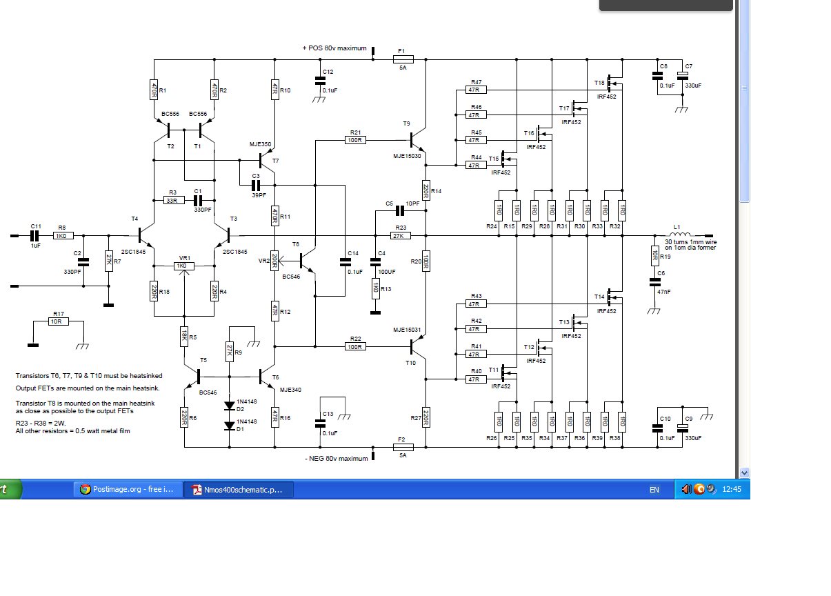

I want to build two pcb of these to have 2x400W amplifier 🙂
http://postimage.org/image/fwsb20b93/
What do you think , how much power can i expect on 4 ohm load and how much on 8 ohm load ?? And how much THD can i expect on 4 ohm and how much on 8 ohm 😕 🙂
I expect real answers , cheers 🙂

As that circuit is class B and looks like from the ampletos website, i'd say 0.5-5% THD.
And only four sets of 2SC5200 and 2SA1943 is not quiite enough for 400 watts into 4 ohms at the rail voltages specified, 6 pairs will be better and 8 pairs will be even better, at 10 pairs you'll have a reliable amp.
That is a very mediocre circuit. Read Bob Cordell's book and learn why.
The schematic is not really complete, you can do better with another amp.

agree with djk on the Vceo issue......
we are given half of the amp, with the rail shown drop further with load? i am not aware of any convention when showing rail voltages on a schematic, is that the unloaded rail of fully loaded rail?

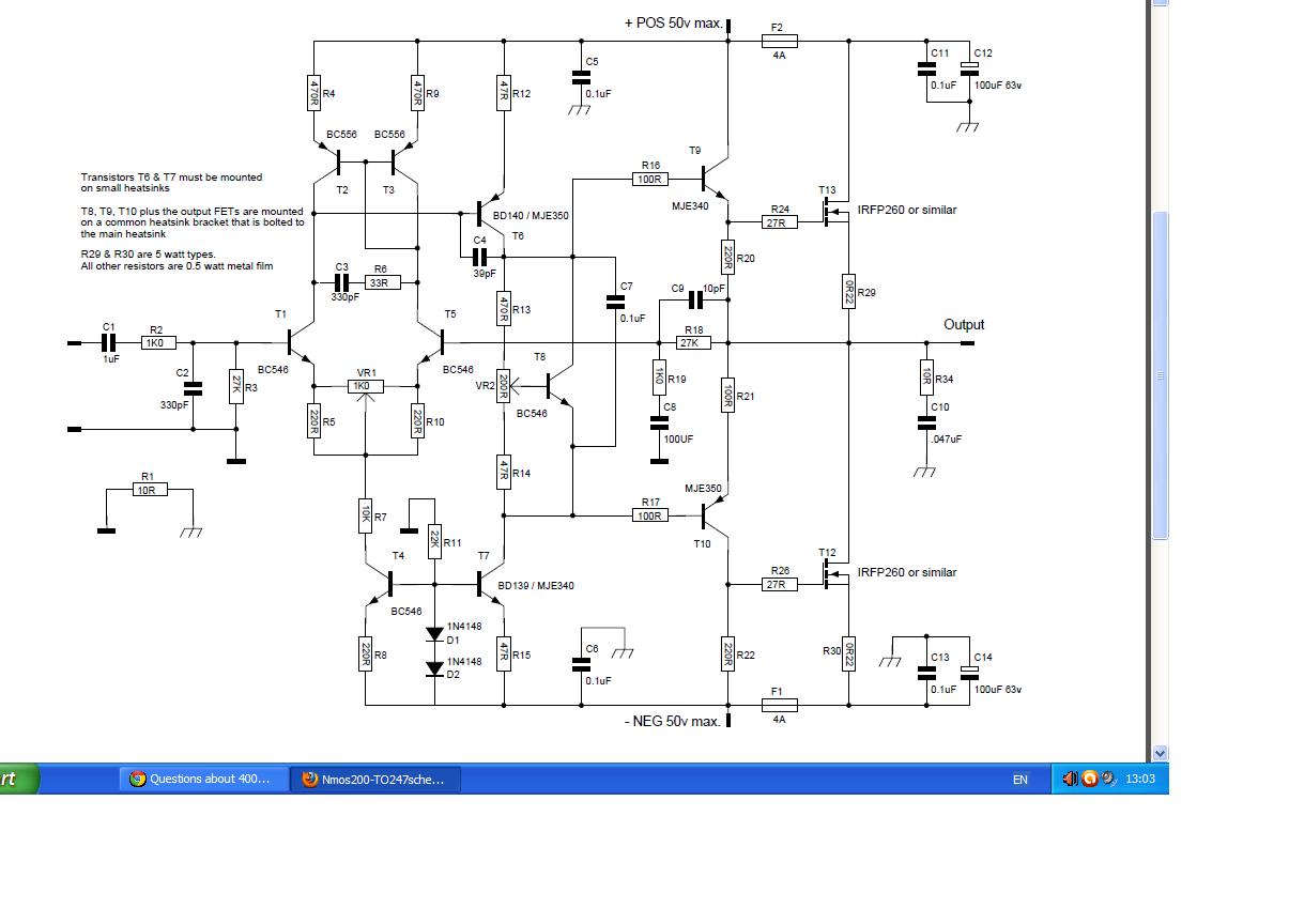

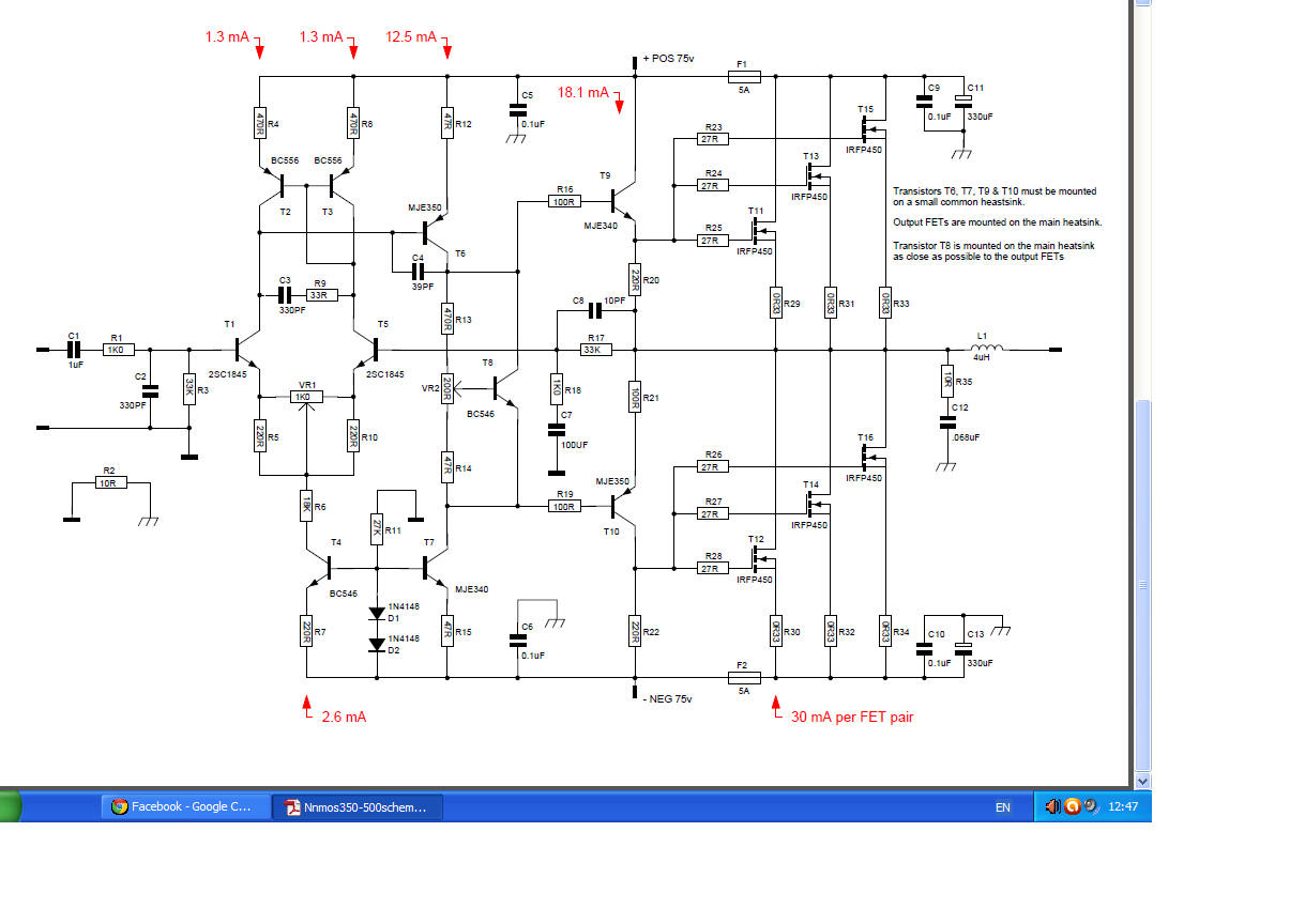

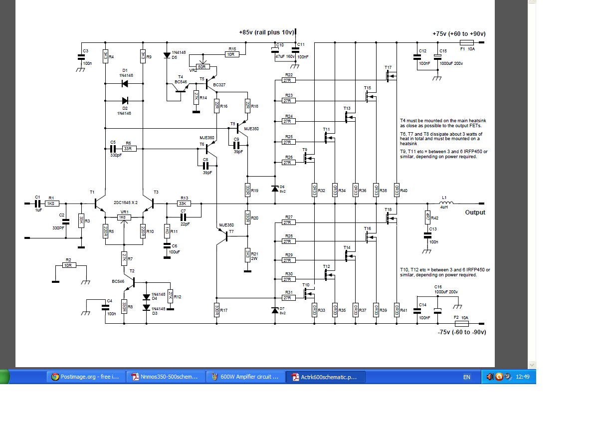

Now , i want to know how much RMS power gives each separately , and which has smallest THD . Im gonna aprecciate your answers 🙂

A base resistor of about 470Ω on the CCS for the Vas that has a common reference voltage with the diff input CCS will improve the performance under heavy load.

And something to say about this schematics ?? 😱 😕
