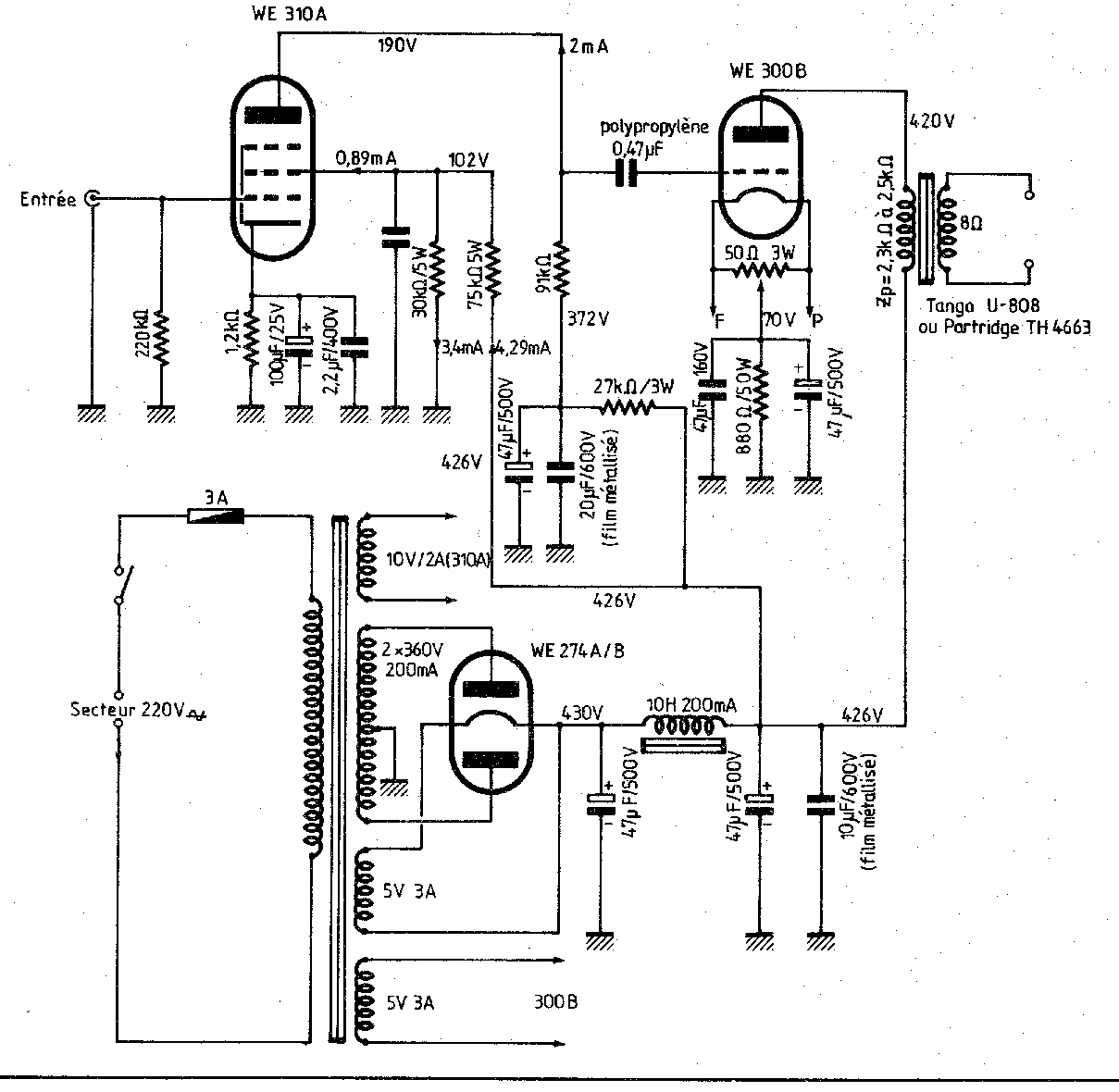

Hi folks
...The mV meter is no problem and....
Is this a typo? Or is it really a mV meter? Because you should measure 10s of volts.
If you want some real help, please draw a schematic of the amp, and how you are trying to measure... Then we dont have to guess...
greetz, Paul
Hi Palustris
Thanks for your help.
The circuit attached.
We are using the following instruments:
Signal generator :LEADER LAG-120B
Voltage meter : TRONEER TVT 32C
Again, we measure the frequency response from the output of the WE310, and we tried with and without the plug in of 300B, the result is the same.
All of the irons of the tube amp is made of Tamura, so we would not doubt about any indirect effect on WE310.
We had tried 6C6 and result is just slightly good.
After the trial of triode connection, everything is changed and roll off until 23Khz. But the output gain was dramatically roll off too, about only 1/5 of penthode connection.
So the suspect of other components fault can be eliminated.
Some penthode connection is by-passing the screen cap. to the cathode and we tried. The result is only slightly better than by-passed to ground, still starting to roll off at earlier response, properly at 4Khz and I can't remember.
Very frustrated!!! Hope folks can help us.

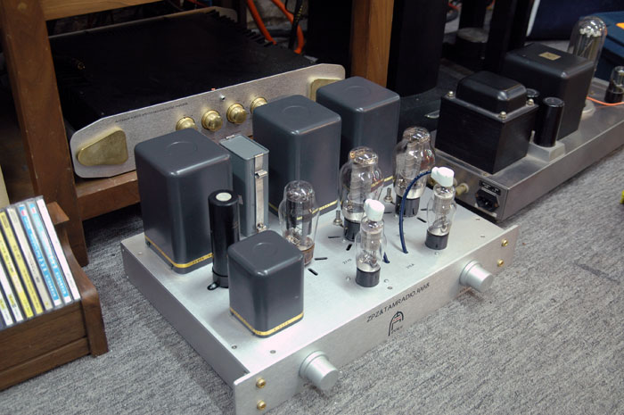

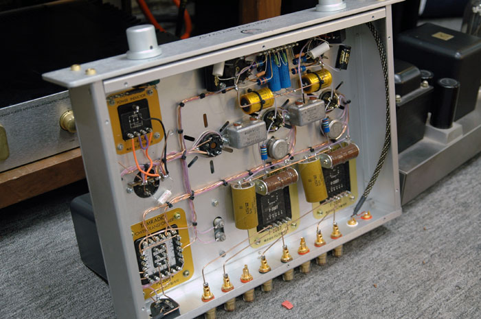

Hi folks
Every consideration we have made including testing instruments up to the testing cable. But the result still the same.
So, if anyone's tube machine has this config. or the similar, would you please try to measure the output of WE310 or 6C6 merely and share the experience.
Thanks guys.
Ps. have a look of the machine
Thanks guys.

Schedule looks good... don't think there is anything wrong with that. If it's the input capacitance of the meter, you should get a higher roll of when you measure at the speaker connections. If it rolls of higher, don't use the meter anymore for freq range measurement.
How does the amplifier sound? If you really have a -3db of 2Khz, you wouldnt hear high frequencys at all.
Yeah it seems to me that this circuit should easily reach 20kHz in the driver stage, something very odd is going on here. Lots of people have built variations of this circuit and none report bandwidths of 2kHz..
I would start by rechecking that every component in the driver circuit is the actual value you think it is.
Look for inadvertent shunt capacitance between the plate circuit of your pentode and ground and/or anywhere else you can think of.
I also noticed that there is a serious error in the schematic as drawn - where is the grid resistor from the 300B grid to ground - what is its value? I would recommend no more than 220K even in self bias.
<IMPORTANT>Did you do the experiment with the meter that I suggested in my last post - you want to make sure that the meter works properly when driven by a 100K source impedance which is very close to the driver source impedance in your amplifier. You may find that it does not, particularly if the input capacitance is 100pF or more. (100pf with a 100K source is -3dB @ ~16kHz) </IMPORTANT>
