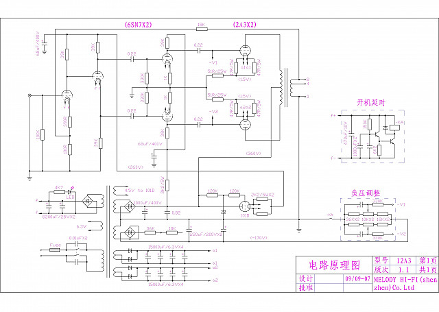

The tubes on my Melody i880 amp need to be replaced. The amp uses one 101D vacuum tube that seems to be pretty rare and 'expensive'. Can I replace this tube with alternative tube?
If not, any suggestions to were to find a budget 101D?

You should probably have them tested to be sure. Some of the old, directly heated tubes had a fairly long life compared to, power tubes. Does anyone know what the 101D tube does in this amplifier?
It seems to only have one so it could not be the input stage for a stereo amplifier.
Could it be that the 101D is a weird decoration gag here? I could imagine a single pentode to be part of an error amplifier to regulate B+ but have no idea how to do something like this with a 101D. Also for the price of the amplifier it most certainly is a chinese copy.

I found this, I think this circuit for or similar to the i880.
Maybe this clarifies something?
Yes, it clarifies that the 101D appears to be a particularly poor engineering choice for that circuit function. In fact, any directly heated valve would be a poor choice when fed with AC for the filament, as that circuit does. For a good CF you need a higher gain valve, perhaps one designed for the function of pass valve in a PSU; cheap and boring. It would be interesting to hear some comments from the circuit designer.
