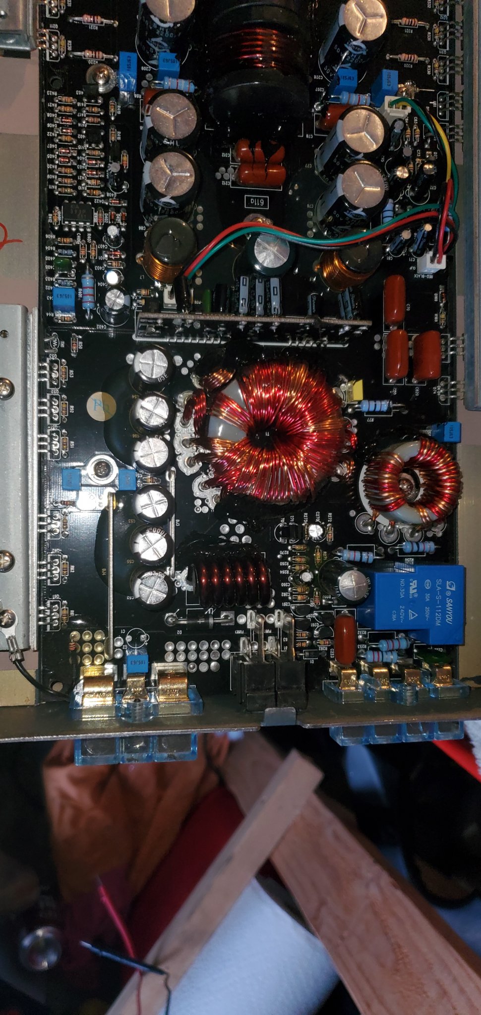

Hi Perry! How you doing? I have a question Sir. I have and old infinity 611a amplifier. Amp is working good and no problems I had it installed on my car but couple of days a go opened it to clean the internals usually i do this from time on time with some computer air can.Well I find that 2 capacitors are swollen so before they blew and make it worst I plan on replacing them one is 10uf and the other is 33uf both BP and 100v so I was reading this that you posted on this thread.

Well the question is can I use a 10 uf film capacitor to replace both of the swollen caps? I see you recommend a panasonic 10 uf 250v 105° to replace the electrolitics, this same cap can be used to replace a 22uf 250v BP capacitor too? Last question is for a hifonics amp capacitor.

When the feedback it taken from before the output inductors (this amp), the amp is likely less sensitive to a difference on the filter components. I think you should be able to use 2 10uF caps. That said, you appear to have a bit of extra space that would allow you to connect caps in parallel.
Thanks for your answer Mr. babin I really wonder why is so hard to get this capacitors.if just they had it in stock (Electronics stores)that should make the life easy for all of us. So 2 10 uf film caps for the infinity should work? And 2 10UF stacked for the hifonics ?
The infinity uses one 33uF and one 10uF. on;y one 10uF in each location should work but if you can find the space to connect more than one in parallel to make up the additional capacitance, I would,

that should work then and yes I have a hifonics ZXR 2000.1d here at the garage same problem bulged output cap still functional. Cap is 22uf 250V 105° this cap is very hard to get.
