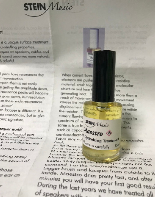

Dear kr1s,
I used to use Fostex 206∑ before.
I tried various methods, and MAESTRO(treatment lacquer) was the most effective.
The tweeter used FT90H (+0.33μF).
STEIN Music "Maestro"
Maestro Laquer/CD-Plus/CCS - SteinMusic

I hadn't considered a lacquer - I will probably try that after exhausting other possibilities as I'm a bit reluctant to do something irreversible (I assume?) to my drivers.

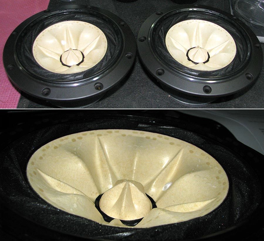

I have not done FE208e∑, but have done a few FE168e∑ and FE108e∑.
I eould not recommend lacquer. It stiffens the cone, and can lead to exacerbating the classic Fostex shout.
I use thinned modPodge which dries flexible, still ties the surface paper fibres together, and damps, not makes worse, the shout.
