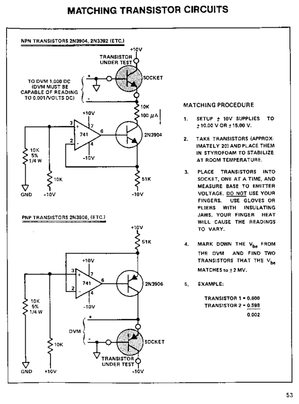

Hi I am new to this forum. I got the following transistor matching circuit from the internet it is quite simple and easy to build but the upper section (for NPN measurement) of the circuit has one 10K resistor connected between the two transistors while the lower section (for PNP measurement) has none. Would anyone please tell me is this a drawing mistake? Which one is correct? Thanks.

The original image is a Jpeg 100k file. It has been compressed when uploading to the thread. Could anyone help to post it with a bigger size if I send him the file?
Make a PDF file and attach that or email it to me..... 😉
Hi Jan
Thank you for your help. I am pleased to attach a pdf file of the circuit.
Albert

Back to your initial question; I think the 10K is missing in the PNP measurement circuit..... ?
Also if you do want to match transistors, I miss the possibility to match them at different currents like 100uA, 1mA and 10mA....
As to peranders suggestion about matching them in the actual circuit, I agree that that is the most correct way of doing it. Build a copy of the circuit (e.g. current source), and match the trannies at e.g. 3mA
You can try another matching circuit:
http://www.diyaudio.com/forums/solid-state/146693-john-curls-blowtorch-preamplifier-part-ii-19.html#post1901774

This is a good idea I also think it is better to match the transistors in the actual circuit but would you please give more information about how to perform the measurement to match transistors. Thanks
