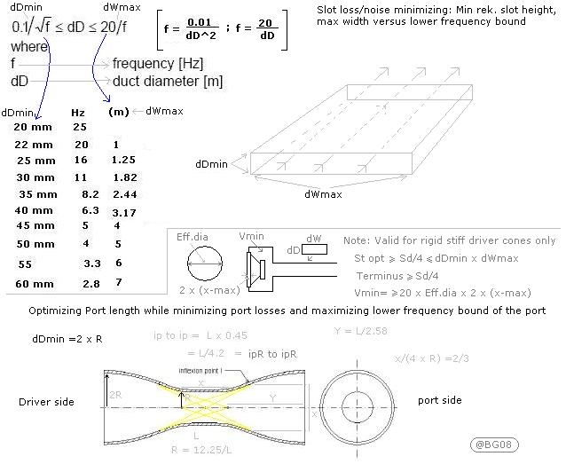

Rectangular is better than triangular but both are not optimal...
Optimal port shape: See the picture.
b🙂
Bjorno: that is a very interesting attachment you have shown. Do you have a link to the article it came from? Or could you explain further how to design such a port? Thanks and best regards Moray James.
I've made some rectangular ports. I have a router and roundover bits, but I haven't put a roundover on any of the ports I have made. I wasn't sure if it would change the tuning of the port. If anyone had thoughts on that I'd be interested to know.
It is a french master thesis for a company heliaetus 😉
A french presentation
http://www-cast3m.cea.fr/html/ClubCast3m/club2007/Club07_GPellerin.pdf
The original website is here but not work:
http://old.lam.jussieu.fr/src/membres/pellerin/pub
The AES article is more interesting because you can calculate the profile. I made an excel spreadsheet to calculate them. Not so easy you need to use the excel solver.

General flaring of the ports is good for reducing turbulance. If you start with a given length and then flare it, it will tend to make the effective length shorter (tuning higher) because a percentage of the port is having its diameter increased.
I'm talking about big end flares here. Roundover bits wil barely change the tuning, yet getting rid of the sharp edges will cut down turbulance a significant amount.
Regarding port cross section, we would like to have the maximum area with the minimum port wall surface. Best would be from a circular port. Worst would be a very thin and deep slot. I can't imagine an equilateral triangle would be much worse than a circle. If it fits the cabinet better, go for it.
I once tried a compact sub with an elliptical profile from end to end of the port, supposedly one of the best cross sections and patented by our friends at Bose. It was better but not by leaps and bounds. We ended up going with a PR.
David S.
Rounding ports with a 3/4" round bit will reduce chuffing (turbulence noise) and won't appreciably change tuning.I've made some rectangular ports. I have a router and roundover bits, but I haven't put a roundover on any of the ports I have made. I wasn't sure if it would change the tuning of the port. If anyone had thoughts on that I'd be interested to know.

That's the right origin for my drawing, agree the AES paper is the one to study.
Most important is that the port becomes directional and have output lower than fb in a BR box besides a comparable smaller size than a straight cylindrical port.

I've built the Basement Blasters and Iron Lawbreakers with triangular ports (with port end radiuses) at the lower end of the enclosure because the internal port members also give a significant amount of bracing to both the cabinet sides and bottom, and the two sides of the port formed by the interior walls of the cabinet do not require any flaring at all inside the cabinet. I probably could have saved a couple tenths of a cubic foot by using an optimum port taper, but opted for simplicity there, plus the more effective cabinet bracing of a constant cross section throughout the length of the port.
Does anyone have any comment on using multiple lengths? I'm looking to do a dual 3" port for my 15" midwoofs, tuning to about 40Hz in 5 cu ft. That' gives me a length of 2.5", but I was thinking of using 1 each 2" and 3" long- can it be treated as an average length, or do we need to get more indepth calculating?
I wouldn't generalize about more extreme cases, but I think for what you are talking about the average length is correct. I am sure that the two ports combine for a single tuning.
David S.
We had an a/d/s sub that was built that way. Worked fine and did simplify the parts count.
David S.
http://www.diyaudio.com/forums/subwoofers/144331-multiple-ports-different-tunings.html
Chris
Thanks, I'd seen that thread but searching didn't bring it up.
I haven't that much experience, but when simulating ducts it seems like the larger I make the port the more resonances I get. Is that true in real life? If that's the case I wonder what is worst, chuffing noise or resonances?
Another question, can anything be worse than a round port with regards to resonance? I had a 2 kHz problem in my speakers and put x-shaped corrugated paper in the duct (see link below and scroll down to the last picture) and things really got better, both measured and soundwise (or maybe it was just placebo).
Modding Troels Vifa PL14/XT25 - Techtalk Speaker Building, Audio, Video, and Electronics Customer Discussion Forum From Parts-Express.com
Long ports of any shape may have resonances that may be objectionable, often a sharp dip, followed by a peak.I haven't that much experience, but when simulating ducts it seems like the larger I make the port the more resonances I get. Is that true in real life? If that's the case I wonder what is worst, chuffing noise or resonances?
It does not look to me like the 2.5K reduction you saw has anything to do with the port, it has to do with the crossover choices you made.
You could determine what the port resonances actually are by measuring the response with the port open, port closed (stuff it with a rag, or potato, whatever) and the X shape.
- Question about reflex duct shape
