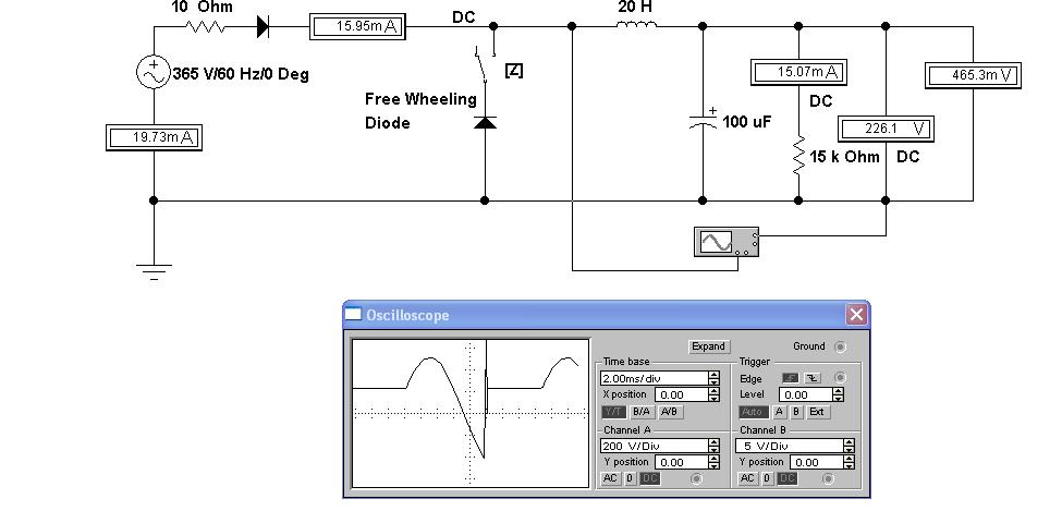

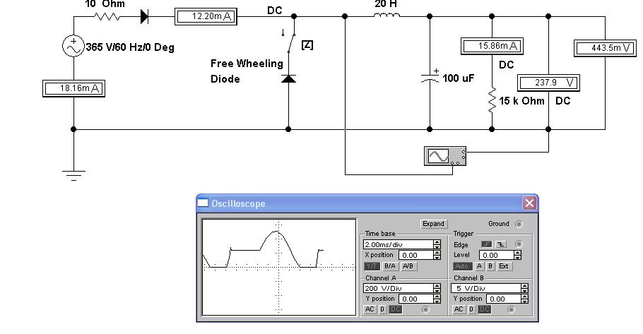

The 6AU4 is a damper diode. I thought that with half-wave rectification choke input filters don't work like they normally do. Besides that, why use a choke input filter for a tube that runs in class A (and only consumes 20 mA)?
There is one advantage of choke input: it is much quieter than capacitor input. The rectifier is full-wave (two 6AU4 tubes), half-wave won't work with power transformer.
They said it couldn't be done?!?! Not recommended but here is the free wheeling diode in action.
The transformer is DC biased tho, not good. Notice the large negative overshoot when the freewheeling diode is unhooked.
