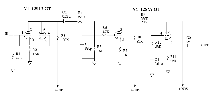

Im a beginner here so bare with me. 😉 I need a phono preamp, so I found the attached scamtic. I have a few questions:
1. do all the capacitors need to be rated 250volts? If yes, where do I find the right ones? If no, what do I need.
2. The power supply schematic was not included, is there a generic 250vdc output schematic out there?
There also may just be something I'm missing, cause I'm a beginner. Any help would be greatly appreciated. Thank you.

For a complete beginner looking for a tubed phono preamp, I'd suggest the Bottlehead kit. It's an easy build, everything is included but the tools, glue and finishing materials, and unless you have a healthy stock of spare parts, the price is impossible to beat, even with the C4S upgrade.
http://www.bottlehead.com/et/adobespc/Seduction/seduction.htm
(Eileen not included)
...agree with chrisb. The seduction is a well thought out circuit, especially in regards to grounding. If you want to roll your own, I'd recommend building a line stage or two first. After that, I'd recommend the phono stage designs of Allen Wright and Steve Bench.
A phono stage isn't the easiest 1st project (by a long shot), and you could end up spending months trouble shooting it without any guarantees as to the outcome.

I'm not really looking for a kit. I have the tubes, the housing, some connectors, and transformers. I all really need are the resistors and capacitors. I think I can get the resistors and capacitors from small bear electronics for way under the price of the kit. What I really need is some clarity on reading the schematic.
jn2630 said:Im a beginner here so bare with me. 😉 I need a phono preamp, so I found the attached scamtic. I have a few questions:
That's a Bob Danielak design. C1, C2 and C4 should (IMO) be 400 WVDC, to provide a healthy margin of safety. C3 can be low WVDC, as it's protected by C1. The value of C2 should increase, for mating to low I/P impedance equipment. A silvered mica part is OK for C3. Panasonic ECQ-P(U)s are fine for C1 and C4. A GE 40L3501 is good for C2. Jim McShane should be able to help with the caps. and (perhaps) other parts too.
You need a DC heater supply, along with a well regulated B+ PSU. FWIW, I previously worked out a pseudo choke I/P filter 250 V. B+ supply. Let me go to the "archives", after work, and I'll post again.
jn2630 said:Thanks man, thats great info. Now its just the power supply I have no clue about.
You can get a very satisfactory B+ supply by voltage doubling a Triad N-68X isolation trafo. Follow the doubler cap. stack with a LC section. Finally, a Maida style regulator gives you the 250 VDC, on the dot.
A "Rat Shack" 273-1512 25.2 VCT trafo will power the DC heater supply. FW rectify the trafo's secondary with a MBR20100CT common cathode twin Schottky diode. Filter with a 15000 muF./25 WVDC 'lytic. Follow the 'lytic with 3X 7812 3 terminal regulator ICs. Each 12SN7 gets a dedicated regulator and the 2 12SL7s share a regulator. Don't forget clip on heat sinks for the TO220 case regulators.
For starters...
...the older CJ PV-12 power supply has four regulators; the first cascading into three individual stage regulators. The voltage output is determined by the stack of zener diodes:
http://www.drtube.com/schematics/cj/pv12.gif
...the Morgan Jones 'Valve Amplifiers' book: page 480 / 481 shows a 270V regulator. Change the ratio of R1 and R2 to get your desired 250V. Get a sneaky look at http://books.google.com
and
http://books.google.com/books?id=b4...ece&sig=C2q2lmQpW_QHFNJTAIyH4Y94j4U#PPA481,M1
...or adapt this one:
http://www.next-power.net/next-tube/articles/hvs/hvrEn.pdf
and
