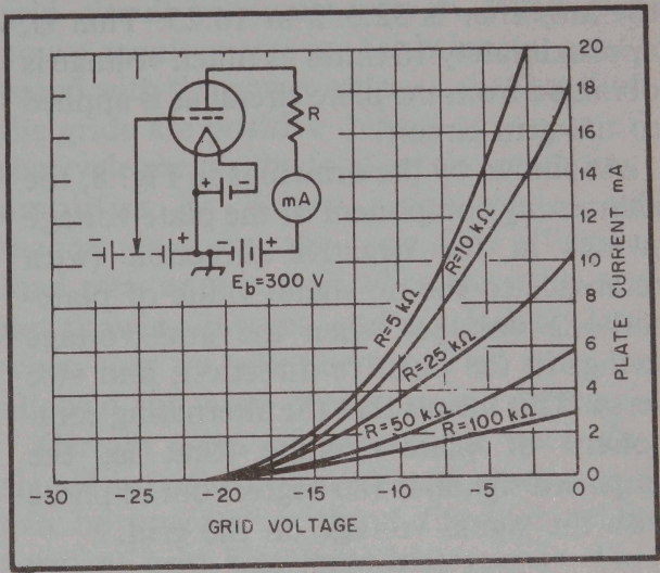

1) Why for triode, the optimal load is 2ra?
It isn't really. For the best linearity, triodes like the lightest possible loading. That applies to small signal voltage amps as well as large signal power amps. (Attached)
