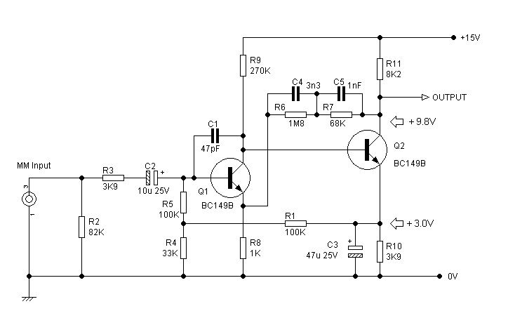

Well, what makes this rather common phono preamp that famous? Maybe this extra 47 pF Miller capacitance 🙄?
