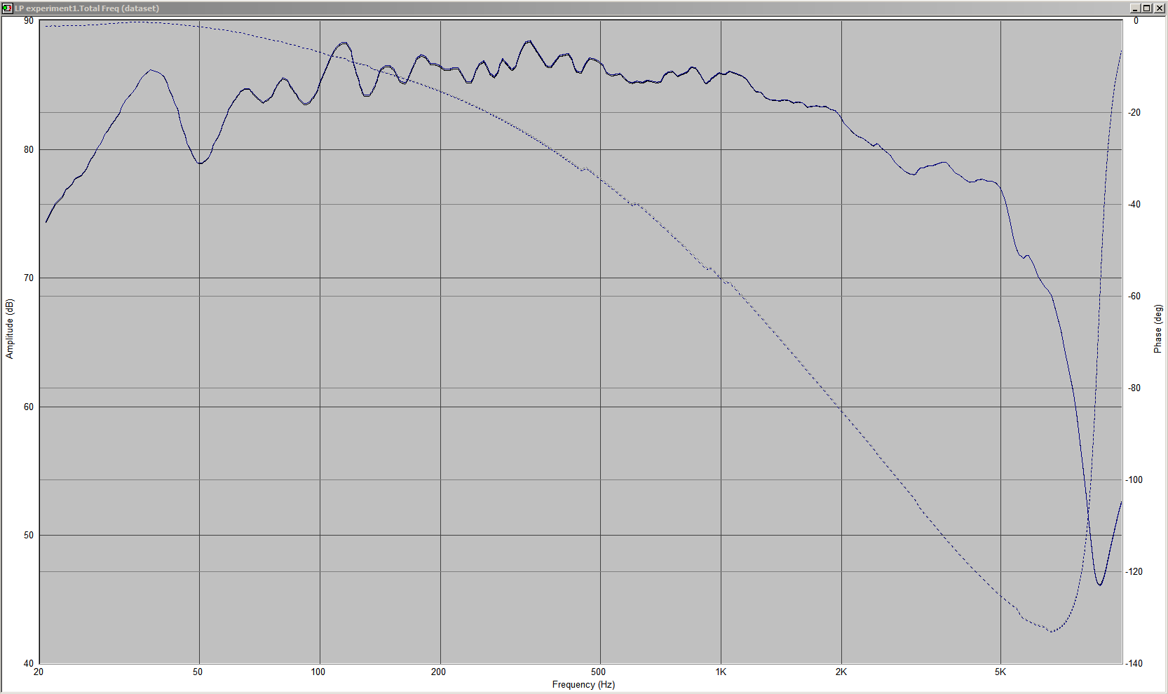

The coils in the crossover design have a specified DCR. For the HF section I found one which matches, but for the LF section the closest I can get to the specification for both coils is about 0.1 Ohms lower than spec. Obviously I could simply add a 0.1 Ohm resistor in series to each coil, but I'm wondering whether this will even be necessary.

Thanks. There are two inductors in the LF section and their spec'd resistance values are 0.8 and 0.5 Ohm. Since 0.1 is a not-insignificant proportion of both these values, I think I'll either simply include additional 0.1 Ohm resistors to bring them both up to spec, or - if I can - experiment with/without the additional resistors.

I think that you will find that the series coils in the bass section, it will not make much of a difference if you drop the dcr by 0.1 ohms. Assuming it is the middle one, the difference between 0.4 and 0.3 ohms percentage wise seems quite high, but when you compare that to the resistance of the voice coil it becomes a lot lower.
At most I would expect you to see a very slight rise in the lowest frequencies.
Differences with DCR in shunt coils in the tweeter section can make a much bigger difference though, and can affect phase matching, but since you have found one that matches for the tweeter section I think you should be fine.
just as an experiment I simulated the low pass crossover (standard version) with 0.4 and 0.3 ohms on the low pass. Note that the speaker in an SB accoustics one not the actual driver in the project, so is only to show the relative difference that 0.1ohms less DCR makes in the series coil.
As you can see the difference is very minimal. edit: I see it was the premium version... still I think it probably will not make a lot of difference.
