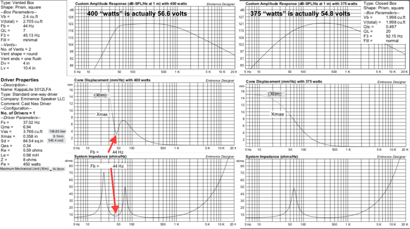

Considering you seem to be trading in small drivers with little excursion capability, you could get considerably more output using multiple subs in series, or series parallel to increase cone area and output using the same amplifier.
That said, you seem to have the impedance response of ported and sealed subs reversed in your examples.
An example is attached below to illustrate, ported on left (Fb 44Hz) and sealed on the right. As STV explained, Fb (box tuning frequency) and the minimum impedance are at the same frequency, surrounded by higher impedance peaks on either side.
In a closed box, the impedance peak (Fc) is always higher than the driver’s free air resonance impedance peak (Fs) the Fs of 37 Hz rises to about 61Hz in the example.
Below Fb, response drops at around 24dB per octave, and your hearing sensitivity also drops off at lower frequency- if you want decent response at 35Hz, the Fb should be near that frequency.
