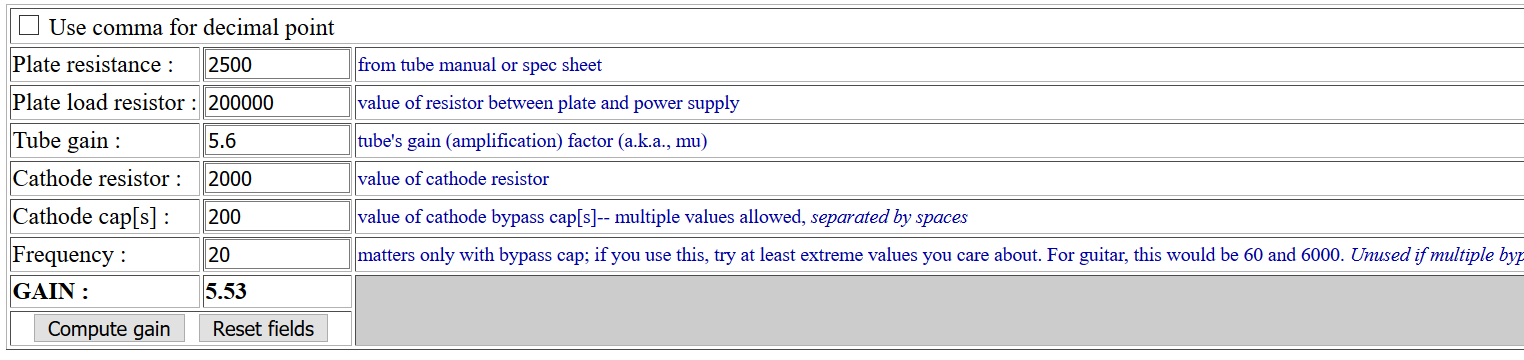

Ok, i found some calculator to check the gain without considering the transformer step down ratio.
so the voltage gain on the tube will be more than 5, around 5.3 while loss on the transformer around 3.5, so if I am not mistaken overal gain should be 3db.
What about the output impedance? how to calculate it?
Internal resistance of the tube divided by the impedance ratio 13.3.
do you see any issue with frequence response
Depends entirely on the quality of the output transformer.

46 tube with transformer load will need a bias closer to -35V, not -10V??
Thank you @MerlinB
well, yes, you are right about the operating point, however lets skip this for a moment please. this I should be able to handle, however I have some issues still with understanding output impedance.
This device will be used as simple line stage connected directly to power amplifier with 30kohm input impedance.
30kohm load on the secondary winding will give 400k in the primary side, right?
30k / 600R = 50
50 * 8000k = 400k
400k in parallel with 2.7k is close to ~2.7k
Transformer ratio: 3.5 : 1
3.5*3.5 = 13.3
2.7 / 13.3 = 200ohm roughly
Is that calculation OK?
Is there any potential risk if load will be higher than 30kohm?
Sorry, I made a mistake and misled you. Input impedance has no effect on the output impedance calculation.
Output impedance = 2700 / 13.3 = 200 ohms
That will affect frequency response and distortion, but it will not change the small-signal output impedance.
