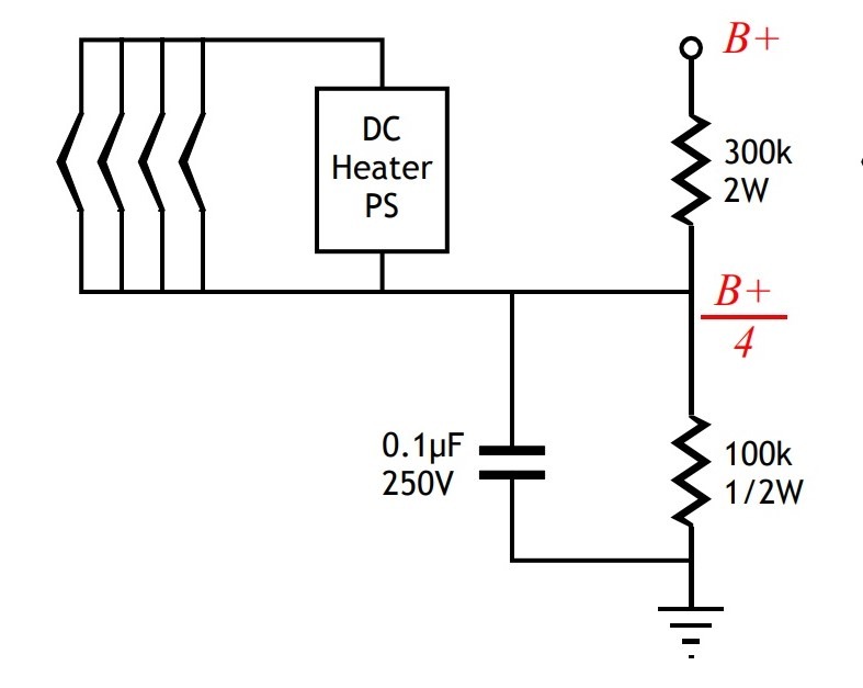

Do i feed positive and negative to the filament ör just positive voltage if someone can elaborate it
İ am using DC voltage btw

Ok, DC. You still need to feed the tube 6.3v, the heater needs that 6.3v difference in potential. So you can give one pin +6.3vDC and the other 0v. Or you could give one pin -6.3vDC and the other pin 0v. Or....
As long as your potential difference is 6.3v, you're good.

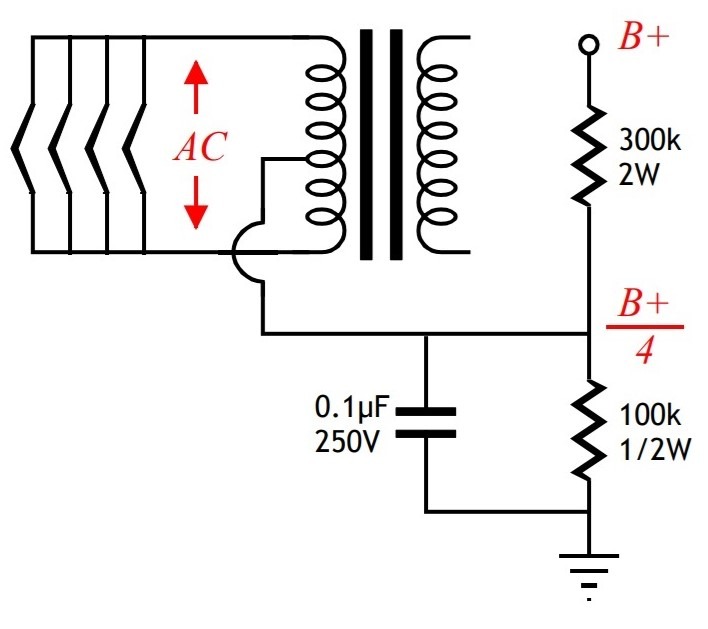

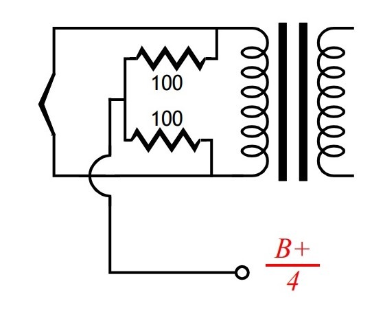

If you are building a power amp AC will likely be OK on the filaments, You can still float them, see Filament float 2 attached. If you don't have a centre tap on your heater supply one can be simulated with 2 resistors, see Filament Float 3. You will still need the two resistors and cap like on Filament Float 2.
