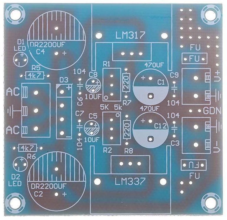

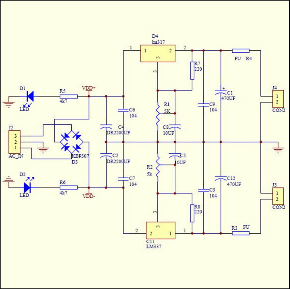

I built a dual (positive/negative) AC to DC power supply board using LM317/LM337 (it's that in the photo attached).
Is it ok if at any given time I use only the positive output of this power supply
to power a device or would that be a problem for the circuit ?

Yes, most amps pull from rails in an alternating fashion when there's a signal, even opamps, so the PSU has to be able to handle each rail independently.
A really good supply will have a protection circuit that switches off both rails if either fails / goes under voltage, but otherwise consider it to be two power supplies.
