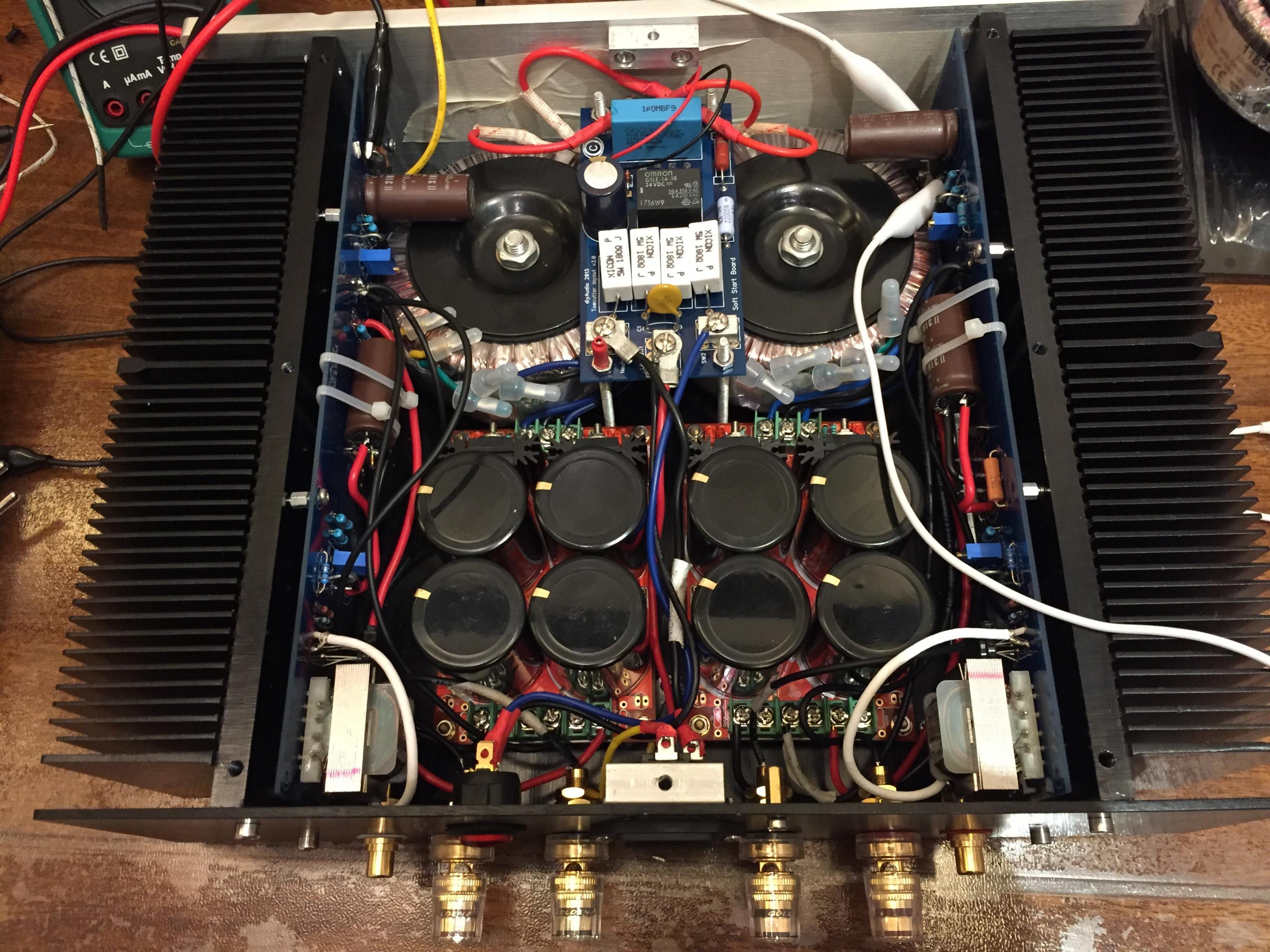

I very much want to avoid fans if at all possible. I agree that forced cooling would be easier. Putting it all in a bigger case with normal heatsinks would also be easier
I think I'll go with the standard 4U Deluxe case for my first build, try branch out from there. I definitely want to try a super compact build at some point! Maybe twin monoblocks that share a separate power supply enclosure? Only my bank balance can stop me!
Yes, I know what you mean. It's fun
Damn that's tight! 😛 What amp and case is that? That thing is be *dense*
