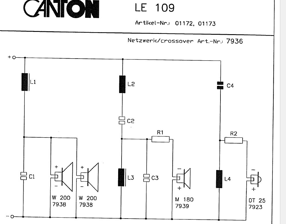

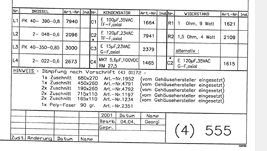

Hi could you tell me what is inductors value ?
Just a guess (but it makes sense).
L1: 3.9mH cored 0.8mm wire
L2: 0.48mH air 0.6mm wire
L3: 3.5mH cored 0.85mm wire
L4: 0.22mH air 0.6mm wire

by the way what your impression from this crossover ?
The x/o is 2nd order electrical all round. Hard to say without
full driver details and cabinet modelling how good it is really.
Or a full set of measurements of the final speaker.
rgds, sreten.
