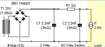

After the rectifier in the power supply, the Aleph has a large capacitor, followed by resistor(s), followed by another large capacitor to smooth out the ripple in the unregulated DC output. Thus the designation CRC - Capacitor, Resistor, Capacitor.
The greater the resistance the greater the voltage drop.
Attached is a circuit diagram from Duncan Tools PSU simulator. It's worth Google-ing it up for experimentation. I found it to be pretty accurate and a great learning tool.

Michael,
Download the Duncan's PSUD2 power supply simulator.
http://www.duncanamps.com/psud2/index.html
If memory serves me, the Aleph 3 draws something like 2.5amps of current per channel.
It will help you find the right values for the resistors. Here's a link to a parallel resistor calculator: http://www.1728.com/resistrs.htm
Once you find the right resistor, duplicate that value through the calaculator above for 5 or 6 3-5w resistors in parallel to share the load.
