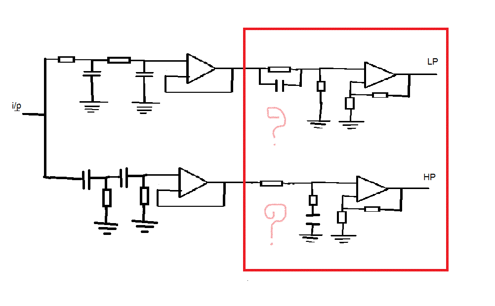

filter with a limited frequency range.
Some might call it a shelving filter.
The first part outside the red is difficult to get right.
A single pole filter that is buffered such that Rs= zero and Rload = infinity is a standard filter block.
You show a two stage filter where the Rload of the second stage "loads" the first stage such that Rload << infinity.
And the first stage sources the second stage such that Rs>>0.
This results in the cascaded filters NOT performing as two single pole filters with the correct loading.

Thanks. This is from GSI X-1 xover that sold in 70's. Someone said it was one of
the best in that time. That's why I try to figure it out.

Depending on the dimensioning this could be either
1.) A simple second order crossover with some driver equalisation
or
2.) A second order symmetrical transient-perfect crossover (i.e. constant voltage crossover)
Regards
Charles
