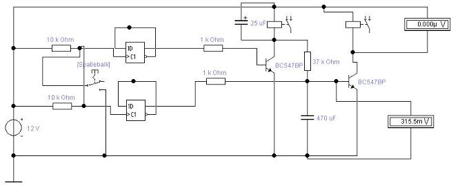

Hi there,
I'm currently building an amplifier with 2x625VA toriod transformers. (paralleled
To just turn them on with a switch isn't such a good idea, beceause of the inrush current.
I thought in this thread you could use it.
With this schematic it wil reduce the inrush current by switching it first powering it on with a resistor is series, and then another relay takes it over to turn it on full power.
It also reduces the inrush on your secondairies.
In the picture you see the timedelay, the first relay is on when you put a pulse on the D-flip-flop. Later the second will take it over.
When switching it off, I delayed the first relais, the first will go off, and later the second relais(with resistor in series), to prevent sparks on the relais-contacts.
Maybe any hints comments on this?
Grtz,
Remco Blankesteijn

Remco, this is a good try but I think Pjotrs circuit is more of what you need.
1 Avoid high speed flip-flops! I get chills when I see that. So sensitive against transients.
2 Must use a diode across the relay coil.
3 The reset time must be very short. If you get a short power interuption your circuit must be ready. This circuit is for the inrush current of the transformer itself. Reset time less than 1 second, 300 ms is good.
4 The time is 1-2 seconds. You don't need more.

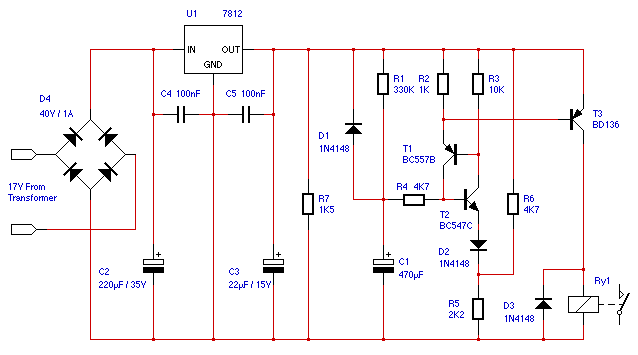

Hi Ralph,
The time delay is app. 0.5 x R1 x C1. This is not that accurate and it depends slightly on power supply voltage. But it is accurate enough for a power on delay. Do not make R1 larger than 470K. If you need longer times make C1 larger.
After power down it needs some time (app. 15 sec to 30 sec) to recover fully. C1 needs to discharge fully. Otherwise there is a risk that if you switch on the amp again too quickly the circuit will trip the relay on immediately. I have not found this a problem. It is not wise to sequence power of and on too quickly in general.
But if you found this a problem I can hand you a little mod if necessary.
Hi Pjotr,
70-80 seconds will be fine. And in the unlikely event that I switch the amp off and on within 30 seconds, it's no problem that the relay is triggered because the heaters are hot already. At this moment I don't have a delay at all 🙁
I'm planning to use an unused secondary of the powertrafo 0-17V for this purpose. Standard bridge rectifier -> 1000uF -> 40R -> 1000uF -> LM317 set to 12.0v will be the powersupply.
I will use two 2-pole relays of 40mA each to switch on the HT for the 300B and the HT for the 5687 driver (L+R) and I will use one 1-pole relay of 40mA that operates a tricolor LED (15mA) that changes from red at switch-on to green after trigger 🙂 That's 135mA total.
Let you know the results, Ralph

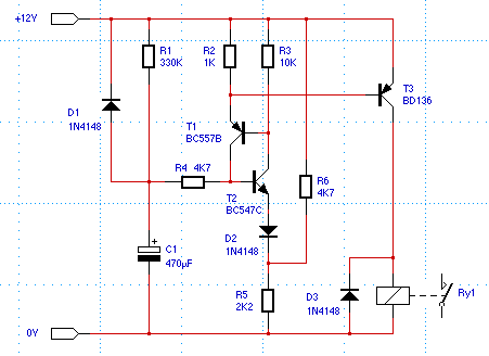

Hi Ralph,
The circuit is not critical and don’t need 1000uF + 40ohm + 1000uF for filtering. That only slows down the release of the relay at power down. If you power it from a 17V winding of the transformer then a single buffer cap of 220uF to 470uF is enough to power 200 mA to the relays. You also don’t need a LM317 for stabilising. A cheap 7812 does the job as well. But if you have a LM317 at hand you can use it as well of course. Oh and don’t forget the caps C4 and C5 close to the stabiliser. These ensure stability of the stabiliser.
Attached the circuit that will do the job. I did not build it but I did simulate it for you and it showed ok. It gave a delay of 70 sec. and it powers down almost immediately. The circuit recovers within 10 sec. R7 is a bleeder resistor to ensure complete discharge of C1 after power down quickly.
Good luck.

Hi Peter,
Thanks for this great help, parts will arrive tomorrow and I start building right away. I have a unused LM317 so will use that instead.
