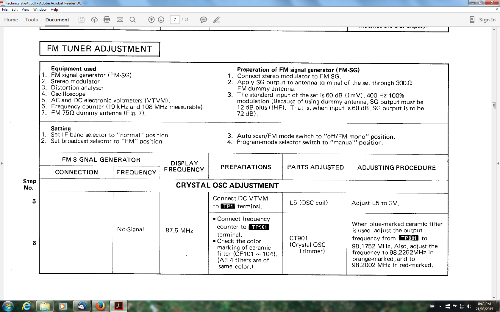

I have the service manual for the Technics tuner. Is this the procedue I use to adjust the readout?
Procedure outlined is for adjusting the oscillator which should follow also to be what is displayed,

The Technics tuner I have is the ST-S4. I have the ST-S4T service manual,its the only one I could find that was close? The Kenwood is one of those modular models that came out in the 1980s or thereabouts its the RX-235 model with amplifer,dual tapedeck and an FM AM synthesizer tuner.
IC901 and IC903 drive the FL (display)
IC901: adjust X908 crystal frequency to be 4.5MHz, by turning the trimmer-capacitor CT901. This should fix the problem. (Also, check pin 21 voltage - it should be 4.8V)
IC903: make sure the pin 9 and pin 10 are sitting at -25.3 and 4.8V
Couldn't find anything on Kenwood RX-235, but the logic is the same - so find the FL driver chips that drive FL segments... and do crystal frequency adjustment first.
Nick

Pin 9 and 10 on IC903 read OK 25.01v and 5.20v. There isnt any X908 crystal on this model just the 4.5mhz X901? and no CT901 either? There are two CT trimmers on this board,CT1 and CT201.There are 3 variable resistors as well, VR501,VR301 and VR302.I cant see anything obvious near the ICs to trim?
Try the correct 'technician repair method' as a test 😉
See if a well placed finger on and around each trimmer cap has the desired effect. Thats enough to pull the osc without you having to alter anything.
This is local oscillator drifting and is very common in older quartz synthesized tuners. A full alignment procedure requires some exotic equipment which is aligned itself, and also some experience, particularly when it comes to optimal adjustment of dispersion groups.
The other way is to locate the adjustable L coil in the oscillator circuit and align the frequency display to the correct value, trusting that the radio station transmitter is frequency accurate, which is probably the case. I would suggest using plastic screwdriver for this purpose because ferrite cores are very brittle.
