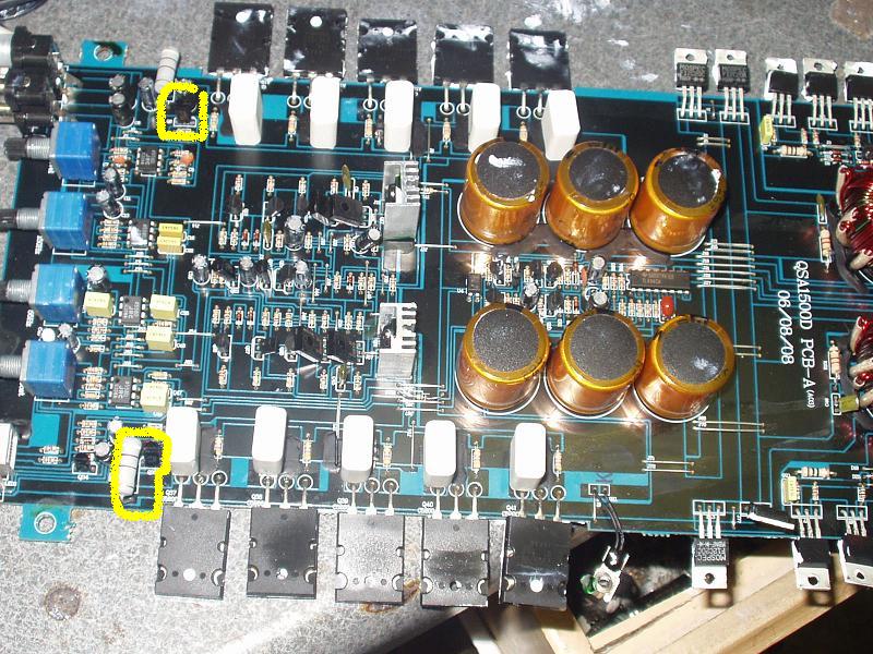

Im working on this amp. The amp powers up and produces output but very low.
I turned the gain pot up and the amp will stop producing audio. So i sprayed some contact cleaner in it and turned it back and fourth 100 times.
Still have the same problem the amp will work until i turn the gain up and it will stop producing audio. When i turn it back and fourth when the amp is up and running the test speaker will flutter back and fourth .
So to me im thinking i have a bad pot. Would this be correct?

It would seem that you have a bad pot but there are other possible problems. I'd suggest checking the output voltage of the op-amps to see if any have more than a fraction of a volt of DC.

There's definitely a problem. One op-amp has positive voltage on its outputs but has no positive supply voltage. I would suspect that something is shorting to the output of the amp (solder bridge, etc.) if the voltages you posted are correct.
None of the others have positive supply voltage either. You need to trace this problem back to the 15v regulator to determine where the problem is.

If you can't find the regulators, post a photo of the inside of the amp.

I will get the camera out right now and take a pic of the amp

The regulators are likely the small transistors connected to the large resistors near the last output transistor (nearest the RCA end of the board). Look for bad solder connections on the resistors. Post the voltages on those transistors if you don't find any bad solder connections.
If theese are the transistors you are talking about 1 is a 2383 and the other is an a1013

I re did the solder connections on the resistors and the transistors still have 12 volts on pins 1 and 2 of the op-amp

Ok i did some more checking and cant figure this out i have + - 15 volts on all op-amps but the 1 op amp still has 12 volts on pins 1 and 2 of it
If you still have 12v on pins 1 and 2 of the op-amp, remove it and see what you have on pins 1 and 2 after removing the op-amp.
