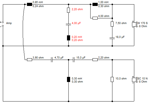

Let's look at a typical LCR notch circuit, designed to take out the typical 6kHz cone resonance of a 6" driver. Below. Based on this clever idea: mh-audio.nl - Home
Typically a 6" driver is driven by 20V peak to peak when loud. Unless I am losing my mind, that LCR notch has a "Q" around 4, simply because of the 2.2R resistor employed. This means that every reactive component sees about 80V. A 50V non-polar electrolytic is seeing about 80V.
I wouldn't ask that of an electrolytic. Makes much more sense to use a 250V MKP type. Aside from which, a NP electrolytic is quite unstable on capacitance with time. They wander as they age and dry out. Which affects a fairly precise tuning.
I don't suppose the 7.5R plus 18uF impedance correction is very critical. A NP makes sense there with a smallish ESR around 0.5R..
I'd also use aircoils in an LCR. Why? With a high "Q" currents are exaggerated and non-linear effects (and noise) increase. It is simplicity itself to include resistance of a coil in the overall LCR circuit. The resistor just gets smaller.
