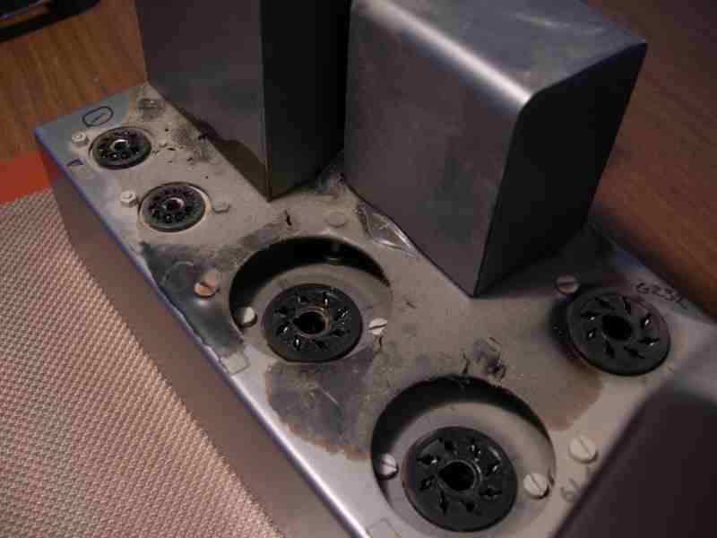

Ok so some of you are gonna hate me but yesterday I was given a set of Quad II's with the 22 pre amp and FM tuner.
I am a lucky bastard.
anyway they are in rough shape, they have been in storage for some 20 years and by the looks of it they had been left on for long periods as one of the tranformers has leaked tar all over the top and onto the circuit board inside.
I want to restore them back to original with the only modifications being for safety concerns if they can be done without permanent changes.
So my questions are;
1. How do I safely clean off the tar without damaging the boards
2. What to look for when inspecting the tubes
3. What to do about the transformer that has leaked out all the tar
Any suggestions would be appreciated as I want to do this right.

First, I hate you. (Not really, my MC240 came the same way.) Tar to me suggests that transformer potentially experienced a violent and destructive episode. In your place I wouldn't consider powering it up without confirming that OPT has full continuity and no shorts between anything (leads, case, etc.), and ideally using a Variac to bring it up slow once you're sure it's OK.
Don't auto supply places sell a bug and tar remover for vehicle exteriors? Might be an option.

I 'inherited' a similar condition QuadII power amp. bASed on that experience I would say that your transformer is almost certainly well and truly fried. I cleaned the tar off mine using a small quantity of petrol in a old pot. Scrubbing with an old paint brush did the trick very nicely followed by a scrub with dishwashng detergent to get the oily petrol residue off the transformer case. I did it outside with lots of fresh air and I'm a non-smoker!

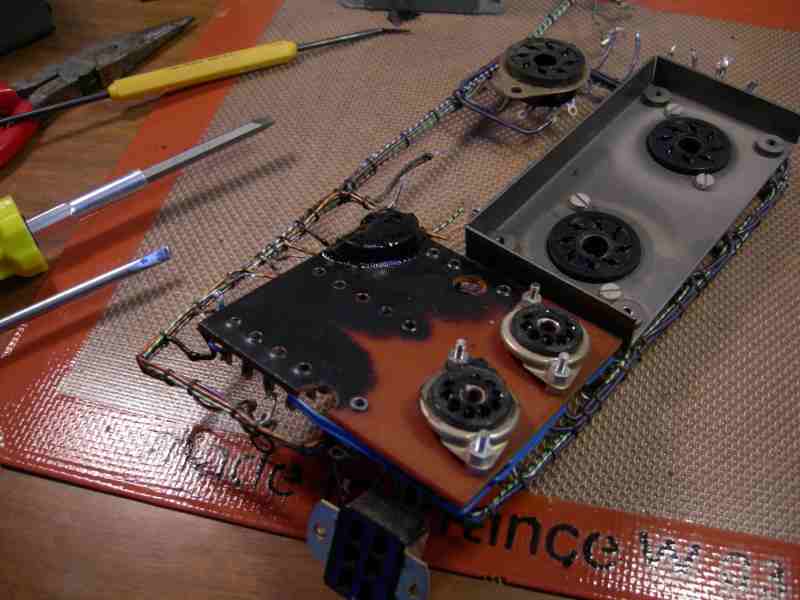

The audio output transformer case has a phenolic pcb with turrets swaged into it. These turrets allow you to change the winding ratio for different loads. The only catch with the petrol methos is that the printed labesl disappear! So write down anything you can read BEFORE ypu start cleaning. Of course, if the other unit is not damaged then you can use taht as a reference when you come to rebuild it.

Yes, it was the power transformer that failed. I recall getting a quote for a replacement from Quad. It seemed pricey so I reverse engineered the transformer and had a local transformer manufacturer wind a replacement that would fit the original steel case. If it helps, I may be able to locate the spec used to wind them. Think, deep in the archives ...
Leaking tar in Quad II amps is not unusual, and doesn't always betoken a failed power transformer. The Achilles' heel of these amps is the rating of the power traffo, which can cope – just – with the preamp and tuner drawing power. The word is that in many cases, if not most, tar has worked its way out of the housing because the power traffo has run hot, rather than because of sudden catastrophic failure.

Well hot water did a pretty good job on the case except when It was mostly clean I found that the paint under the big deposits of tar was gone. I am guessing from the heat.
I am pretty sure this was just a case of being left on overnight or something as the tar was all over the top and onto the board below then onto the baseplate, it would have taken some time.

here is a pic of what i am dealing with.
