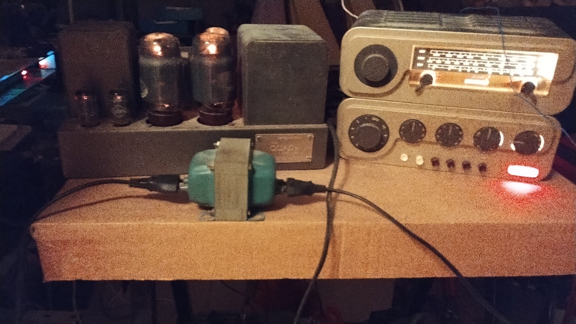

Before I go any further, I´ll post a pic and a video first.
OK, here they are attached now.
I thought it was worse, but apparently it IS doing something, so whatever the noises are, it may be fixable and not too complicated.
Can anything be deduced from the video?

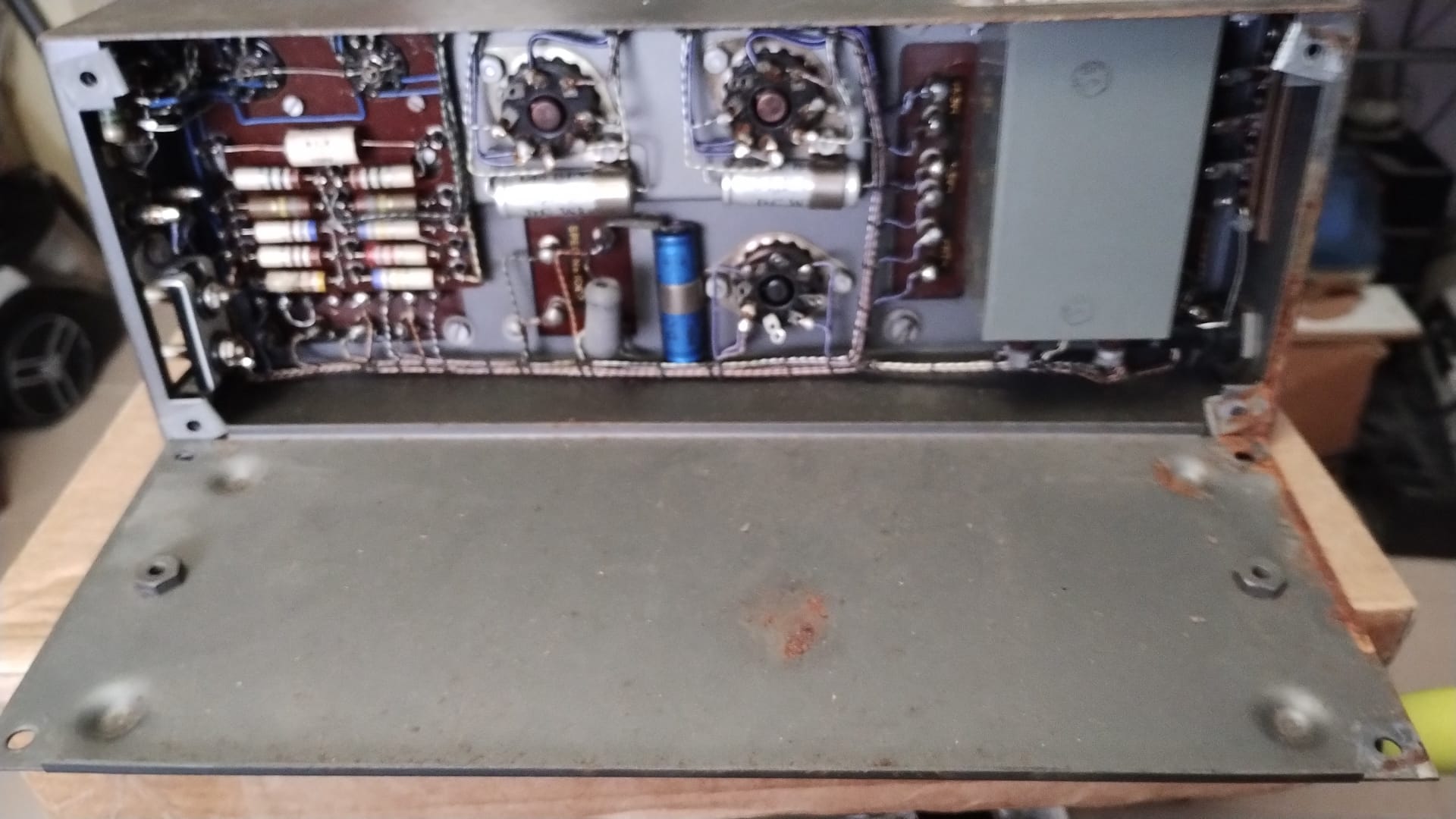

Again, thanks for your attention and recommendations. I´m accumulating your comments on a separate text file to print it out!
Hi OldHector,
Thanks for your thoughts. I know too little about auctioning on the Internet, and my daughter, who´s a computer engineer, will probably skive...

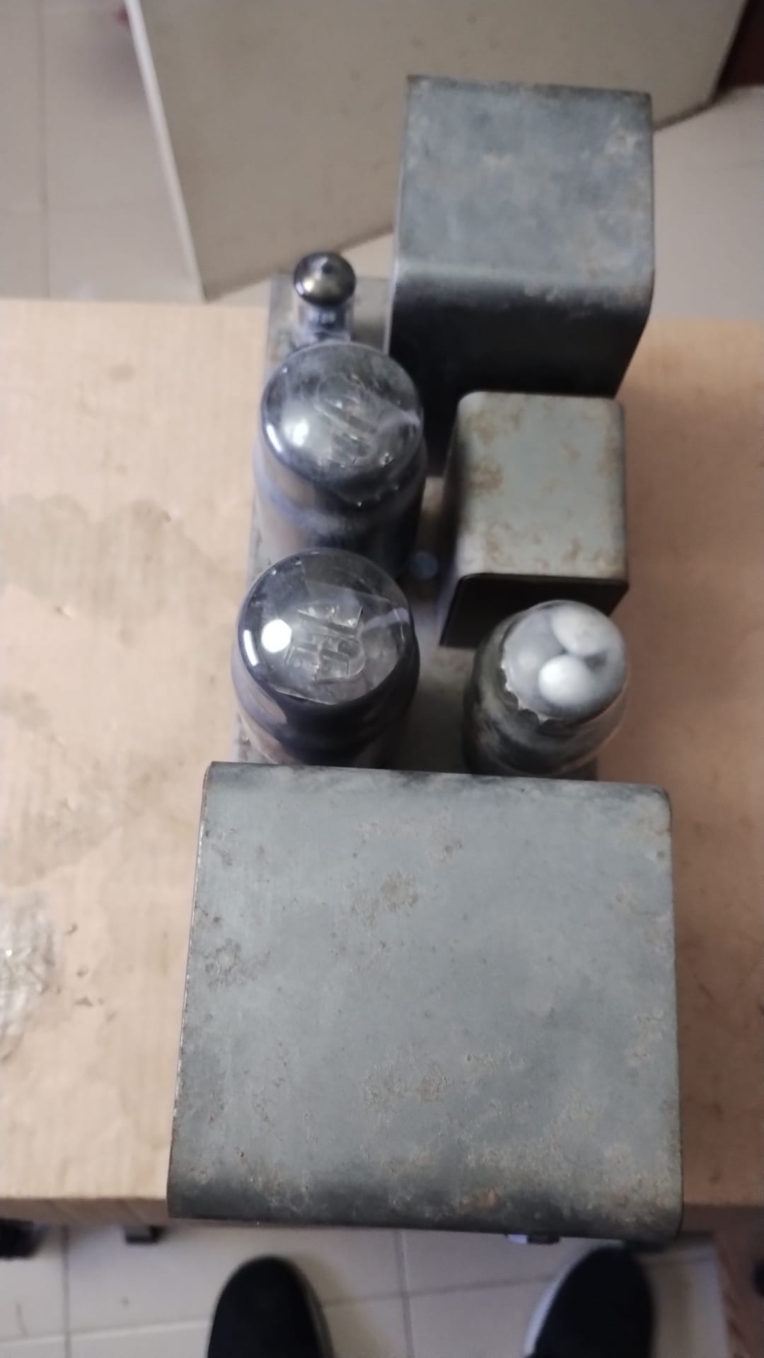

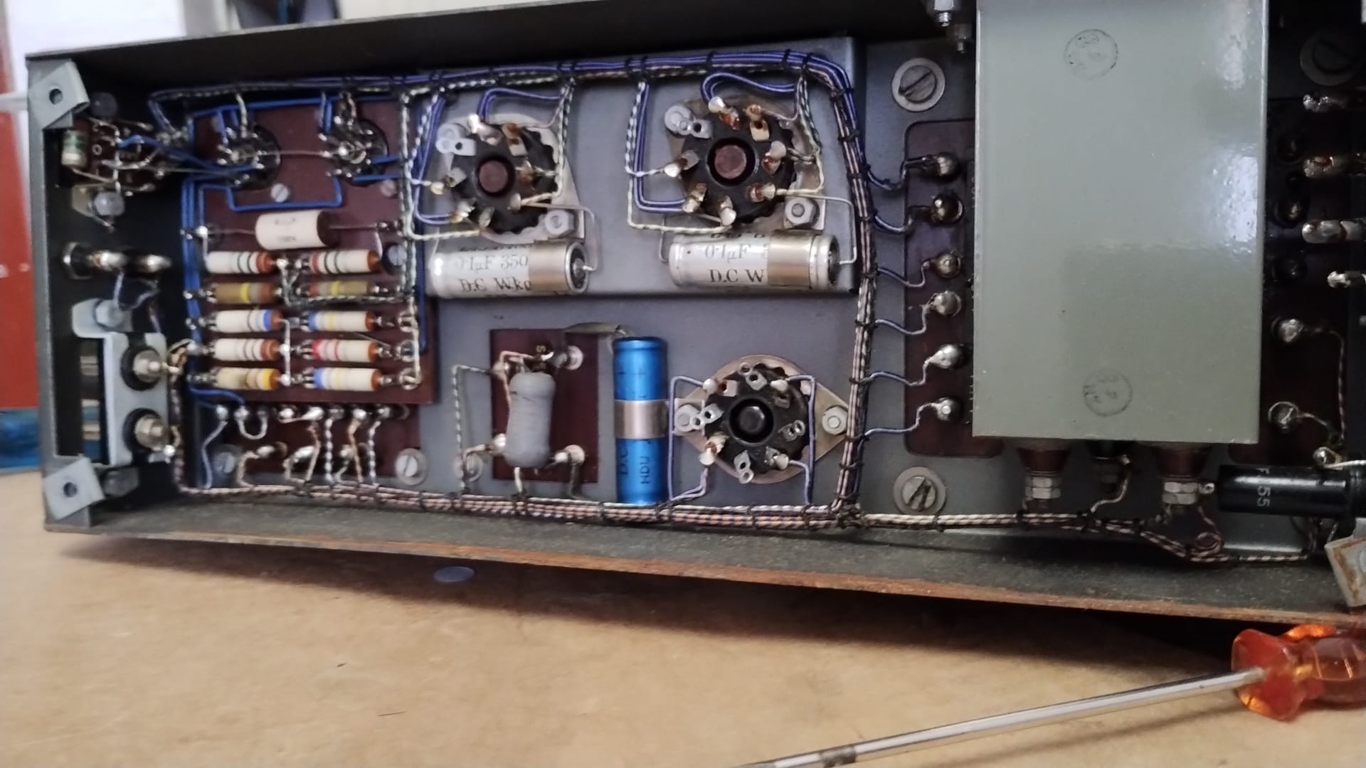

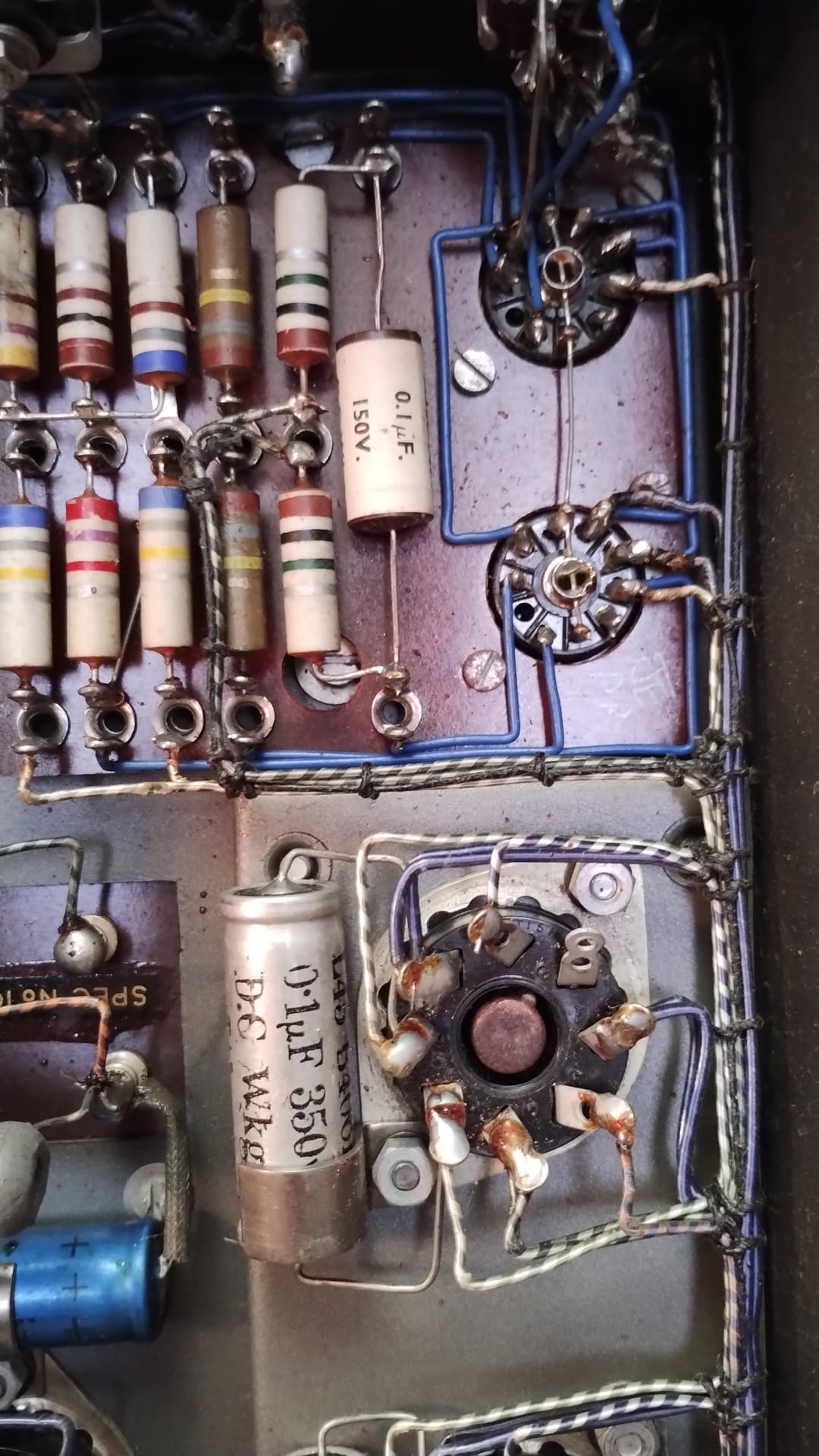

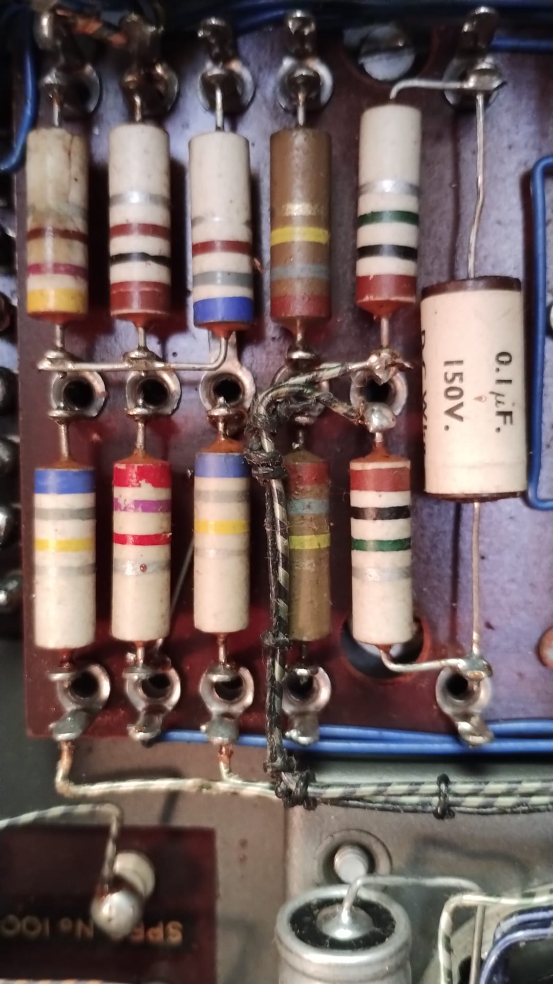

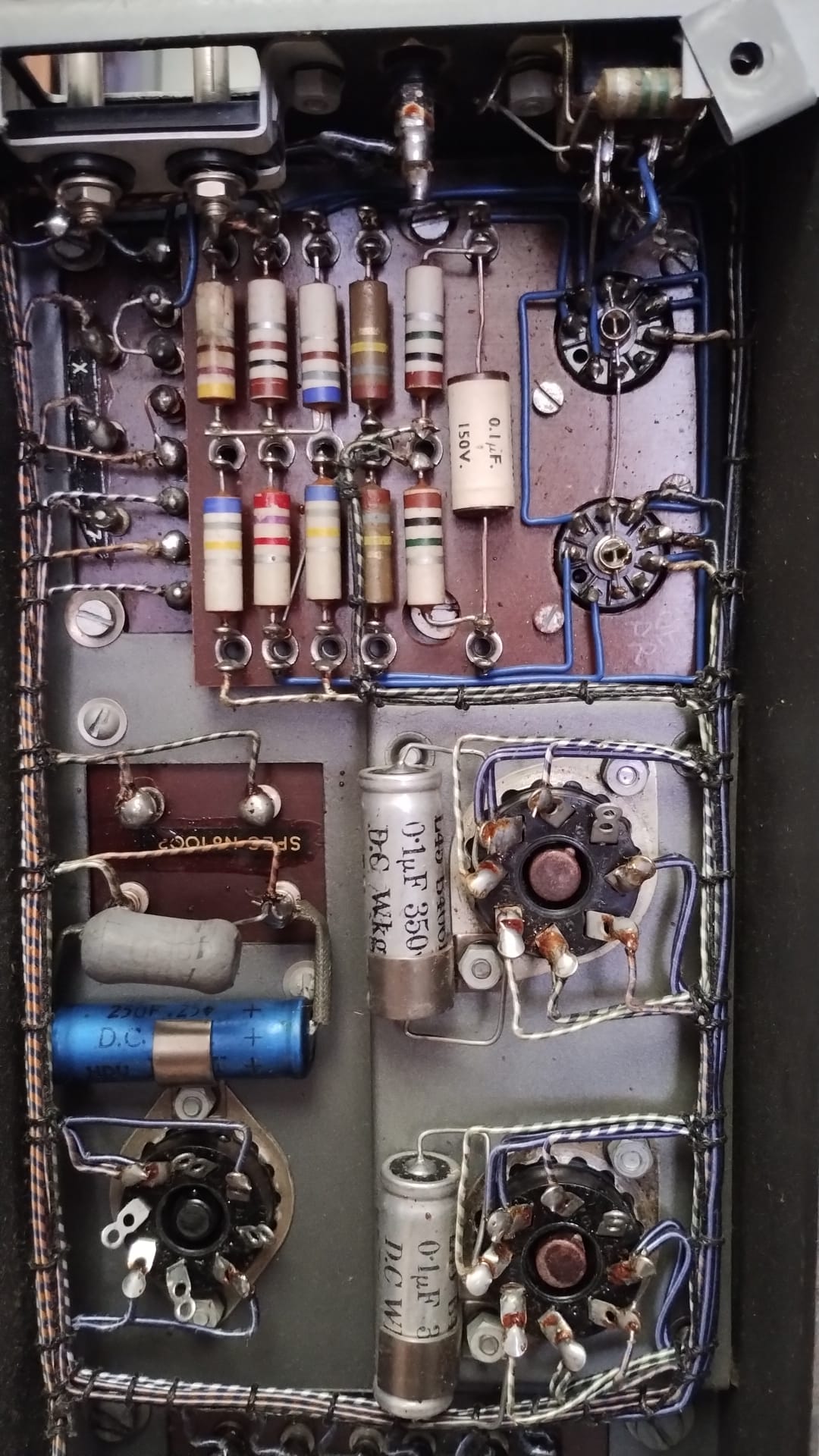

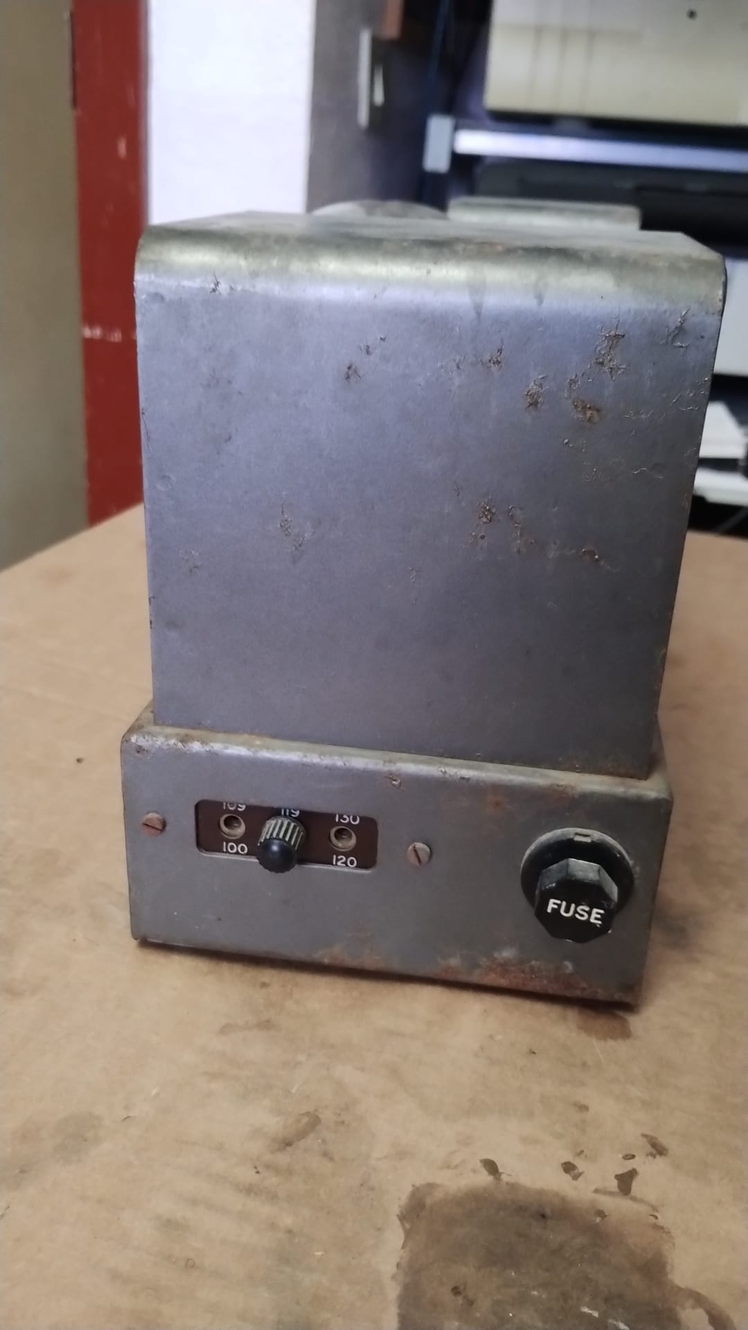

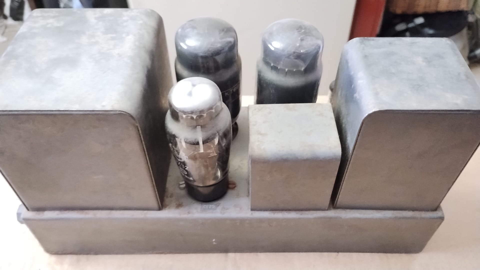

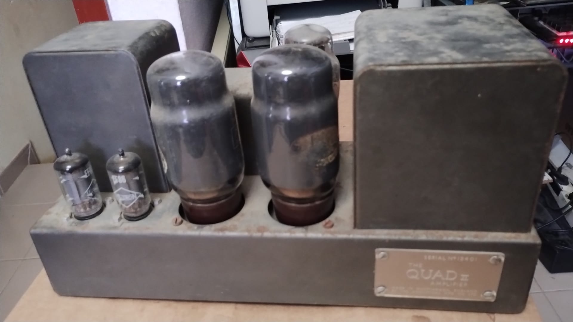

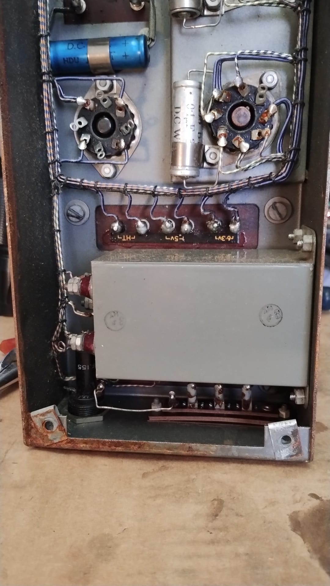

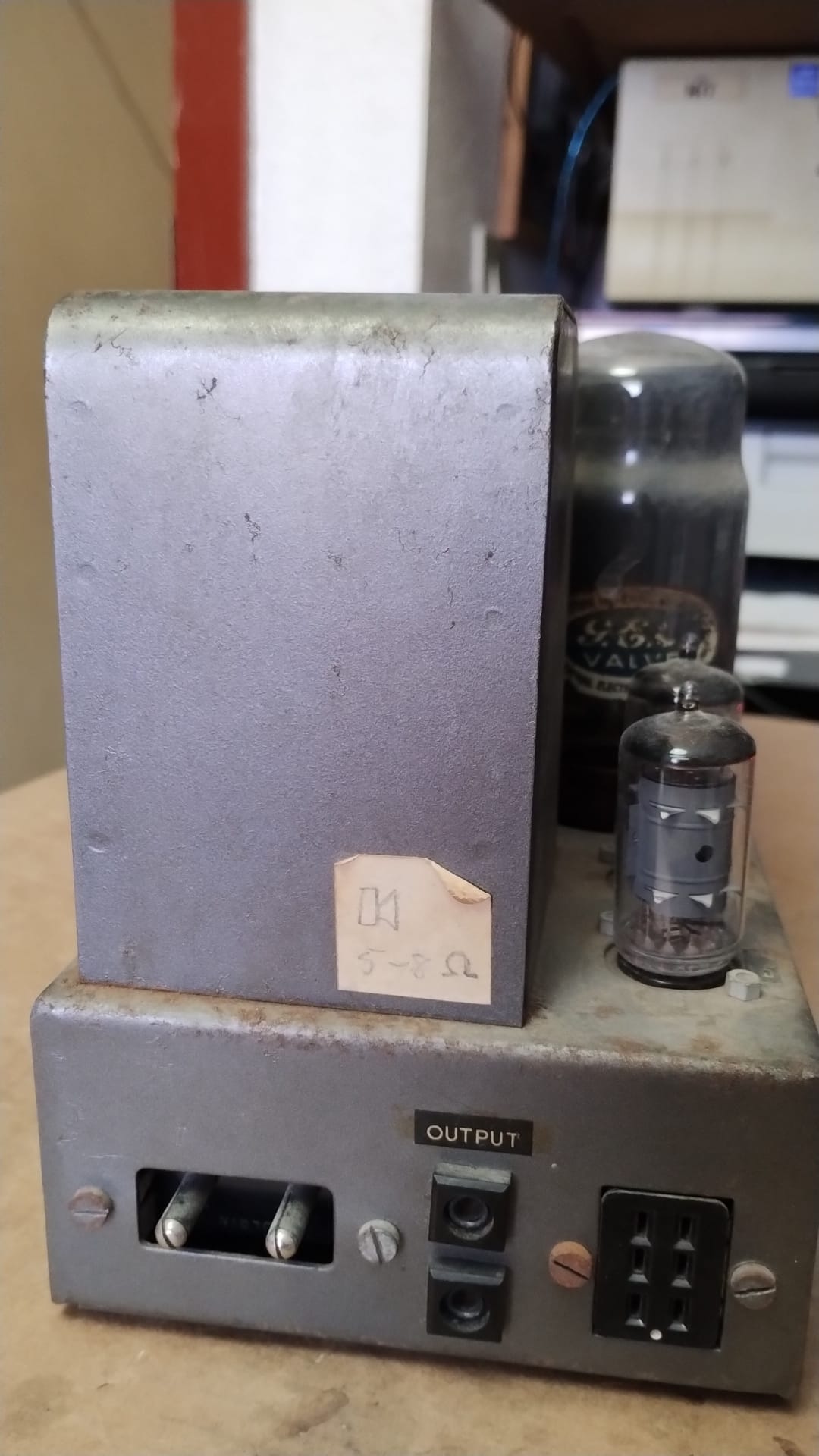

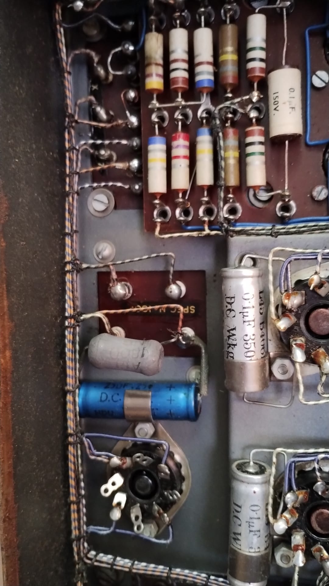

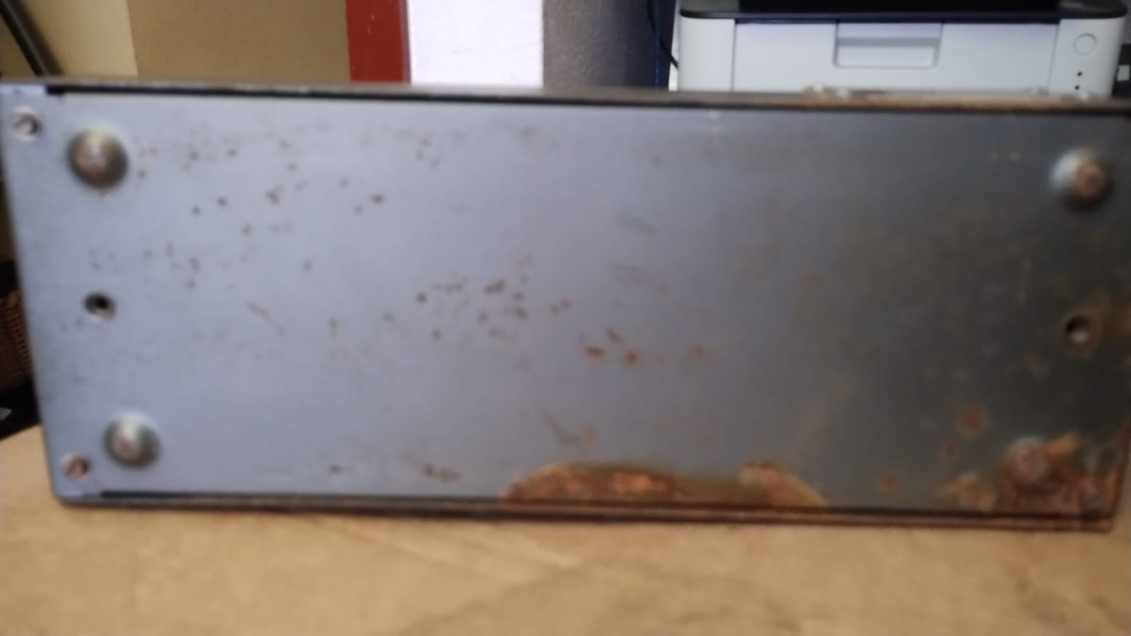

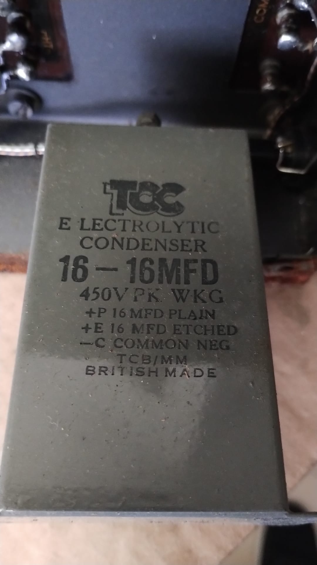

Anyway, here is the first of three parts of Step One: Fourteen Quad-II pictures.
Some show rust, indicating where the water was dripping to and where it went, and others show some possibly cracked or damaged resistors, maybe.
The wiring seems OK, though, in my ignorant opinion...

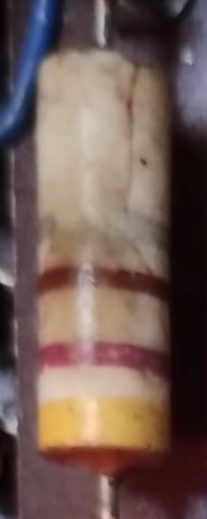

I didn´t make the the picture resolution too high because I don´t know how much this thread can support...
Chgeers,
Aleatorylamp
