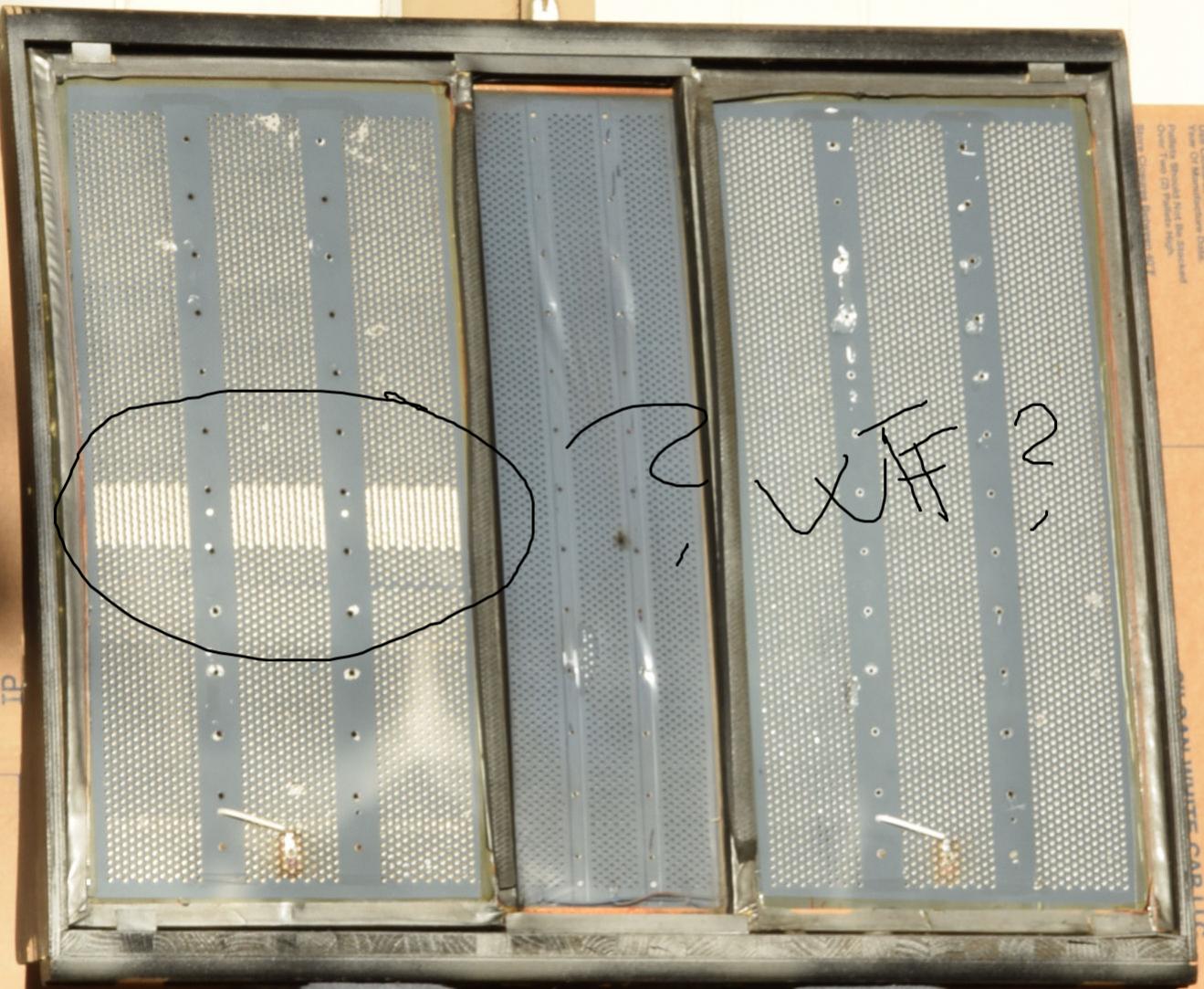

are you sure they where not fixed by some guy that made a mistake 🙂
How? You mean if the user re-punched the panel? 😕

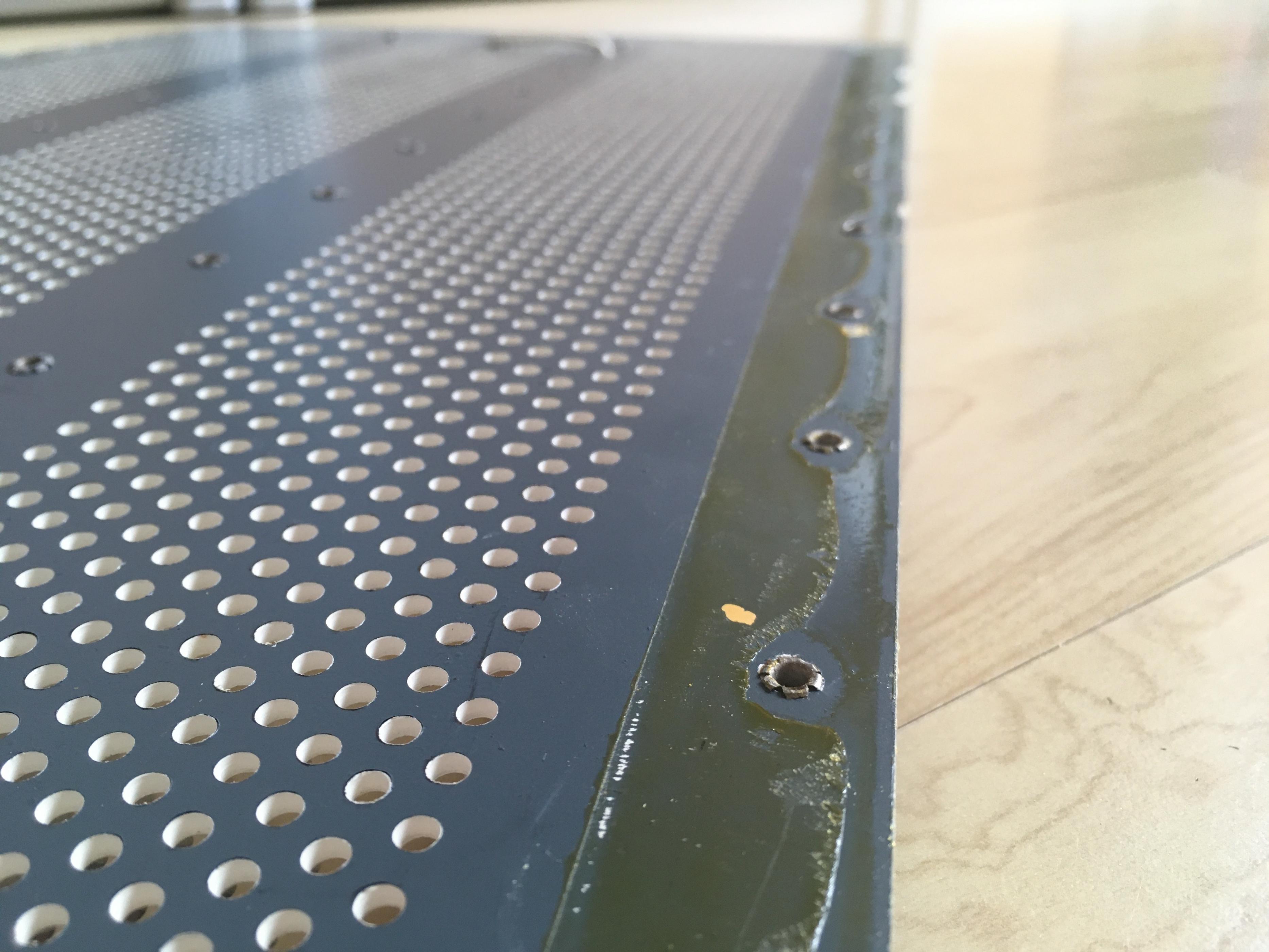

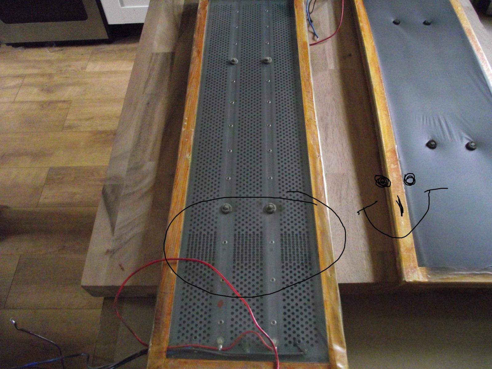

I've seen lots of questionable assembly quality in the original ESL's over my 20+ years of rebuilding those things. Mis-aligned rivets, the pass-through cable that isn't in the central support, but is in the diaphragm space.

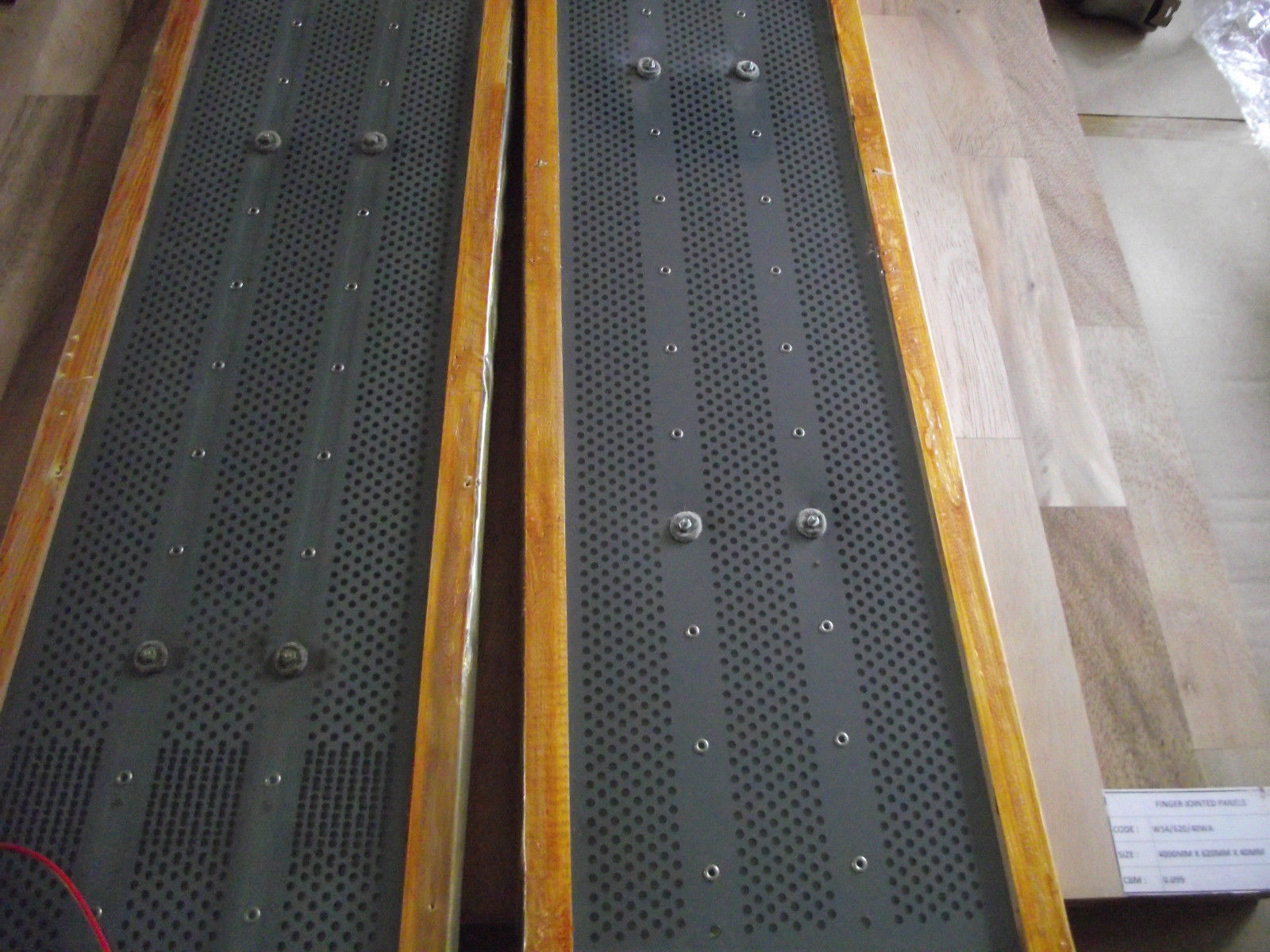

Hahaha. I would gladly see them, if you have any pictures of those 'anomalies'. 😛

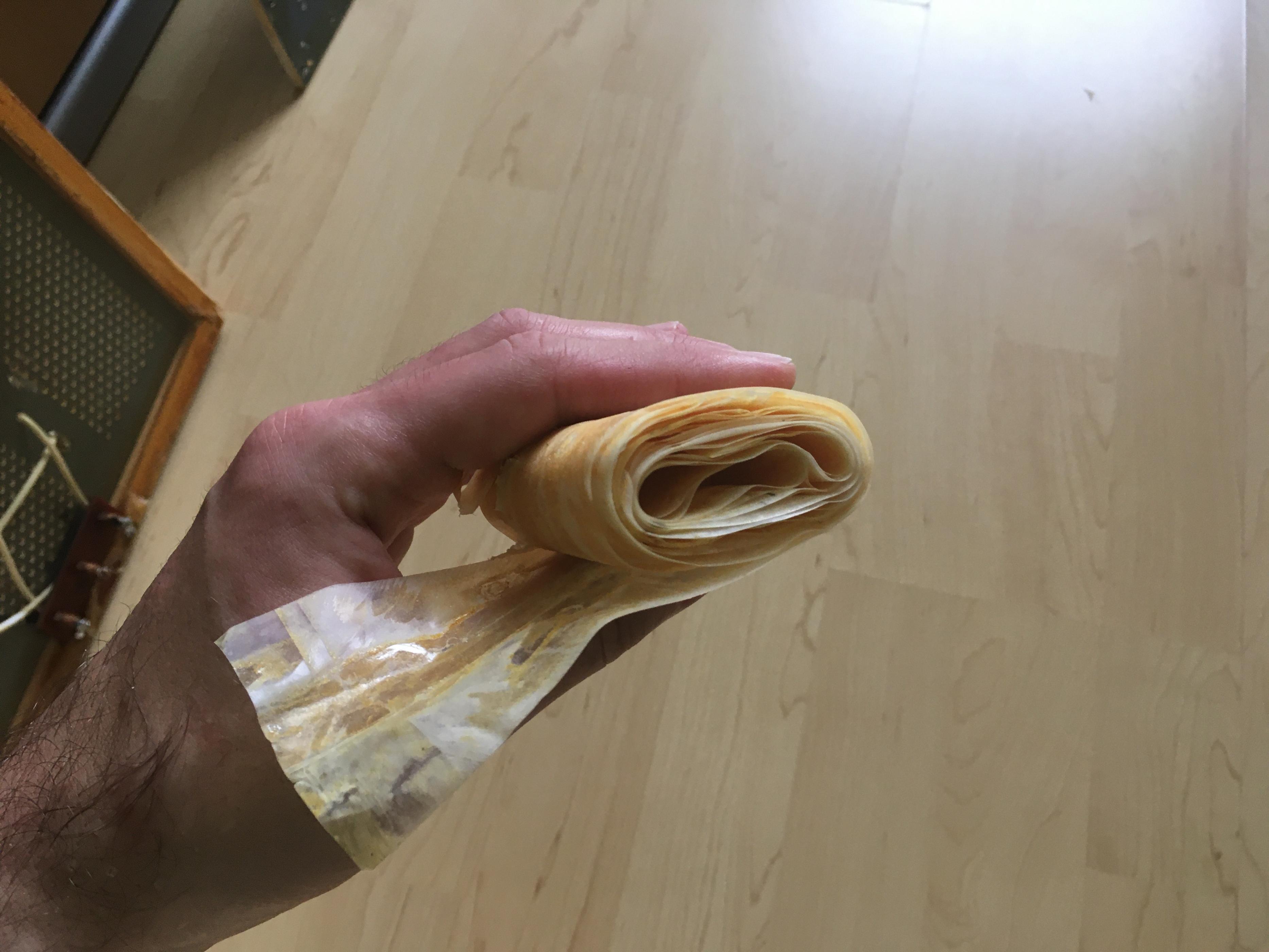

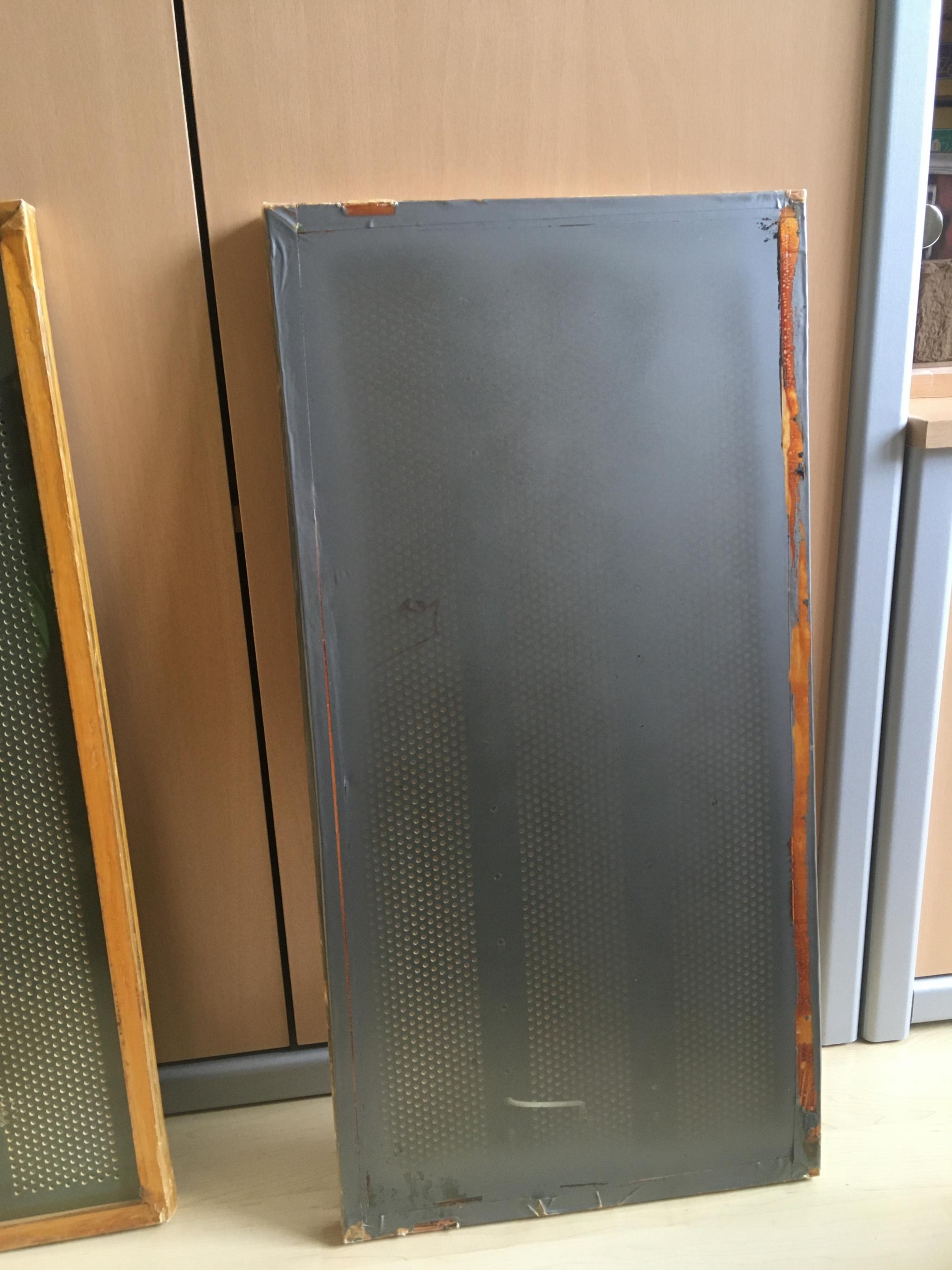

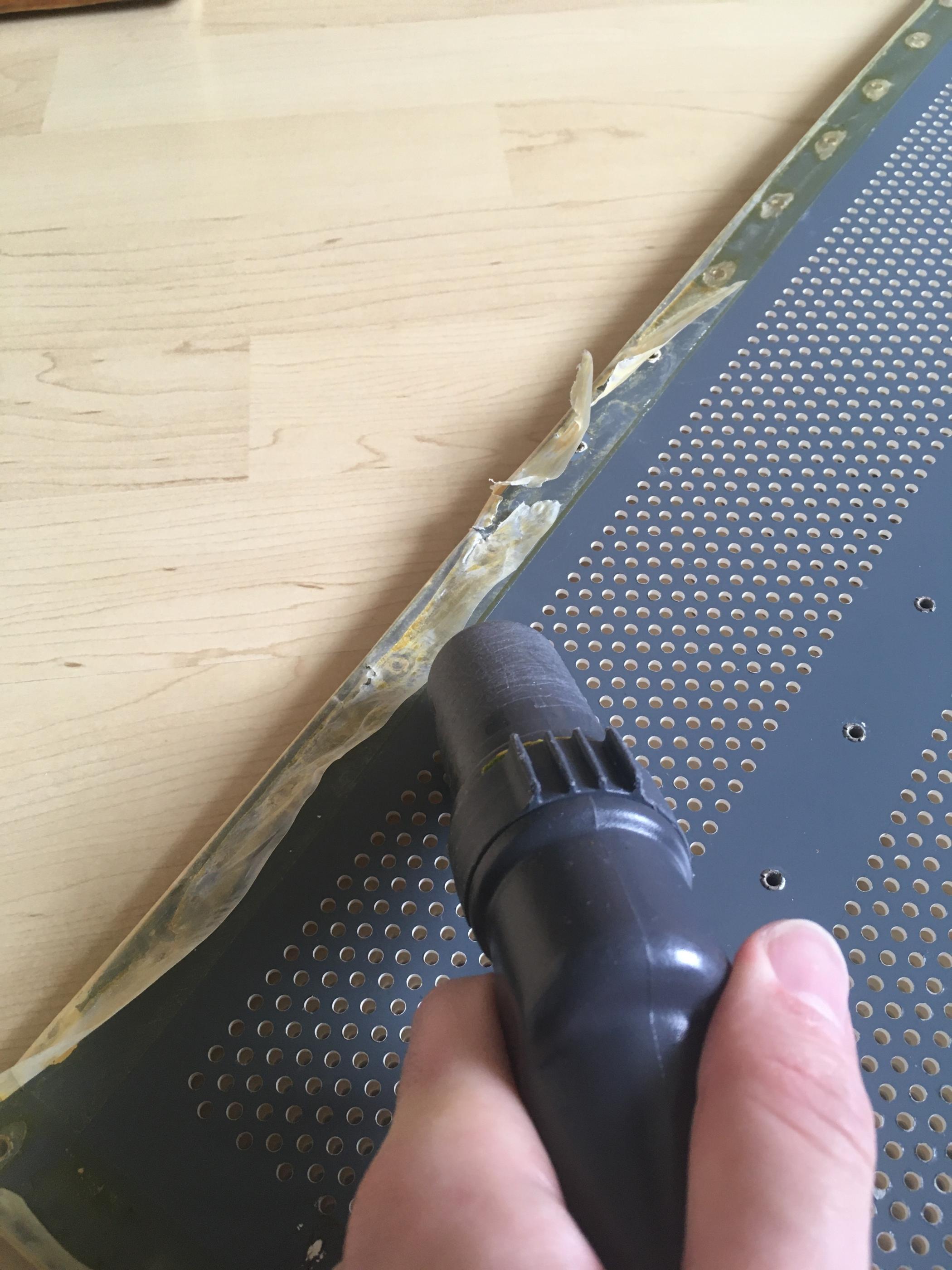

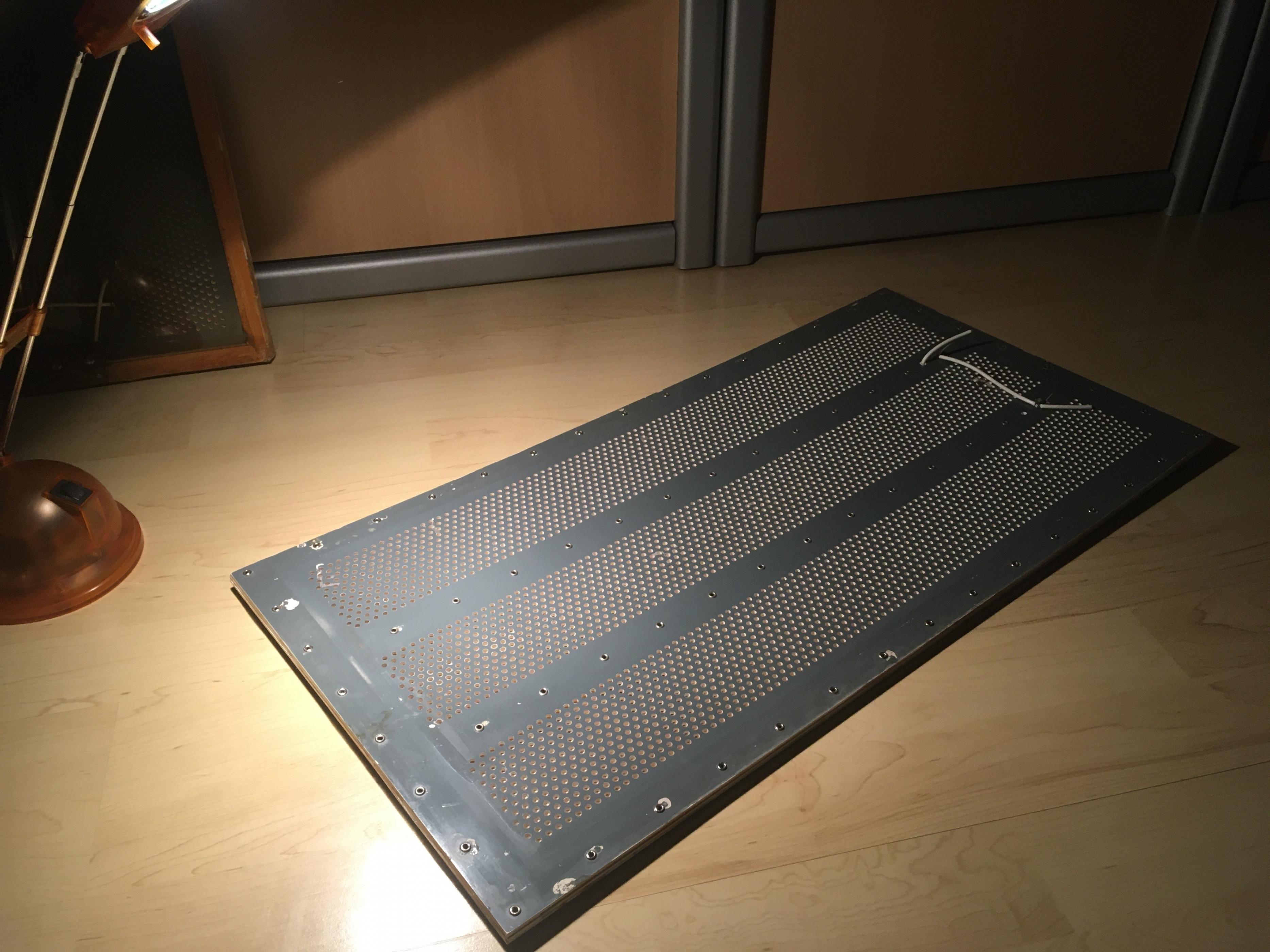

Update on the topic: I've managed to source 3 BASS panels for only 30 EUR/panel, the dustcovers were intact on two, and panels are in good state optically.
I don't know if my analogy is good, but I still can see the conductive nylon coating on the saran through the holes, so I will pick the most matching two of 3, and use these as a substitution of the panels those are more or less faulty or maybe just way too old.
Reason:
Next to the above mentioned symptomps of those BASS panels inside the speaker, I found out with a tone generator, that the panels produce few dBs less around 80-100Hz, and can't go lower than 60Hz as the healthy side could easily, despite those are original panels, too.
I will have to tidy up them a bit, and redo the dustcovers, and I will do the swap
Reason:
