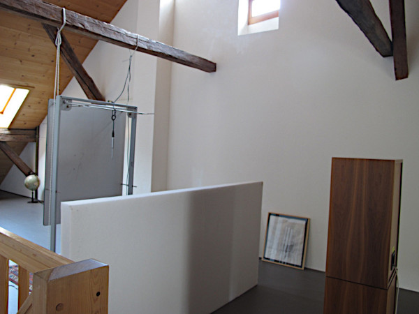

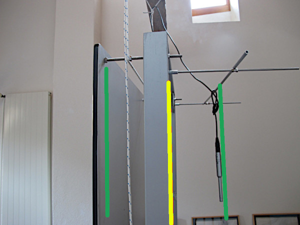

Test setup would include the absorbtive and the reflective property of each dust protector candidate (DPC) under test. I imagine to place everything into a line:
Sound source - Mic - DPC - Flat/plane surface as near-perfect acoustic reflector. The mic would therefore catch first the wavefront of the direct sound, then the wavefront reflected by the DPC, then the reflected and twice partly absorbed wavefront. Reflected by the acoustic reflecting plane, absorbed by the DPC.
