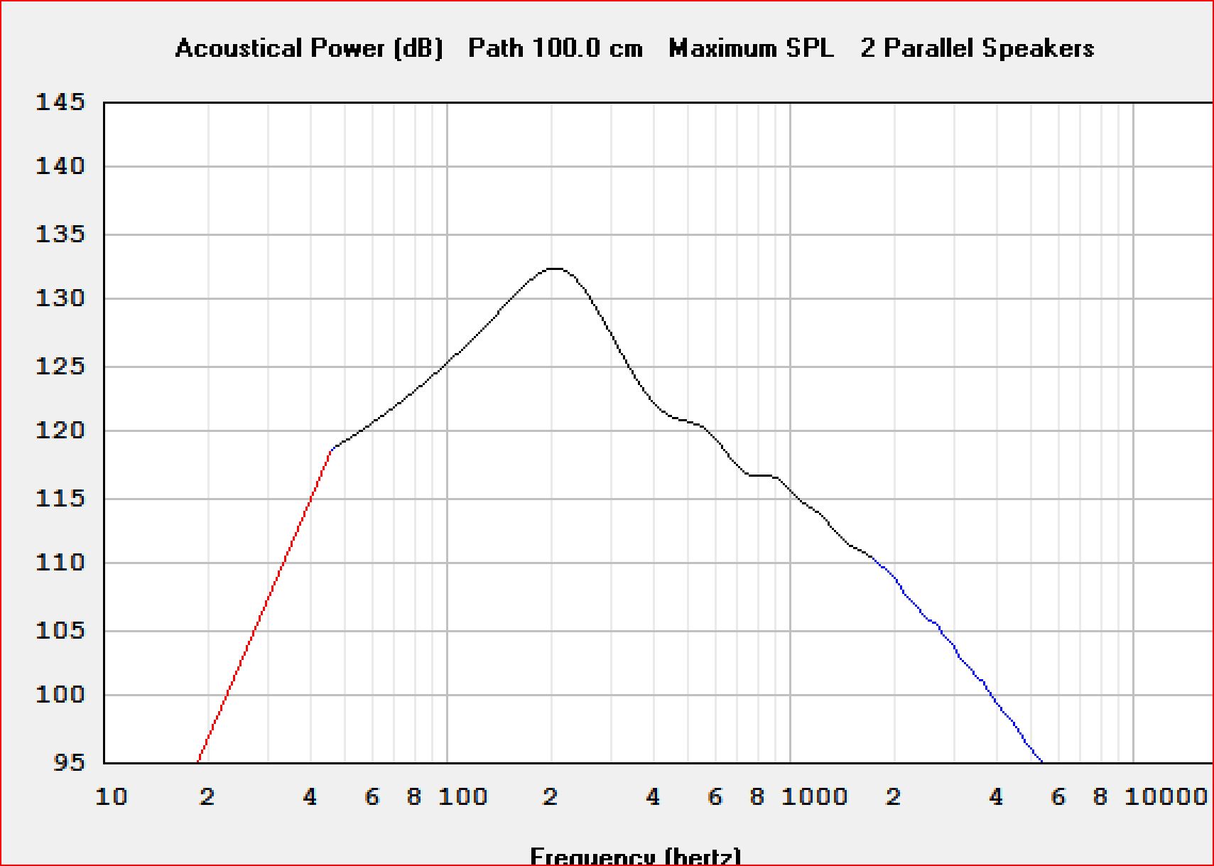

So many options and so many limits on time and budget. H Frame is the name of the game, but I would go with 18" versions that Martin King developed. Those are low mass low excursion drivers that don't shake up the H frame as a smaller high excursion driver will and the added benefit of a lot of surface area to make convincing bass. Or if you want to go whole hog (and who doesn't) you can make 4 and strap the pairs together to make an H Frame Slot Loaded design. Are we having fun yet 🙂
ESL-57
panel dimensions 34"x 28"
One users in room response 30cm, 100cm and 300cm:
but
One solution:
Mount ESL57 on stands allowing mid panel height to be at ear height for best panel sound and conveniently making space for two 15" H-frames each with one AE 15" IB woofers resting on the floor for gain while entirely decoupled from the ESL panels.
Clearly some fairly aggressive equalising will be needed. Digital crossover allows ease of finding the best crossover point. Some may like the crossover around 120Hz for midrange purity but others may want it twice that for a full and weighty sound.
Besides getting bass a big advantage is being able to unload bass from the ESLs and allow them to sing louder with less noise.
