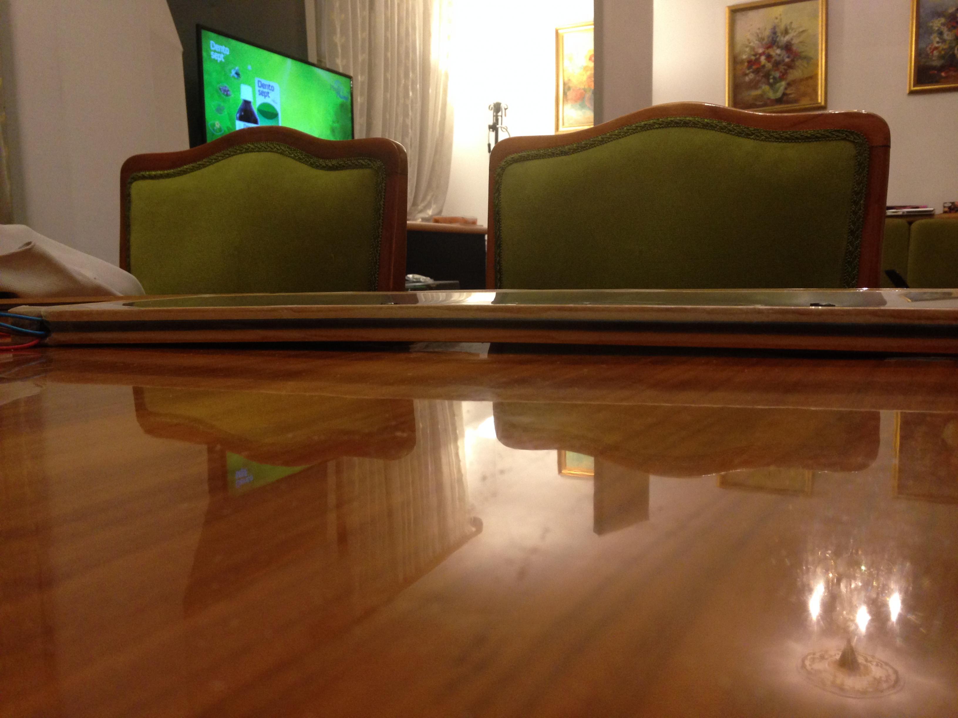

I have received panel from OTA. It appears to be bent - 5mm in the middle. Is it normal?
yes, very normal. If it was flat, you'd have to bend it to that shape to install it in the frames. When rebuilding original panels, the wooden dust cover frames and the plastic stator panels themselves have typically taken a set after decades bent to that shape in the frames. So rather than fight it, I rebuild them such that when bolted back together, they have that same slight arc. The dust covers don't fight you when finishing off the panels that way as well.

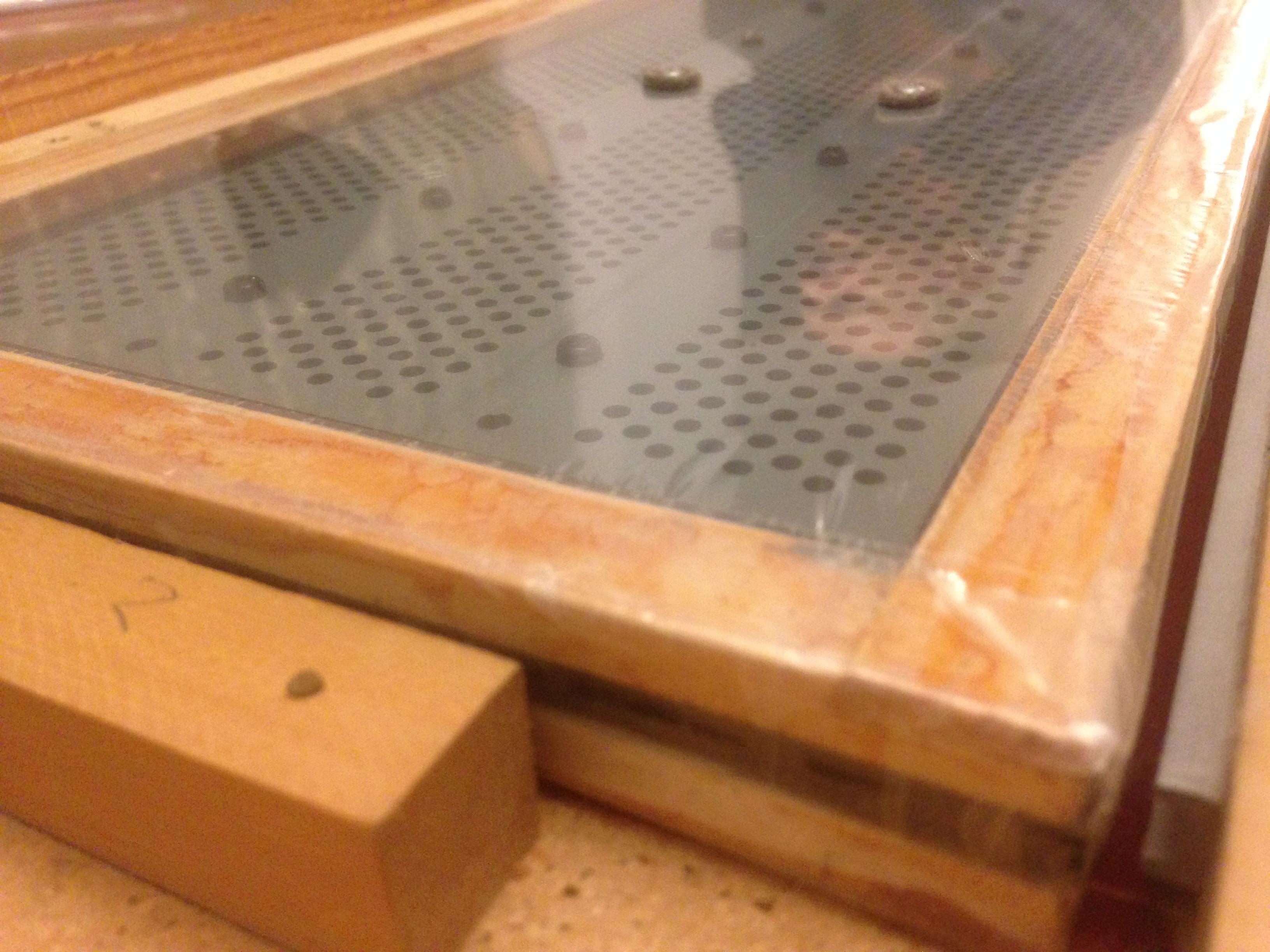

looking at the treble membrane, do you stretch the membrane with higher tensil force "sideways" than on the length?
If you look on the picture you see that the membrane itself bends in two dimensions.
Do you use different force in X versus Y?
So if you built custom (like I have from previous user) based on esl57 panels you should not put any pressure on frames.
