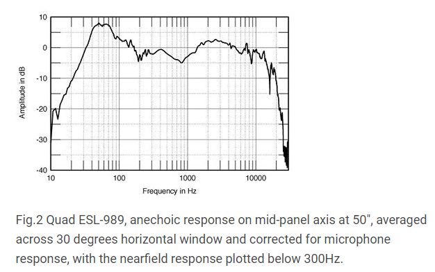

When comparing to a commercial esl like the Quad esl 989, this loudspeaker has an + 8dB resonance peak in a dead-room @ 50 inch mic distance from the loudspeaker. I'm wondering how much this peak would be when measuring close to the loudspeaker (< 10 cm / 4 inch)?
I'm interested in this topic as, as far as I'm aware, Quad loudspeakers don't suffer from severe resonance problems like my own DIY panels do. What did they do to overcome this difficult problem? I've read about felt damping screen for their tweeter panels (esl 57), but I'm curious how bass-resonance is dampened in their current models? Do they use something like a silk mesh screen like I did in my DIY panels? If so, do they apply it on one or both sides? I tried to find more information about this, but was not able to find much about this topic.

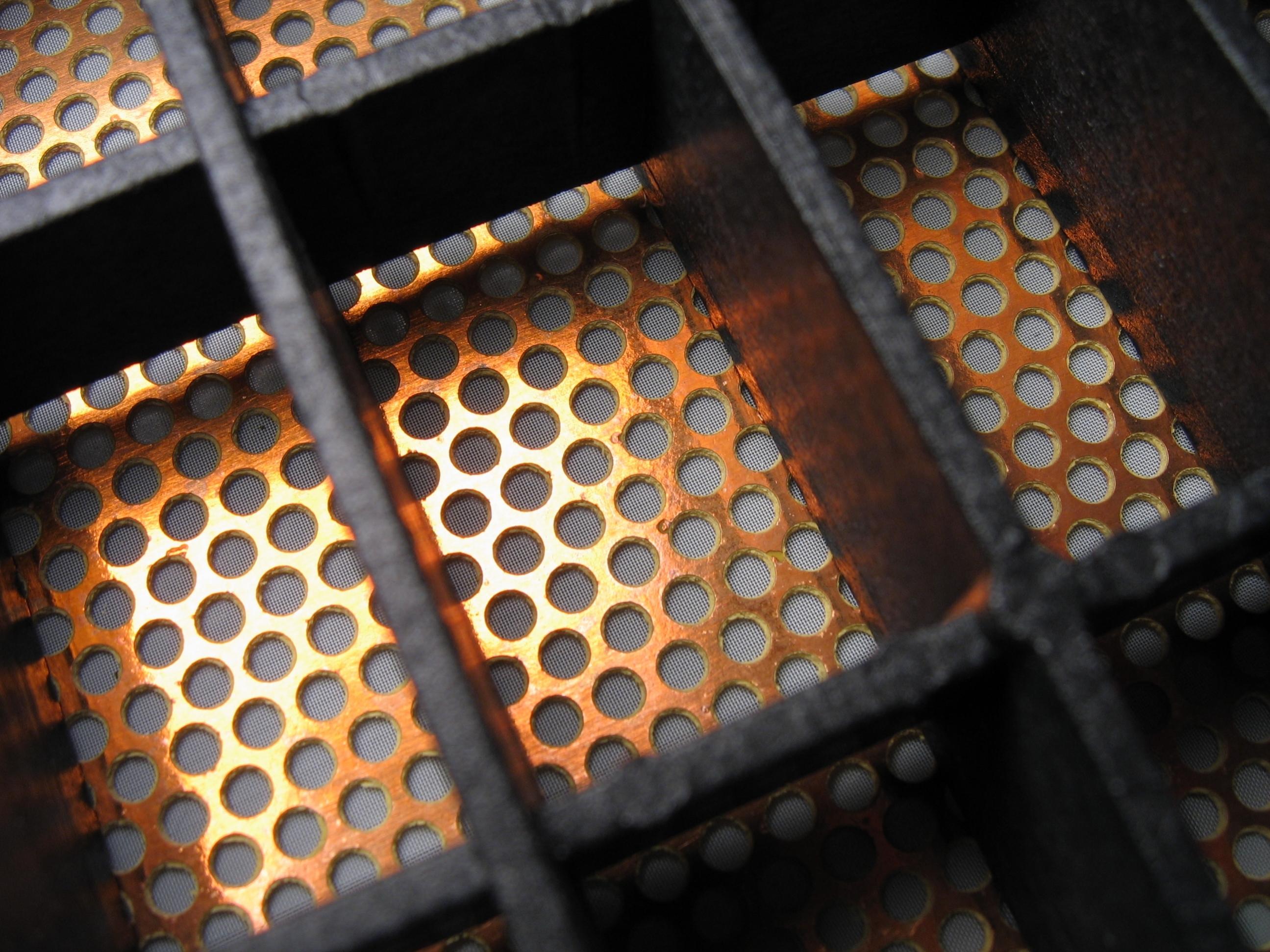

I've never seen the inside of an ESL-989, but in the ESL-63, there are woven screens at the inside of both stators. According to a chapter that Peter Baxandall wrote about the ESL-63s, the resonance is damped to a Q of about 2. That would normally result in a peak of about 6 dB, but it is compensated for by rolling off the driving current with a first-order slope below about 1 octave above the resonance frequency. All in all, you have a kind of third-order Chebyshev alignment.
The dirty secret is all the modern quads are effectively identical (Don't believe the marketing hype), so if you've seen the workings of one, you've seen the workings of all of them.
Yes, there is a fine mesh screen (silkscreening screen I believe)glued to the rear stator of each panel. It does damp out the resonance nicely, but as noted, not completely. The rise in response combined with the dropping drive level extends the bass response and then it falls rapidly below resonance.
Sheldon
Here's a picture of the stator/damping screen I took a while back. It's an old ESL-63 panel, but as Sheldon said, the basics of these bits have been mostly constant.
And here's a Quad ESL-989 frequency response plot from Stereophile that uses nearfield measurement below 300 Hz.
Quad ESL-989 electrostatic loudspeaker Measurements | Stereophile.com

On the panel I have, the screen/mesh is only on one stator.
Sheldon's post also says the damping screen is on the rear stator only.
This rebuild shows the same:
Quad ESL repair by Hey You
I thought it was on both, but it has been years since I last saw an ESL-63 panel, so I probably misremembered.
By the way, according to Baxandall, it was a deliberate choice to damp to a Q of 2 rather than the Q of 1 that would be needed for a third-order Butterworth alignment. With a Q of 2, the current could be rolled off an octave higher which resulted in a better sensitivity (86 dB for 2.83 V, extrapolated to 1 m rather than only 80 dB). So it's a compromise between ripple in the frequency response and sensitivity.
