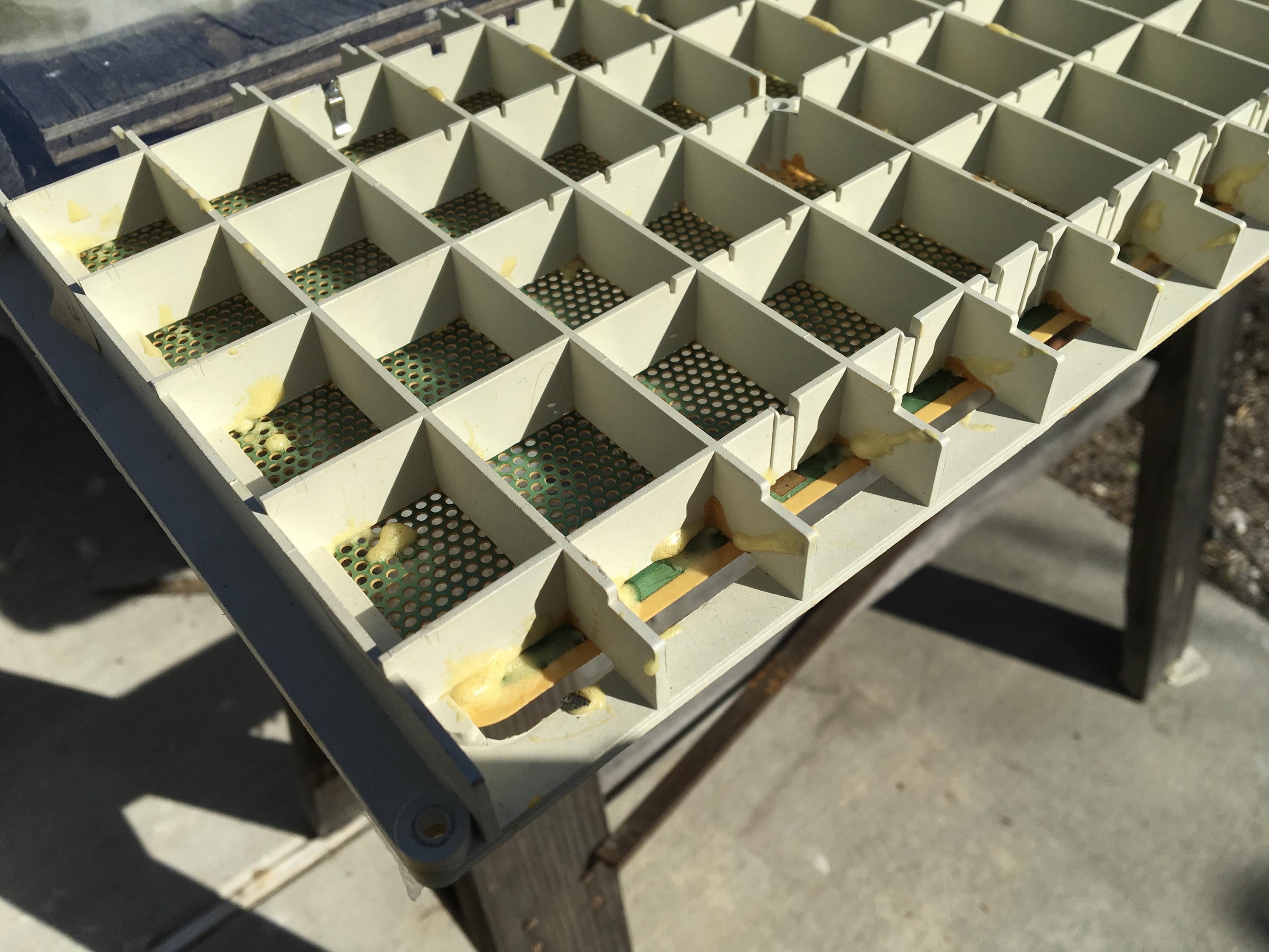

When I rebuilt my 988,s I purchased 3 extra panels from Europe to rebuild as extras and this is one of them ,,., too funny
The problem is since they are starting to go, even if you were to do a better job than this, you can easily push on what appears to be solid sections of the stator,
only to find their barely hanging on
Sheldon has a YouTube video somewhere demonstrating this
