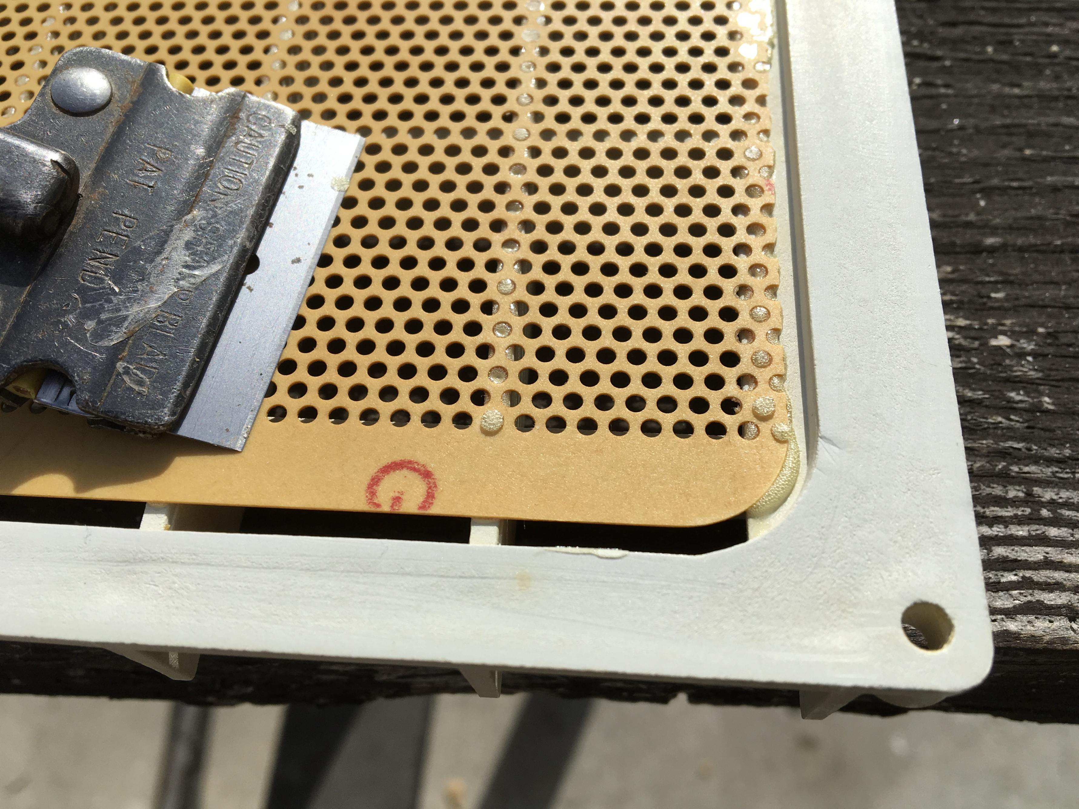

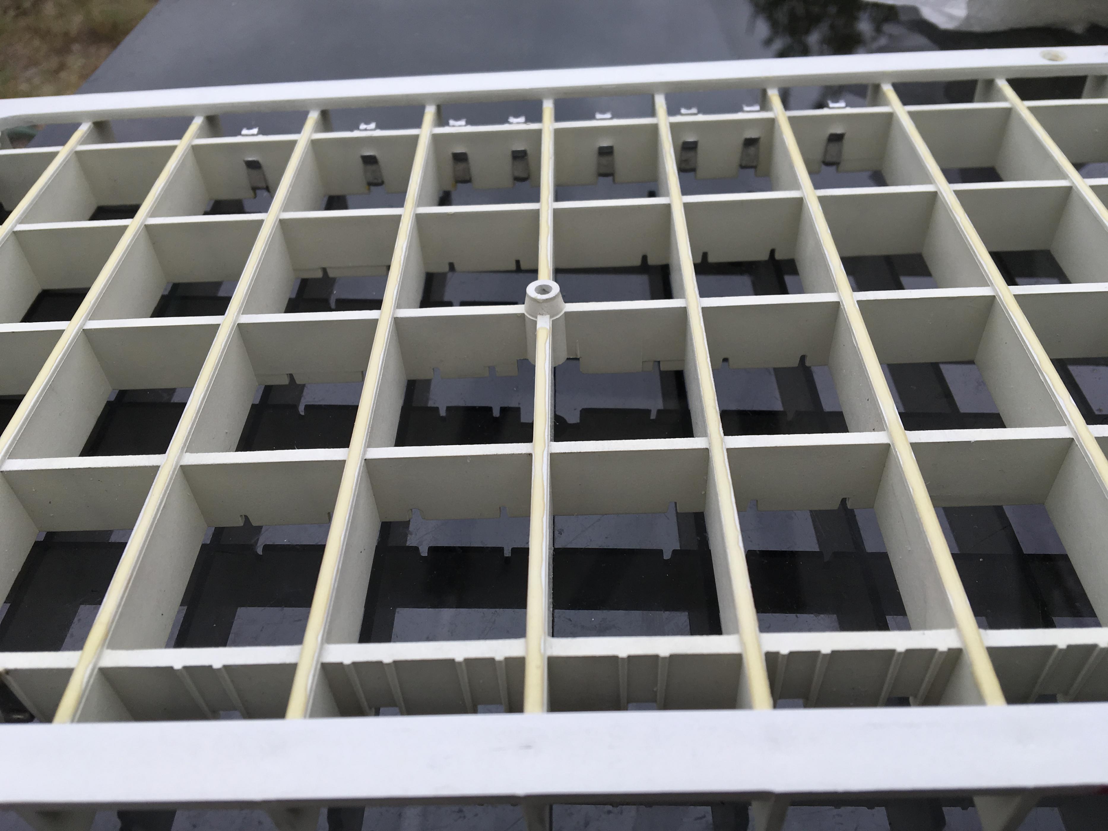

I used gorrilla glue on the mylar and it does expand about 20% or so.
I made a channel with a edge guide so I would distribute the glue equally in quantity and just to the outside of centerline.
If you look close you can see a progressive V to get the amount just right
I made one panel with a low free air resonance and it was very difficult to scrape it off to start over.
I wouldnt use double sided tape as you cant rely on it keeping proper tension over time. You want staying power of epoxy or poly.
Also If you groove the glue tip it acts as a guide on the stator grid and you want the expansion thru the holes for additional grip.

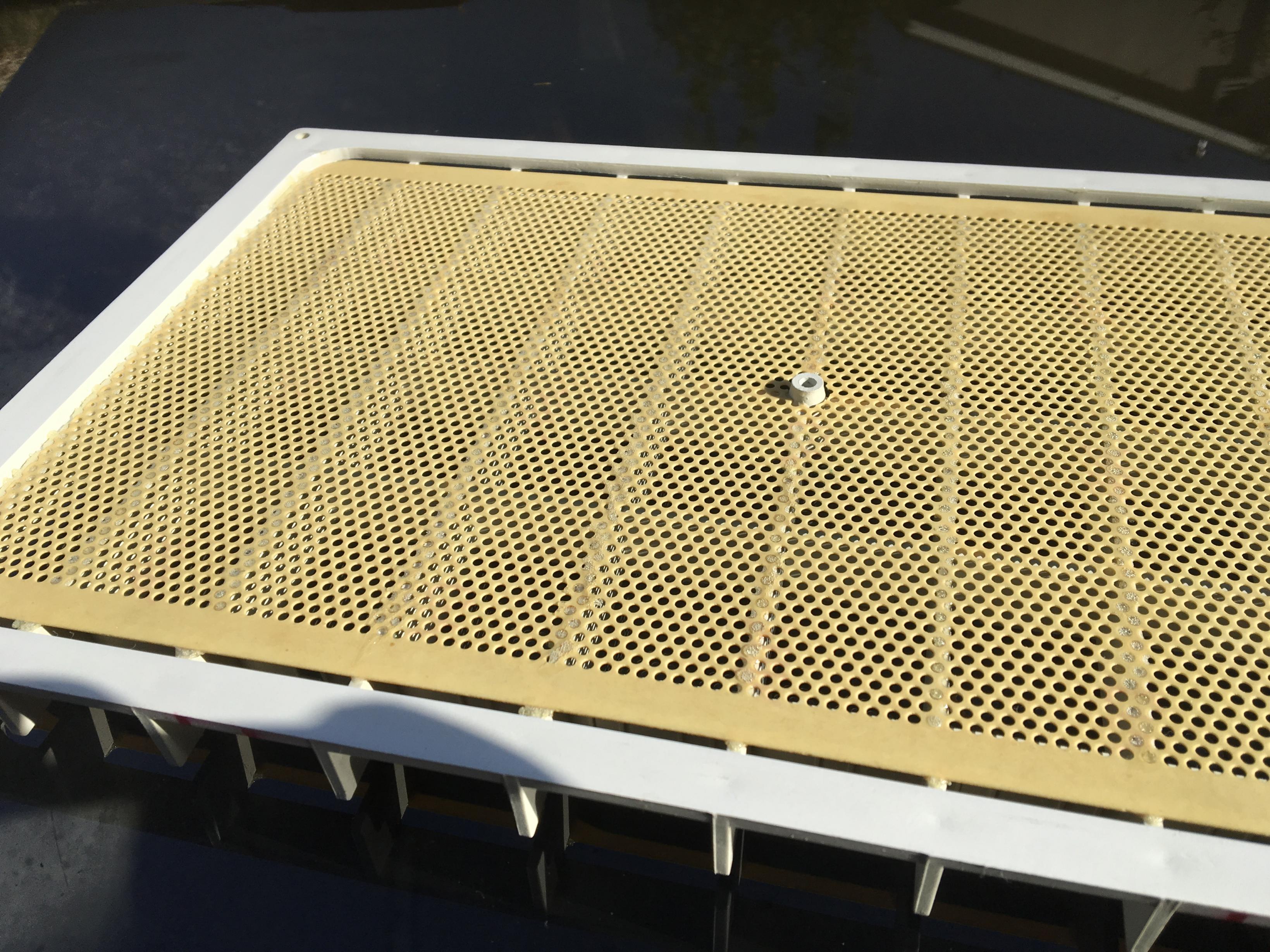

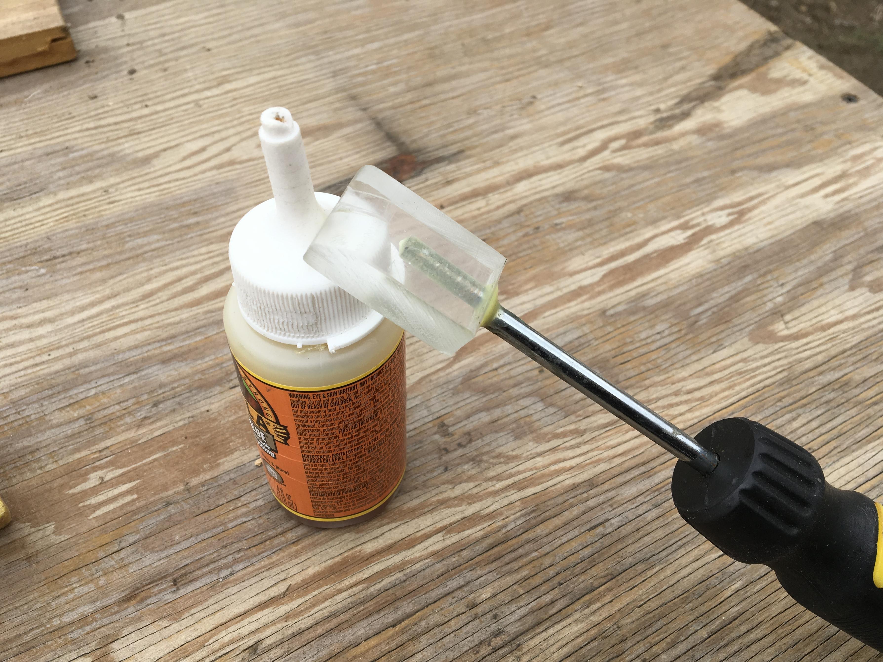

Yes on the film and a good point being quick although I kept a close watch on the air pressure and it was stable with no leaks
On the stator I found the gorilla glue bought more time to get an even amount with proper
expansion right up into the holes with more surface area grip.
Grooving the bottle tip allowed you to dispense an even amount and automatically guides itself.
Trying to apply 5 minute epoxy without some kind of guide system on the stator at least while drive you drink..
You are correct, on the stators, polyurethane glue is the only way to go. If you don't like the bottle technique, another good way is with a foam brush. you can get a nice thin coat that won't bleed through the stators.
