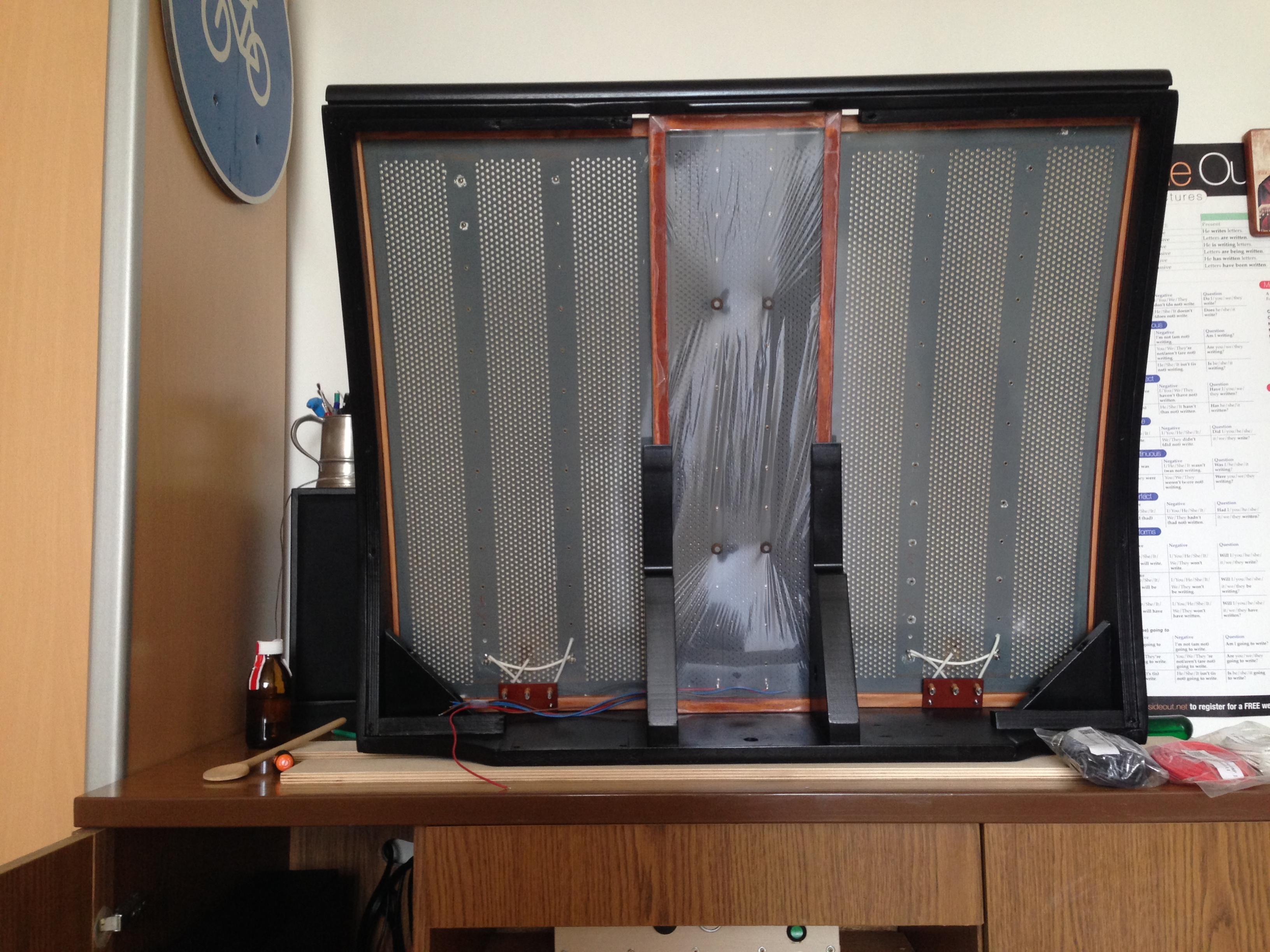

Thank you for your help. Well, I am quite sure that this must be some kind of leakage or EHT failure, can't be the dustcovers as I've just refurbished both speakers with brand new dustcovers, and I sealed it tight and nice.
This problem's present both bass panels at the same time, maybe this could be a lead..

... Well, I am quite sure that this must be some kind of leakage or EHT failure, can't be the dustcovers as I've just refurbished both speakers with brand new dustcovers, and I sealed it tight and nice...

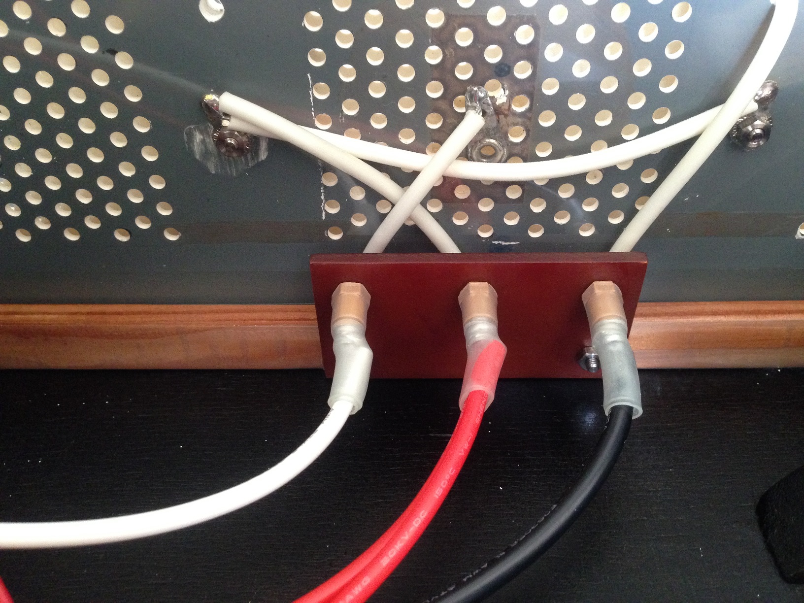

Did you do a good cleaning of all the wiring inside? Accumulated debris can act as a bypass for the EHT.

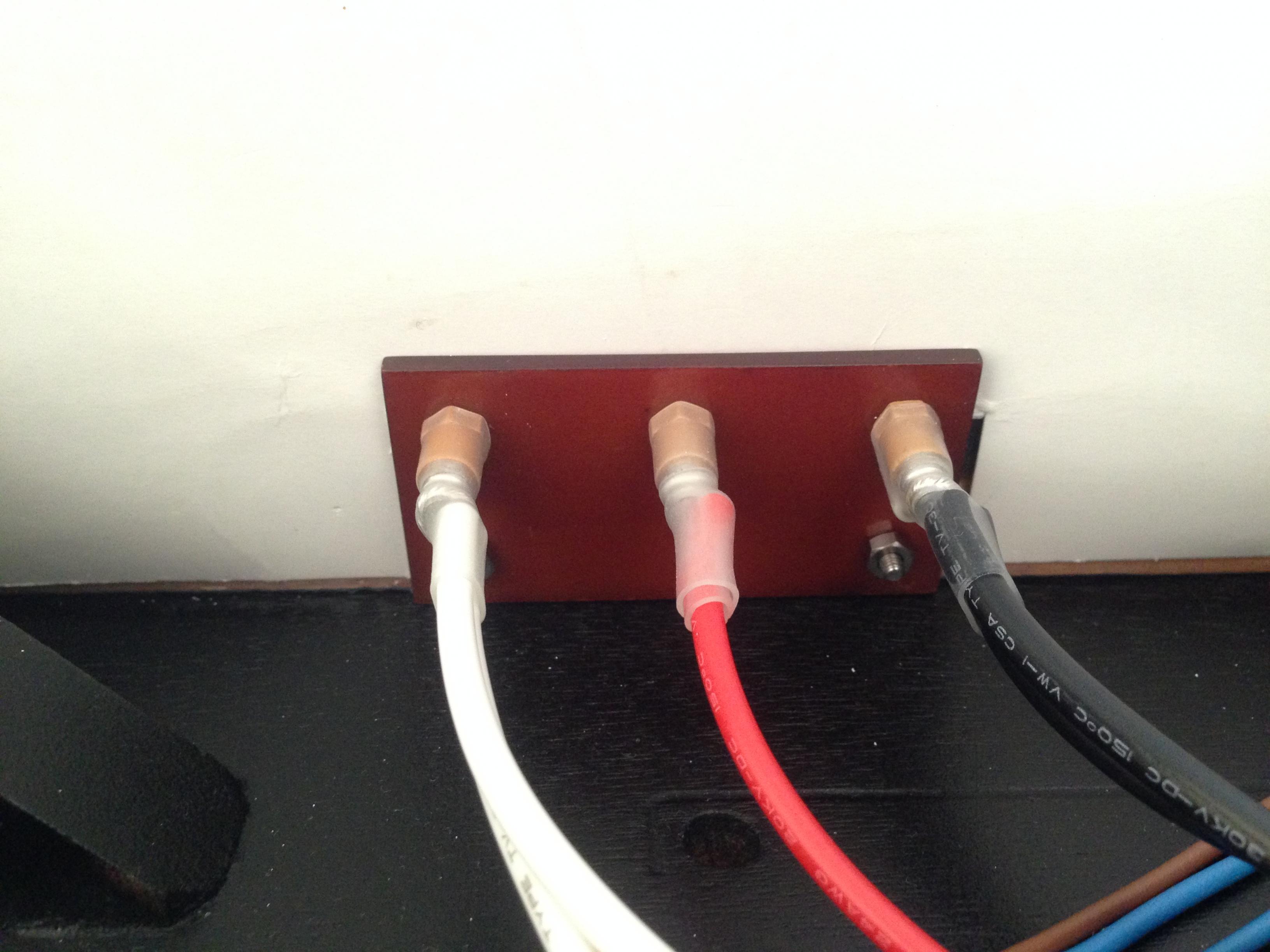

Did you do a in-depth check of all the solderings from the EHT unit to the panel? The Quad manual suggests all solderings should be rounded (like a bead) to prevent Corona effect.

Last year. I was as careful and precise as I could, regarding soldering tasks, too.

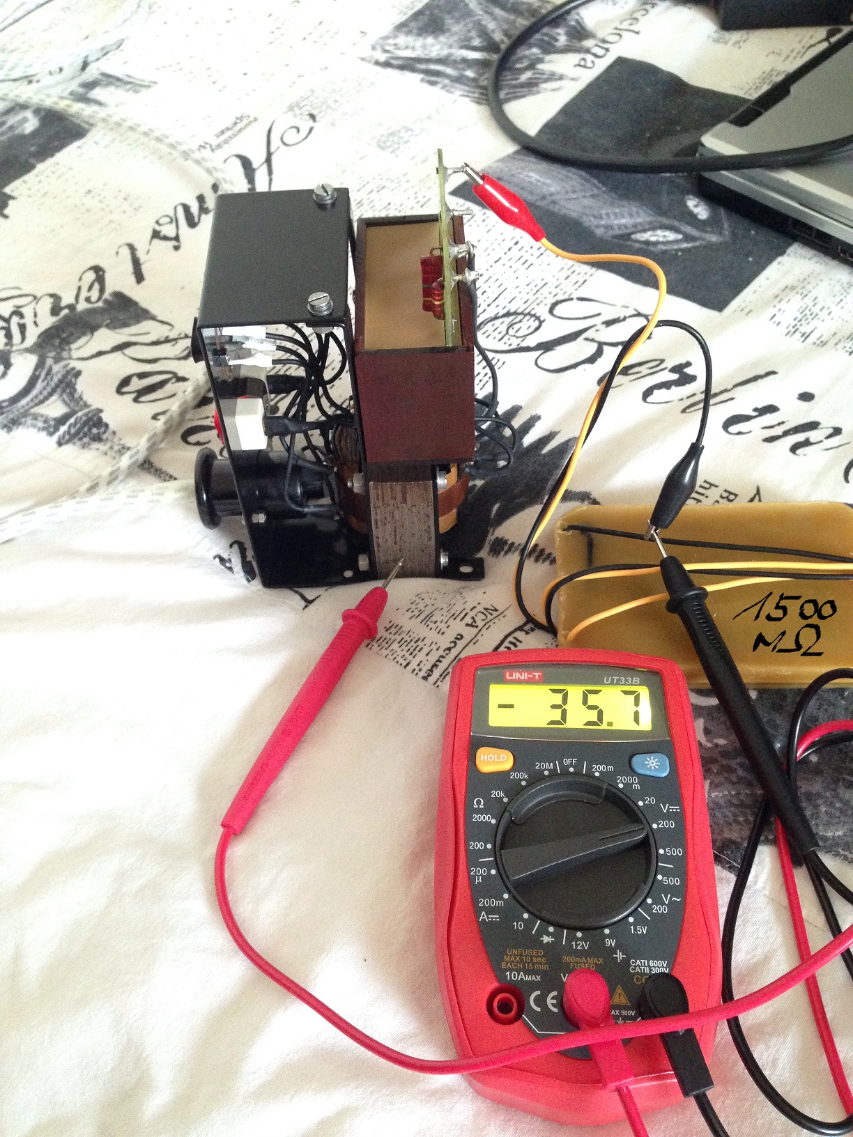

Maybe, or maybe build a probe with 5-10 giga-ohms resistor.
Or rebuild the whole EHT unit: only fairly standard parts inside.
Great job, very clean units. I'd do a few more runs of hair dryer to fully tension the tweeter dust cover, but this is not related to your problem.

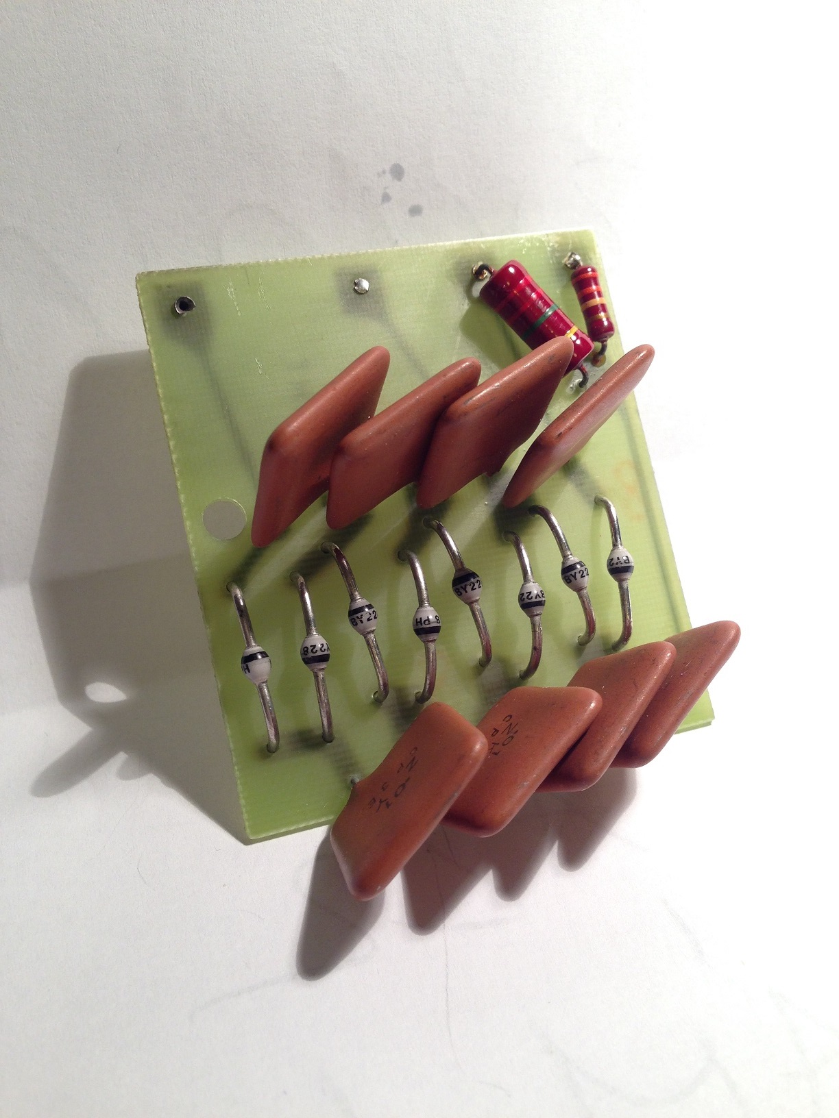

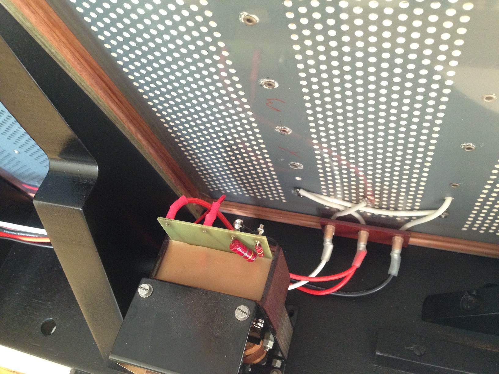

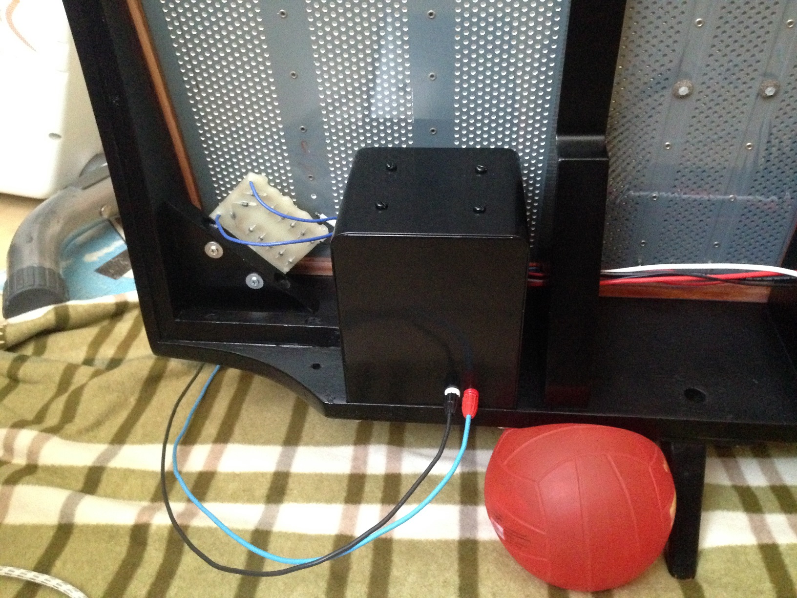

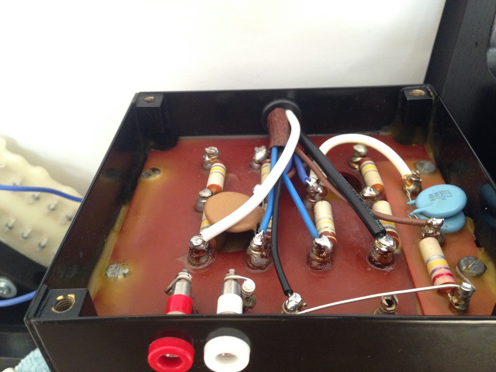

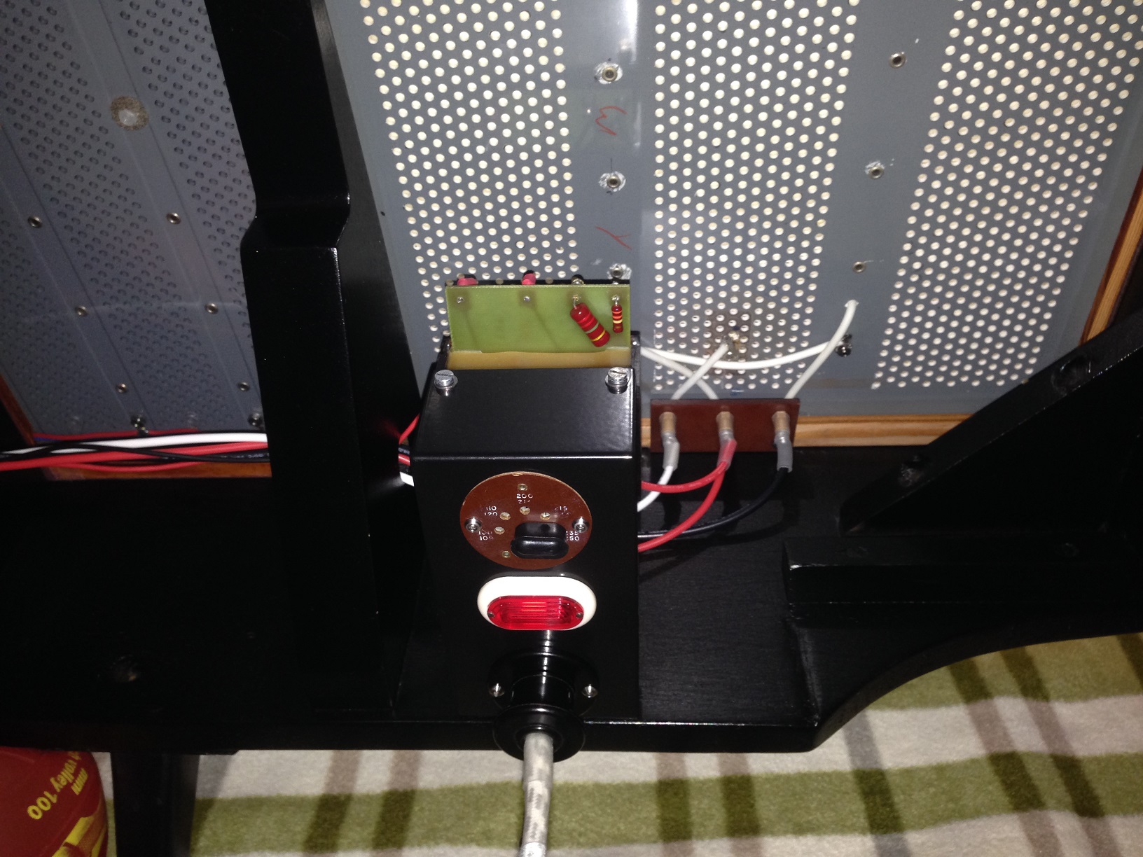

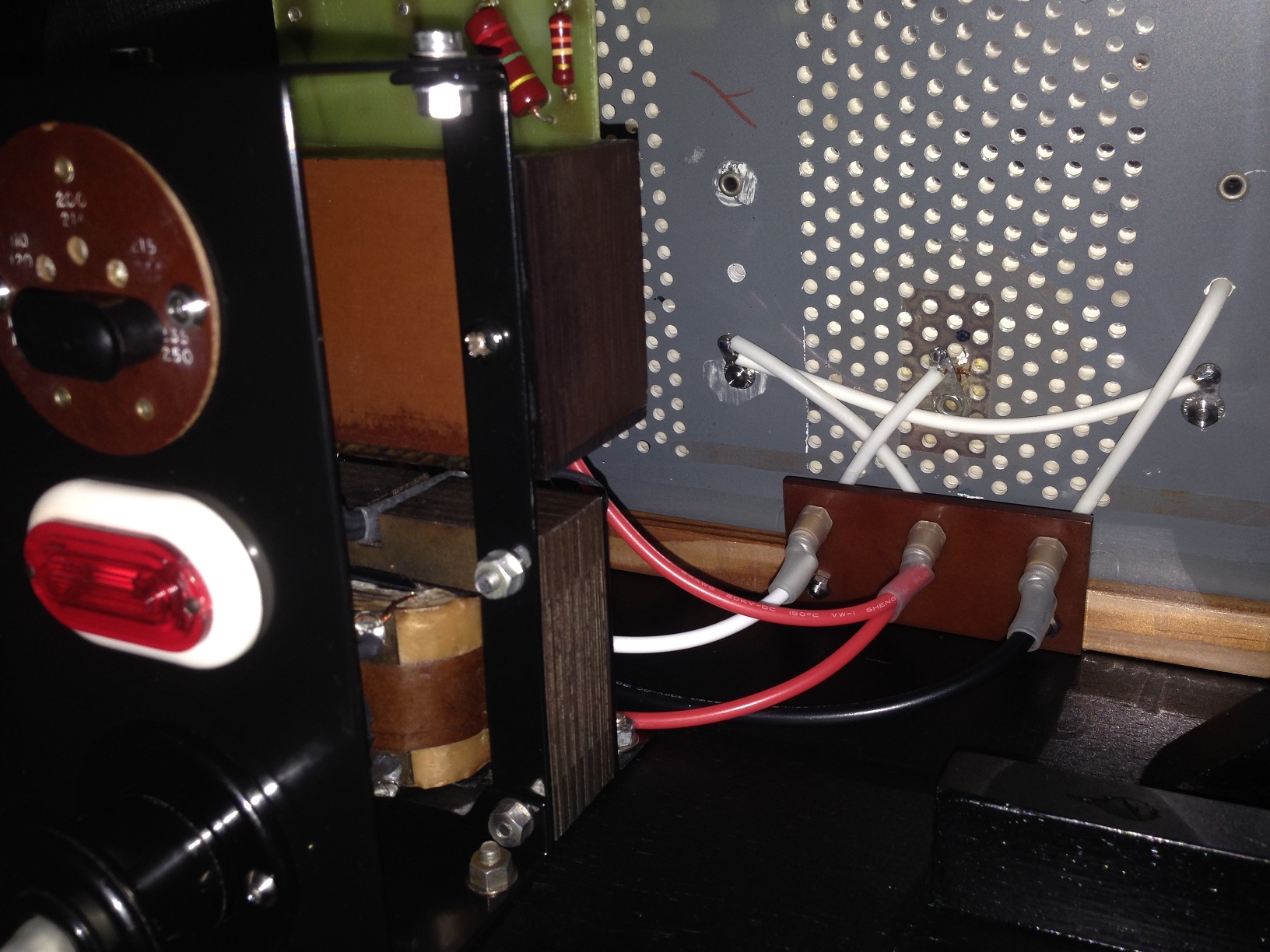

This is the actual unit, carefully insulated, and soldered. The EHT block was completely rebuilt (new Philips diodes, but caps are the factory ceramic ones) and tested with a voltage divider and DVM, so I don't think it's the EHT, but who knows?
I've streched the covers, certainly.
I still assume that it's the bass panels coating, or a leakage somewhere inside the panel. I had a problem with the other unit, the panel was discharging 'loudly' with pops, but I managed to put an end to it by screwing in more the two bolts holding the phenolic terminal board at the bottom.
Oh well, you certainly did everything there is to do, and, sadly, the culprits are the bass panels themselves. You can either attempt to rebuild them (big deal), or buy replacement panels (big €). 🙁

Did you do measurements with the EHT wired to the woofers? What kind of voltage did you get?

No, I haven’t done anything like this yet. I am not sure that this measurement requires an electrostatic voltmeter, or can be done with this voltage multiplier.
Less troublesome is to swap L/R EHT blocks and see if the problem moves too.
I will try this first as soon as I’ll have time
Maybe you need a bigger resistor, like 5 to 10 GOhms. It'll let you see if a panel is shorting/overloading the EHT before you do any swap.

Could you give me instructions how should I determine it with the 5-10 resistor?
First, let's assume your digital multimeter (DVM) has an input impedance of 10 Meg, which is usually the case. Then, let's assume you're buying 2 x 5 Giga resistors like those in a previous reply, and connect them in serie to form a 10G resistor.
The 10G resistors in serie with the 10M of your multimeter forms a voltage divider of about 1000:1, so the nominal 6000V EHT should read 6V on your DVM.

This is a voltage divider essentially, then. This measures the ‘health’ of the EHT unit, but we cannot determine the state of the woofers, can we?
