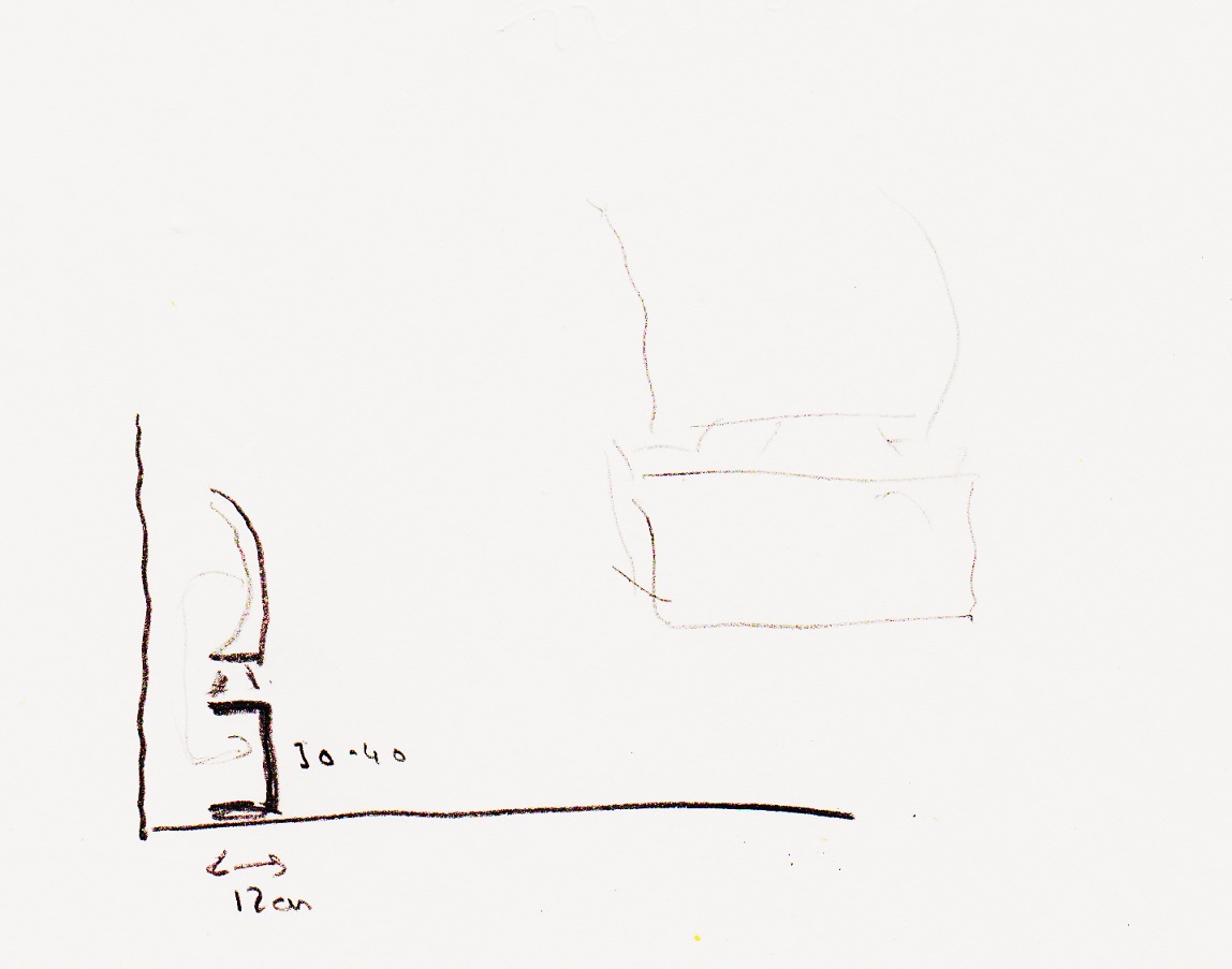

Here's Mr. P. J. Walker's hand drawn "blueprint".
Splendid!
So he want the speaker 30-40 cms of the floor and with a solid "wall". I wonder if that will improve bass? Other that that it seem to be perfect for two 12" or 15" open baffle subs.

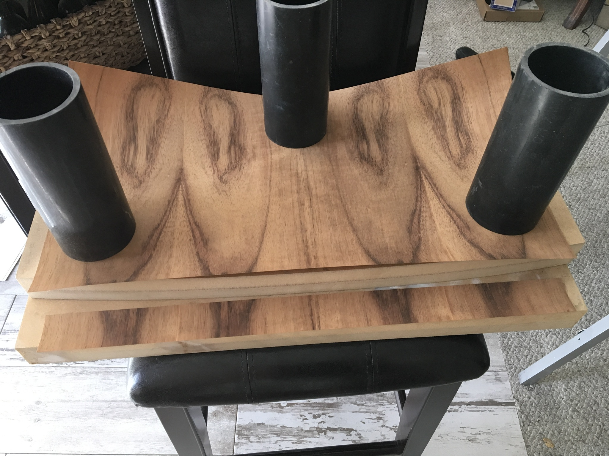

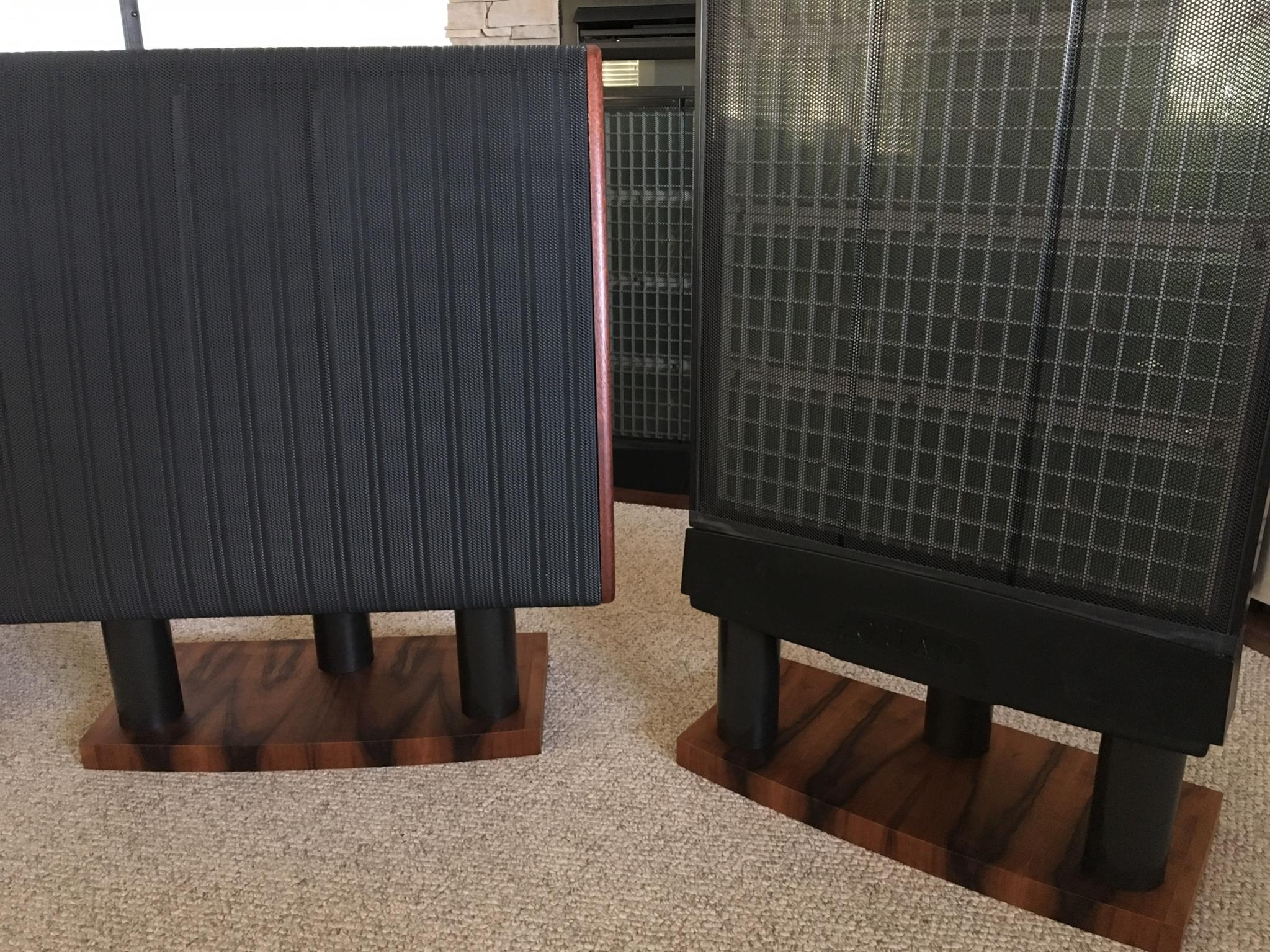

Like most here, you must get the Quads up off the floor if you want them to give their most transparent capability.
I made these to fit over the 988 base without the sheet steel base plate.
I actually use a squeeze clamp in back to secure it tight.
Sand filled tubes.

Great work the flimsy ESL 57 will probably benefit from the extra weight and rigidity.
Thanx
Since I have torn down both models to their bones the 57 actually has better damping in how it’s made overall.
The 988/989 has a very flimsy and resonant aluminum frame with many ways to flex and creak against its connection points
The steel base plate and the small plastic posts of the base are a disaster.
The base volume is a resonant cavity and should be left off or allowed to breath in some way . With every bass note this frame construction leaves me shaking my head
Maybe the reason they put all the panels in rubber mounts to isolate the cheap frame.
Tightly coupling the panels to this frame would excite this mess
The best you could do is replace the “L” channel with a thicker one since the stock one flex’s like crazy
